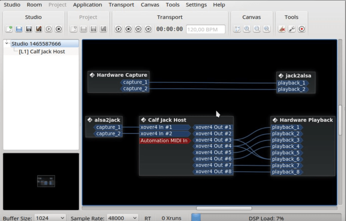

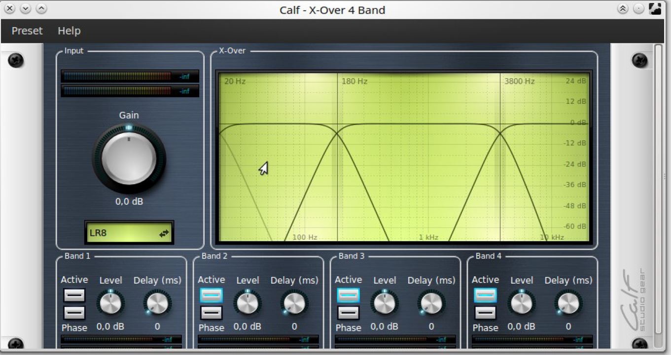

Dear Charlie, yes you are "playing" in the Profileague. When I firstly was searching for a solution of my x-over Problem I found your page. Interesting for me, as only to be an USER, is that I can use the CALF and CADENCE/CLAUDIA GUIS. For me that makes things easier. Thanks and Happy Christmas Heinz Guenter

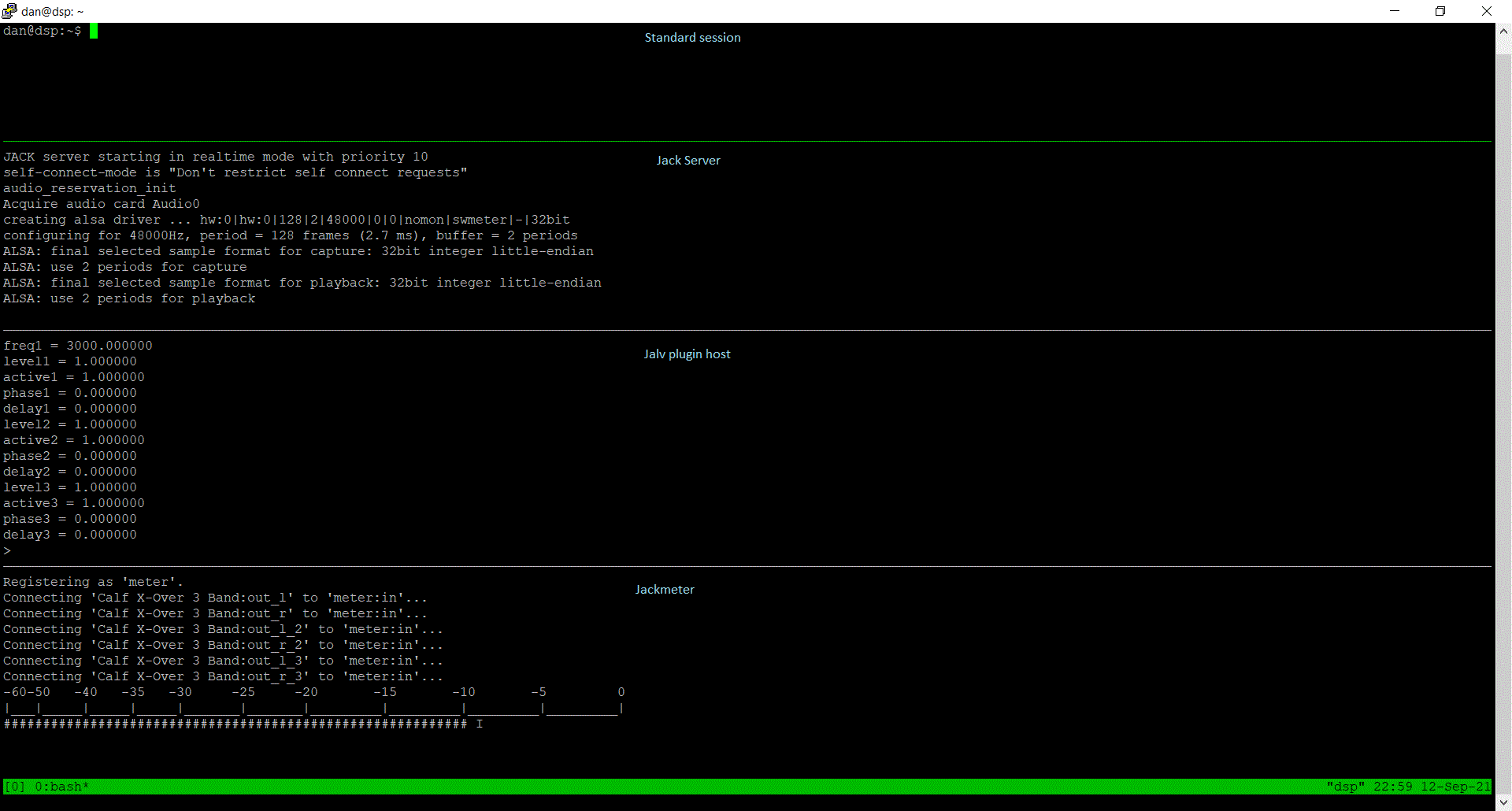

I found this thread a couple of days ago - Loafmeat's post made me wonder if I could put something together that could be used in a headless fashion, so here's what I did:
  1. Found an old computer and install Ubuntu Server 20.04 on it
  2. Install the packages required (Ubuntu Server is very barebones in the audio department 🙂 ):
    Code:
    $ sudo apt install alsa-utils alsa-base jackd2 calf-plugins jalv jackmeter lilv-utils
  3. Modify the details for the sound device, so that all outputs could be used:
    Code:
    $ sudo bash -c 'echo options snd-hda-intel model=6stack-dig >> /etc/modprobe.d/alsa-sound.conf'
    $ sudo alsa force-reload
  4. Create a couple of scripts to set up a tmux session that starts jackd, jalv with the XOver 3 Band plugin, connects the inputs and outputs, and then sets up a simple meter for visual feedback
    Script 1 (to make the connections, called by the main script):
    Code:
    #!/bin/bash
    echo "Connecting inputs to crossover..."
    jack_connect system:capture_1 'Calf X-Over 3 Band:in_l'
    jack_connect system:capture_2 'Calf X-Over 3 Band:in_r'
    echo "Connecting crossover outputs to system outputs..."
    jack_connect 'Calf X-Over 3 Band:out_l' system:playback_1
    jack_connect 'Calf X-Over 3 Band:out_r' system:playback_2
    jack_connect 'Calf X-Over 3 Band:out_l_2' system:playback_3
    jack_connect 'Calf X-Over 3 Band:out_r_2' system:playback_4
    jack_connect 'Calf X-Over 3 Band:out_l_3' system:playback_5
    jack_connect 'Calf X-Over 3 Band:out_r_3' system:playback_6
    Script 2 (to start the metering, called by the main script):
    Code:
    #!/bin/bash
    jack_meter 'Calf X-Over 3 Band:out_l' \
    'Calf X-Over 3 Band:out_r' \
    'Calf X-Over 3 Band:out_l_2' \
    'Calf X-Over 3 Band:out_r_2' \
    'Calf X-Over 3 Band:out_l_3' \
    Finally, script 3 to bring everything together into a tmux session with each process running in its own pane:
    Code:
    #!/bin/bash
    # Start tmux session
    tmux new-session -d 'dsp'
    # Start JACK
    tmux split-window -v 'jackd -S -R -d alsa -p128'
    tmux resize-pane -U 20
    sleep 5
    # Start JALV
    sleep 5
    tmux split-window -v 'jalv [url]http://calf.sourceforge.net/plugins/XOver3Band[/url]'
    tmux resize-pane -U 10
    # Connect ports
    sleep 5
    tmux split-window -h '~/make-jack-connections.sh'
    # Start metering
    sleep 5
    tmux split-window -v '~/start-metering.sh'
Note: I didn't know how to get the plugin URI that jalv requires to pick the right plugin. After a bit of poking around, I found that this was contained within the .ttl files. By running the following:
Code:
cat /usr/lib/lv2/calf.lv2/XOver3Band.ttl
I found the plugin URI at the very top of the file (the first @prefix entry).
I hope people find this of use! This means I only need a SSH session to check on things, and make adjustments (I was banging my head against a brick wall with VNC and DISPLAY :0, and finally gave up).
This would be pretty easy to set up as a systemd service, which I might do in the future - for now I'll need to log in, start tmux and then run the main script every time the server's booted.
If people have suggestions on how to improve the above, and possibly make it look nicer (to each their own 😉 ), please share your thoughts!

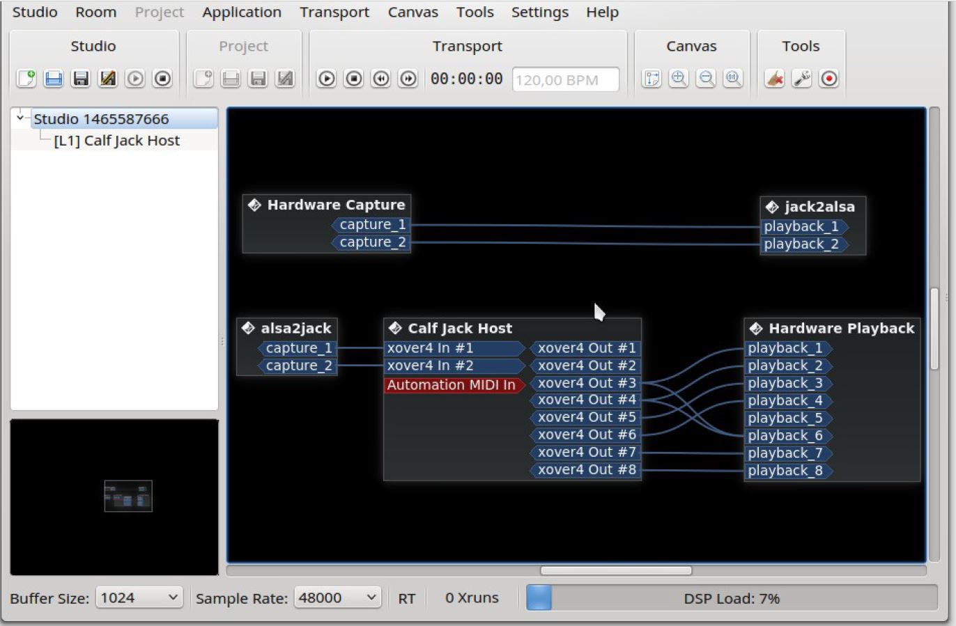

@Loafmeat your post looks very interesting - could you please let me know what software is that on my screenshot and in brief what is your workflow?
