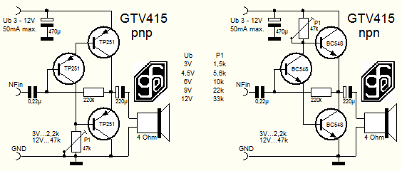

Had built the undermost circuit. Inserted 2 mF at the output and driven any fullrange, > 90 dB;-)))
Gegentaktverstarker

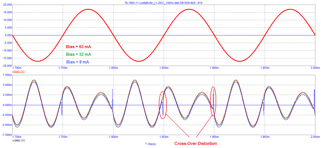

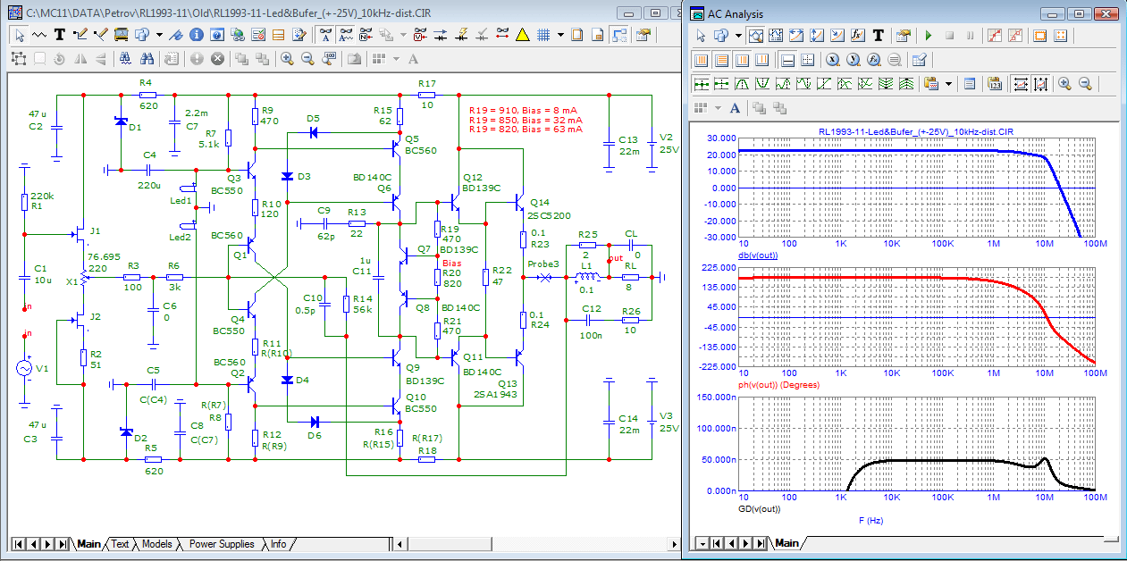

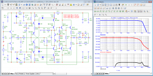

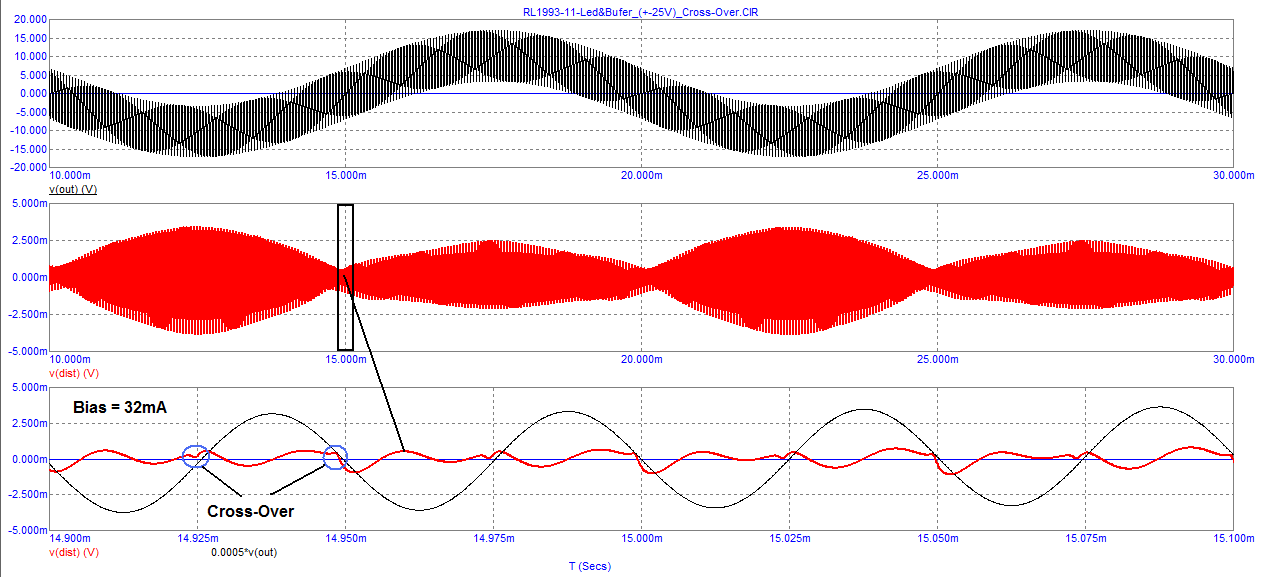

It all depends on the speed of the negative feedback, on the signal delay, in short, on the group delay. If the group delay is less than 100 ns (and preferably less than 50 ns), then Feedback effectively copes with switching distortions and there is no need to use class A. In reality, the vast majority of amplifiers produced by the industry have a group delay from 200 ns (at best) to 2 μs or more .

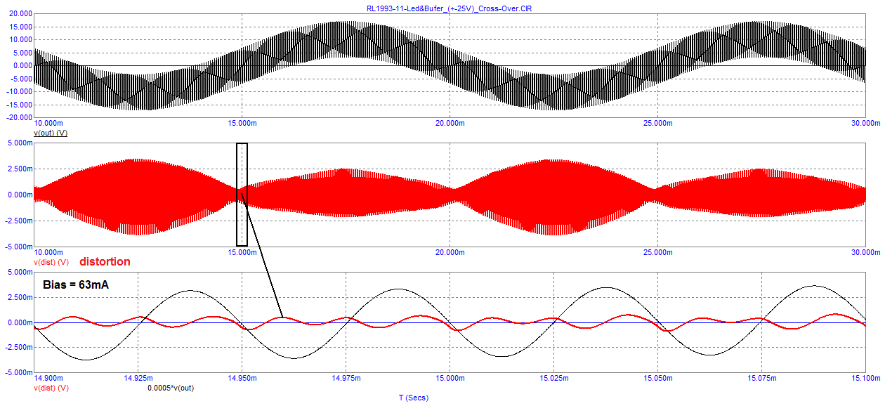

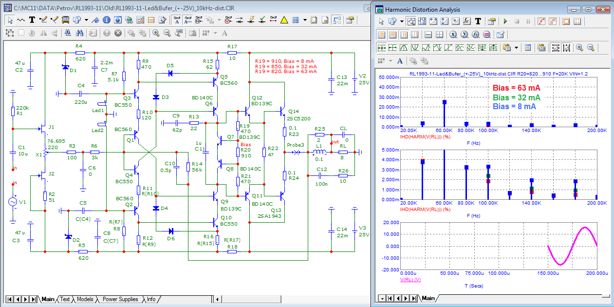

Let's measure the crossover distortion in a near-reality mode. To do this, we mix a 20 kHz signal with a 100 Hz signal in a ratio of 2:3 and measure the distortion products at different quiescent currents: 8, 32 and 63 mA.
