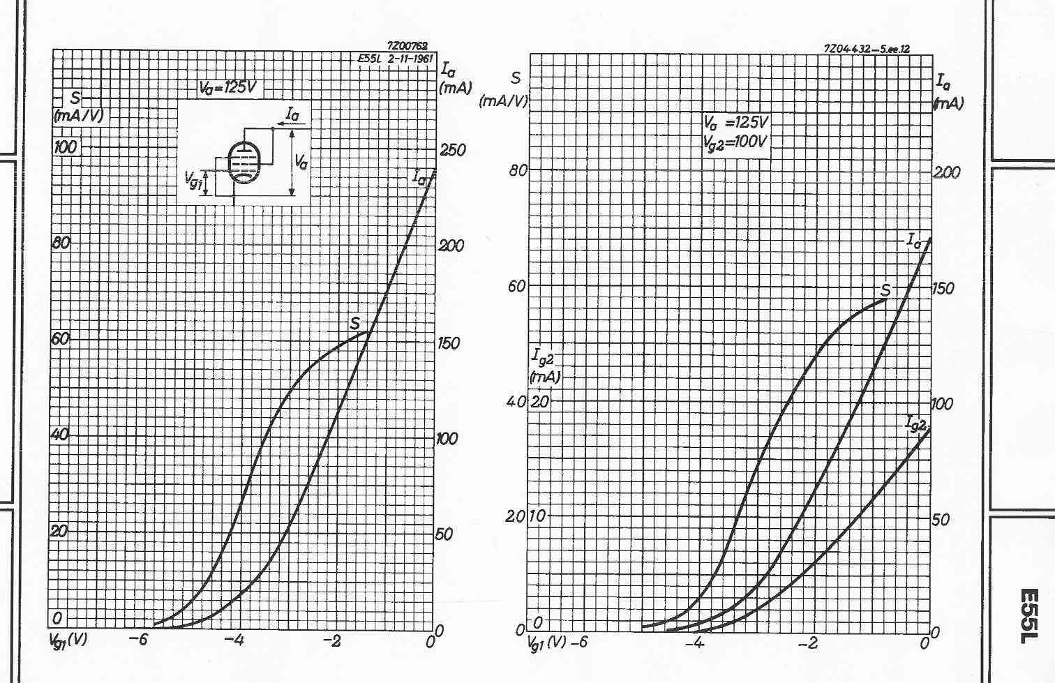

Well, here are some real power tube gm curves (versus grid voltage, Vg):
10/6JA5, page 5 gm curves
http://tubedata.milbert.com/sheets/123/1/10JA5.pdf
6LU8, page 7 gm curves
http://tubedata.milbert.com/sheets/123/6/6LU8.pdf
EL3010, S curve, bottom of page 573
http://tubedata.milbert.com/sheets/128/e/EL3010.pdf
As you can see, these don't generally develop a straight line section (n = 2) in the middle of the gm curve. Have to go to higher current. You certainly won't get any gm doubling in P-P with these at least.

E130L, gm curve versus I or plate current, on page 7, showing the approx. square root function of gm versus current.
http://tubedata.milbert.com/sheets/009/e/E130L.pdf
E55L, gm versus Vg on page 5, AND, gm versus I on page 9 (top)
http://tubedata.milbert.com/sheets/009/e/E55L.pdf
12GN7, gm versus Vg, bottom last page (really high gm frame grid types more likely to run past the cathode emission capabilty at higher current, so gm curve bends over up top)
http://tubedata.milbert.com/sheets/135/1/12GN7A.pdf
