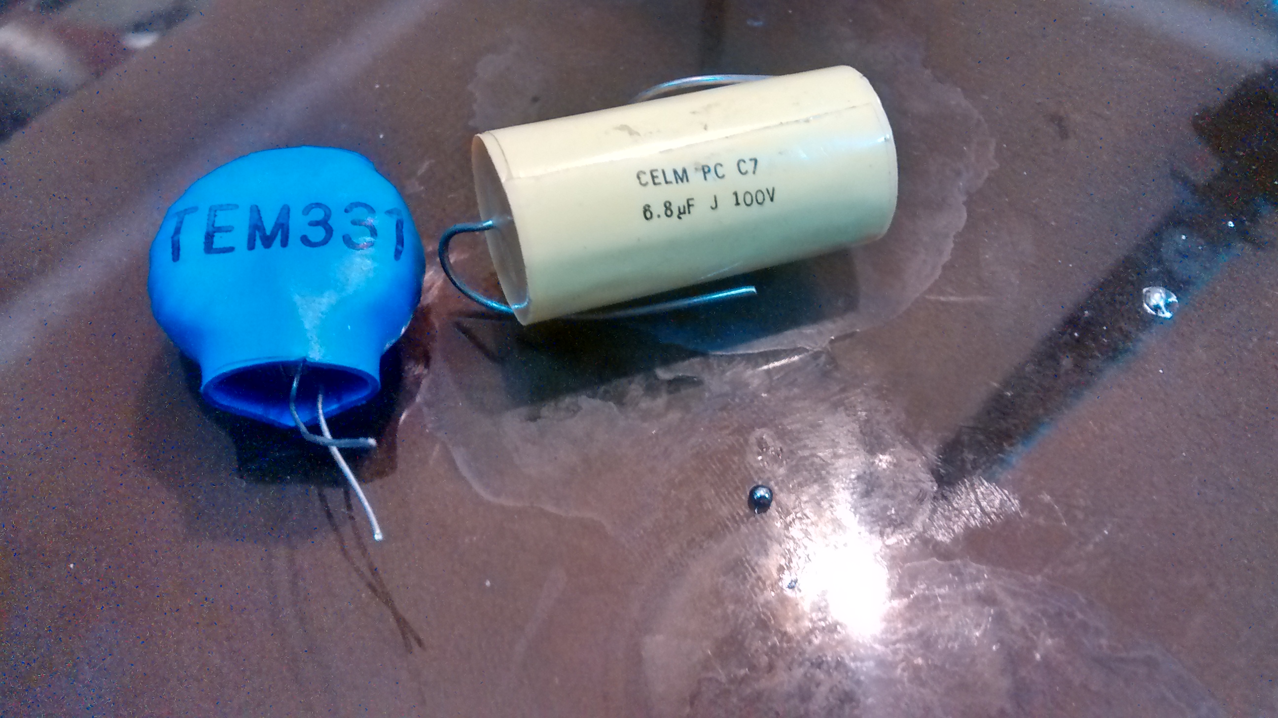

This is a simple first-order crossover. Tweeter high-pass filter is a 4.7 microF / 100V bipolar electrolyte, plus 3R9 ohm/ 5W ceramic resistor, plus PTC resettable fuse for tweeter overcurrent protection, all serially connected with the tweeter. Woofer low-pass filter is a ferrite core coil, unfortunately without printed value on it. Try with 0.47 mH.
I think due to component manual this cross is a 12db/octave for teewter and woofer connect to amplifier directly.
Yes, you are right, I just saw the original user manual
http://www.audio-system.de/dokumente/bda_m-series_komplett.pdf
The crossover indeed is a second order, so woofer is directly connected to amplifier. I was fooled by the red wire beneath crossover board (it is for a resistor bypass, actually). Unfortunately, there is no clear number (value) printed on coil.
9.0 printed value you saw can not be the inductance of the coil (in mH), it must be lower than 1 mH.
