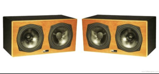

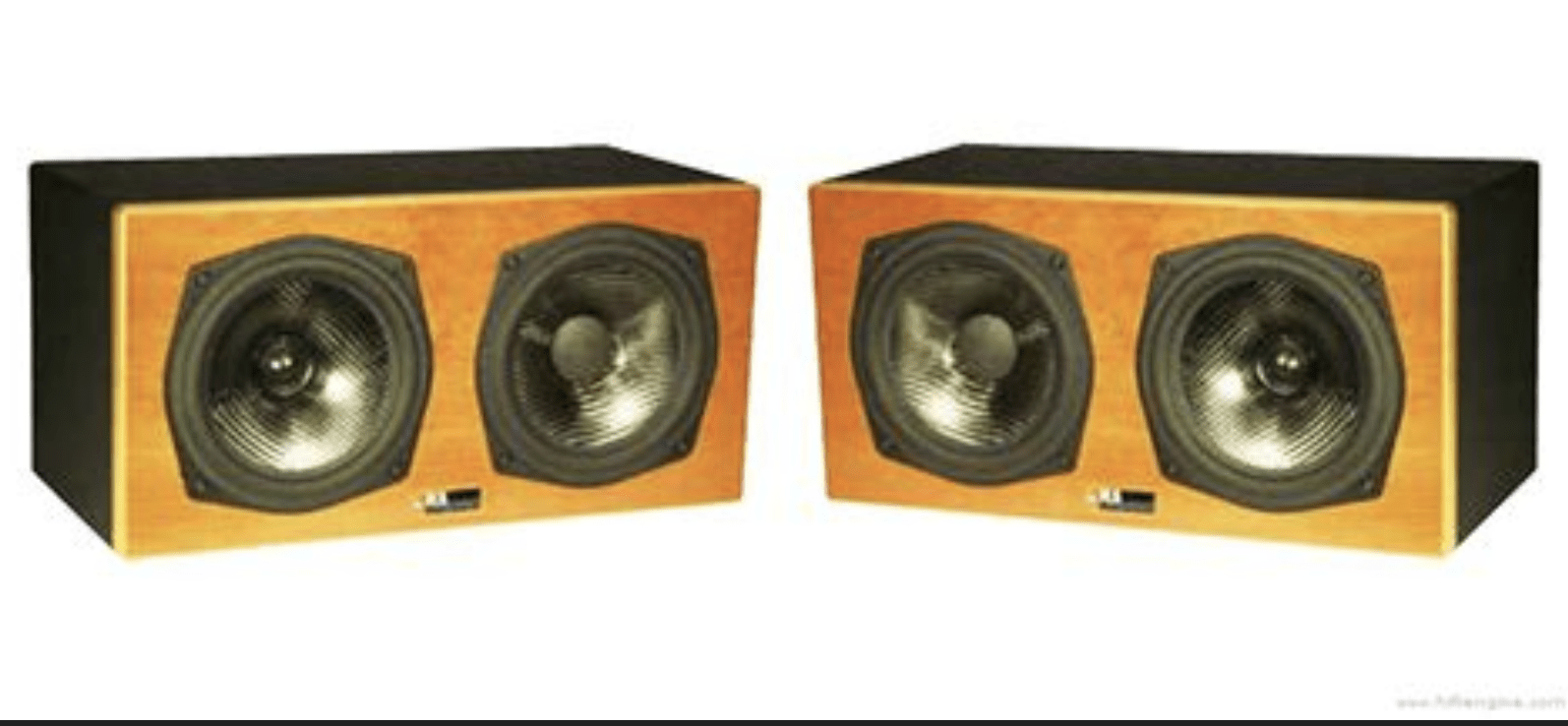

The speakers will be in a Horizontal position (laying on their sides) like the Ks digital C88 etc .

Where it seems a little tricky - to me - is that you plan on putting the speaker sideways - on its side? Not sure directivity will be good like this. Why not build it like the Neumann?
This is an intentional „ignorance is bliss“ choice.
My arguments are
1) i am sitting very near and simply don`t like speakers „towering“ over me.
2) There are designs like the KS and others that seem to work. So if its good enough for them i trust them to be good enough for me.
I am aware that it will have downsides. That said i have also the KH 80 on their sides and even though the waveguide is obviously designed
for Horizontal dispersion , i did A-B testing switching positions and did not find the soundstage suffering too much at these super close distances i am listening at.
