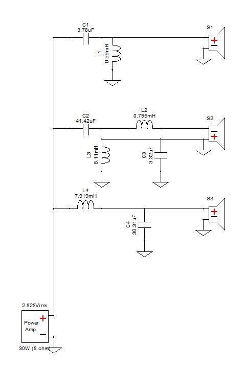

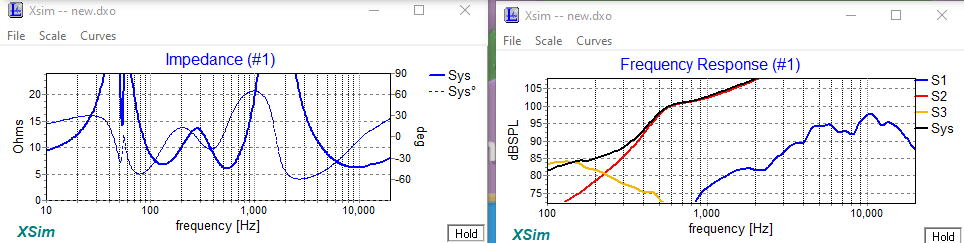

I tried to make something workable here using them. Don't know how to apply bafflestep and diffraction curves.
Got to say -- the tweeter padding is ridiculous - a consequence of using the tiny, insensitive 4.5" woofer.
Overall, I think one's money and time is better spent on a published design 2 way with 5" or 6" woofer.
The design goal of a 3 way with 4.5" bass + 4.5" mid + >1" tweeter doesn't make much sense to me.

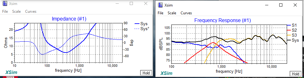

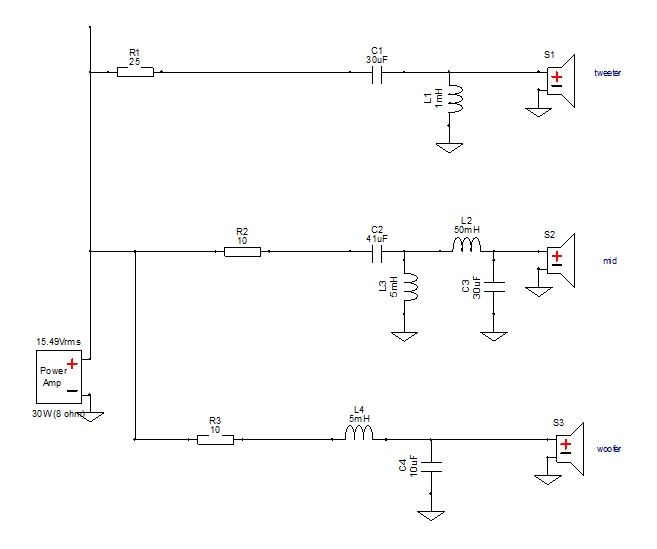

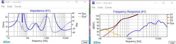

hello everyone i started on xsim a few days ago i want to make a 3 way crossover but because i have professional components, the frd and zma files weren't available i have the sica 10fe 3 cp 8Ω woofer the sica 8m 1,5cs mid and the visaton sc 10 n tweeter i'll send the pdfs too.Now i got the curves from graph tracer and edited them, with paint 3d i erased everything except the frequency and impedance charts everything works in xsim, i noticed tho that the curves of the drivers, are not aligned with the x and y axes of xsim based on the factory pdf. Is it possible to adjust the axes of xsim so that the curves appear as they do in the factory pdf?? and if so how? As you guys can see for yourself in the crossover photo i sent the frequency of each driver if you compare them to the factory pdfs does not align they start at more hz and more dbs i would really appreciate an answer cause i cannot align them.
