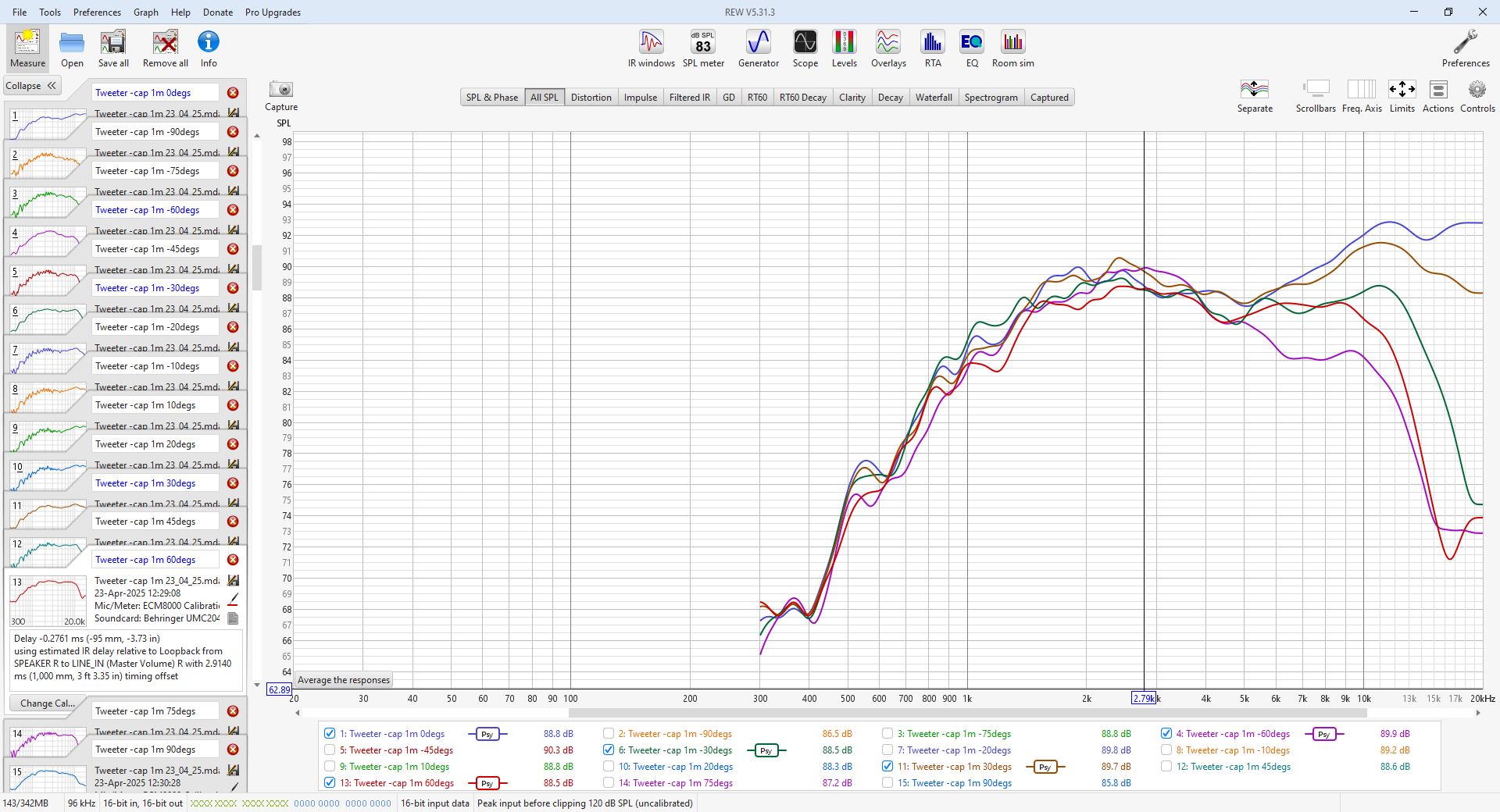

I took measurement from -90 to +90 degs for each of the drivers without moving the mic (note the Tweeter and Mid are both domes and so have protection capacitors, measurements taken with and with out these in place). I took nearfield for the woofer 1cm from the centre dust cap (sealed enclosure) and then impedance of each of the drivers in the box (with and without protection caps just for interest).

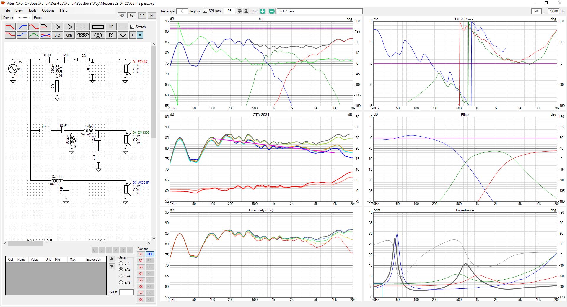

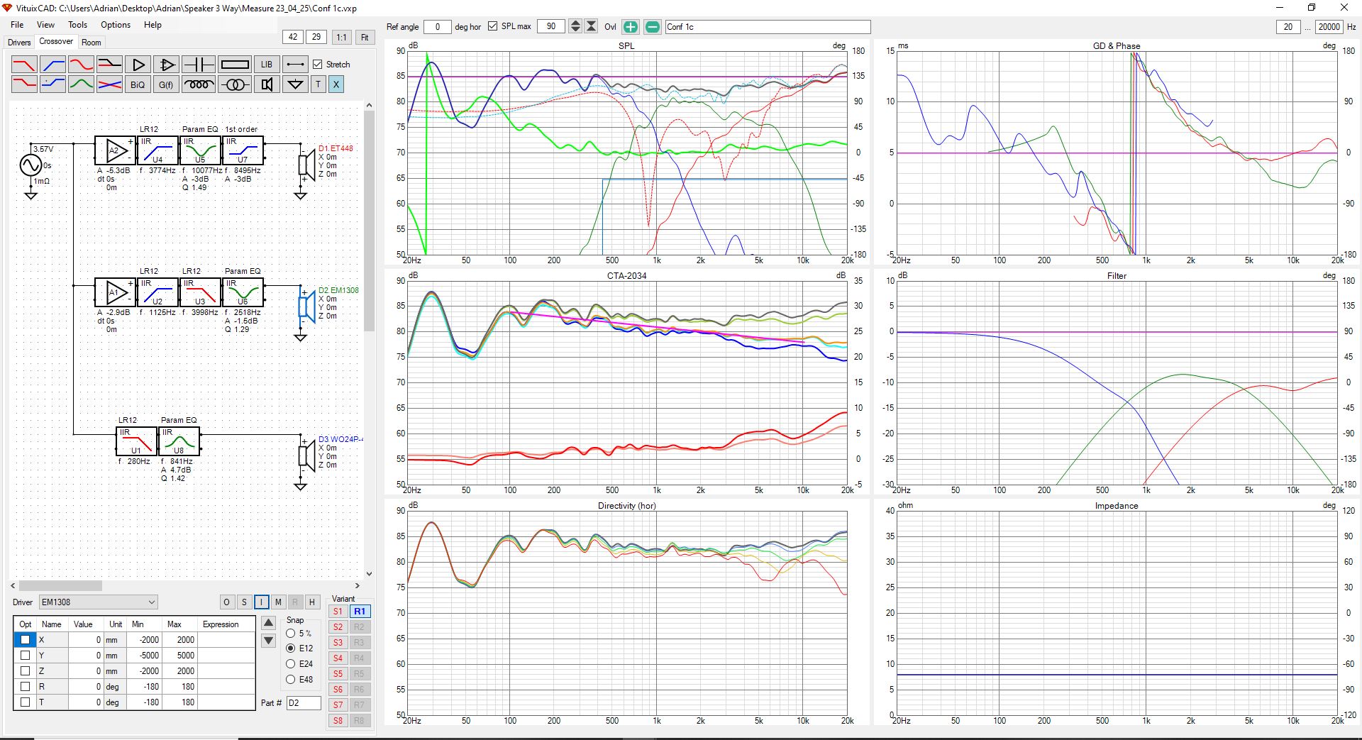

I then loaded up the +cap tweeter/mid and woofer measurements into VituixCad and played around with a few different designs with different slopes for an active crossover, these ranged from BW6 to LR24 in various combinations. The aim was to get a fairly flat on axis frequency response, align phase of each driver as close as I could (min 1 octave either side of the crossover point) and then have an in-room response that tried to follow a slope of 0.9dB/octave (or 6dB form 100hz to 10khz). Note, I did not merge the nearfield so it has room bass reflections under around 300hz.

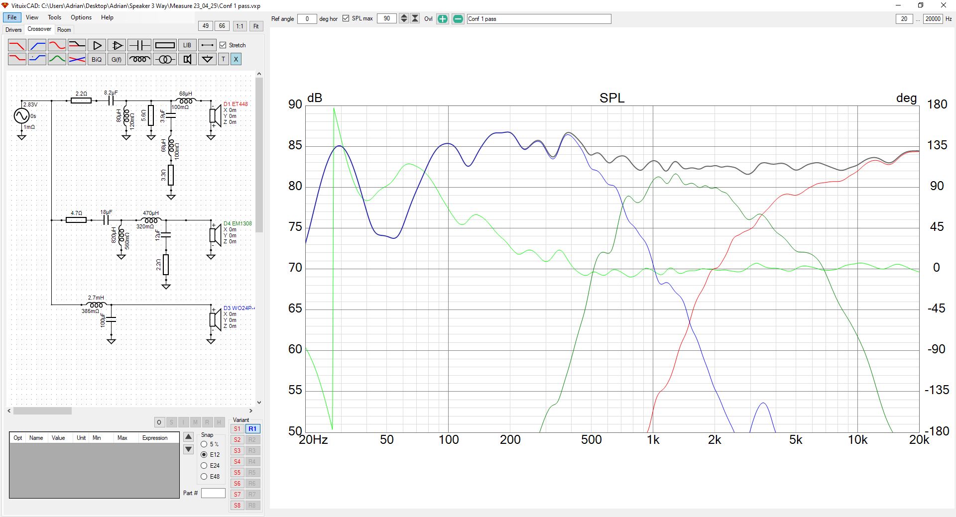

Without documenting all of the various trials and errors, I settled on the following scheme that seems to meet most of the requirements quite well. To me this sounded the best subjectively, it has a fairly large soundstage with decent separation between the instruments and has a natural and lifelike presentation. I could stand the vocals being a little more forward but this is the only minor criticism. Bass is plentiful in my 10ft x 10ft x 8.5ft [ceiling] room with the speakers pushed a little into the corners.

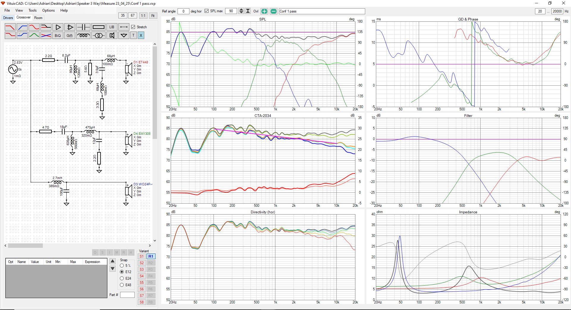

So, having got a sound I liked I then tried to replicate this with a passive crossover (using the -cap measurements and measured impedances)........and this is what I came up with.
This is basically a simple LR12 electrical topology which ends up being an acoustic LR24 on the woofer/mid crossover and LR12 on the Mid/Tweeter. There is a damping resistor on the mid with a shaping resistor in the low pass parallel leg. There is an L-pad on the tweeter. The resulting impedence curve looks manageable for most modern amps with a low of 3.2ohms at 110hz but is definitely a 4ohm design.

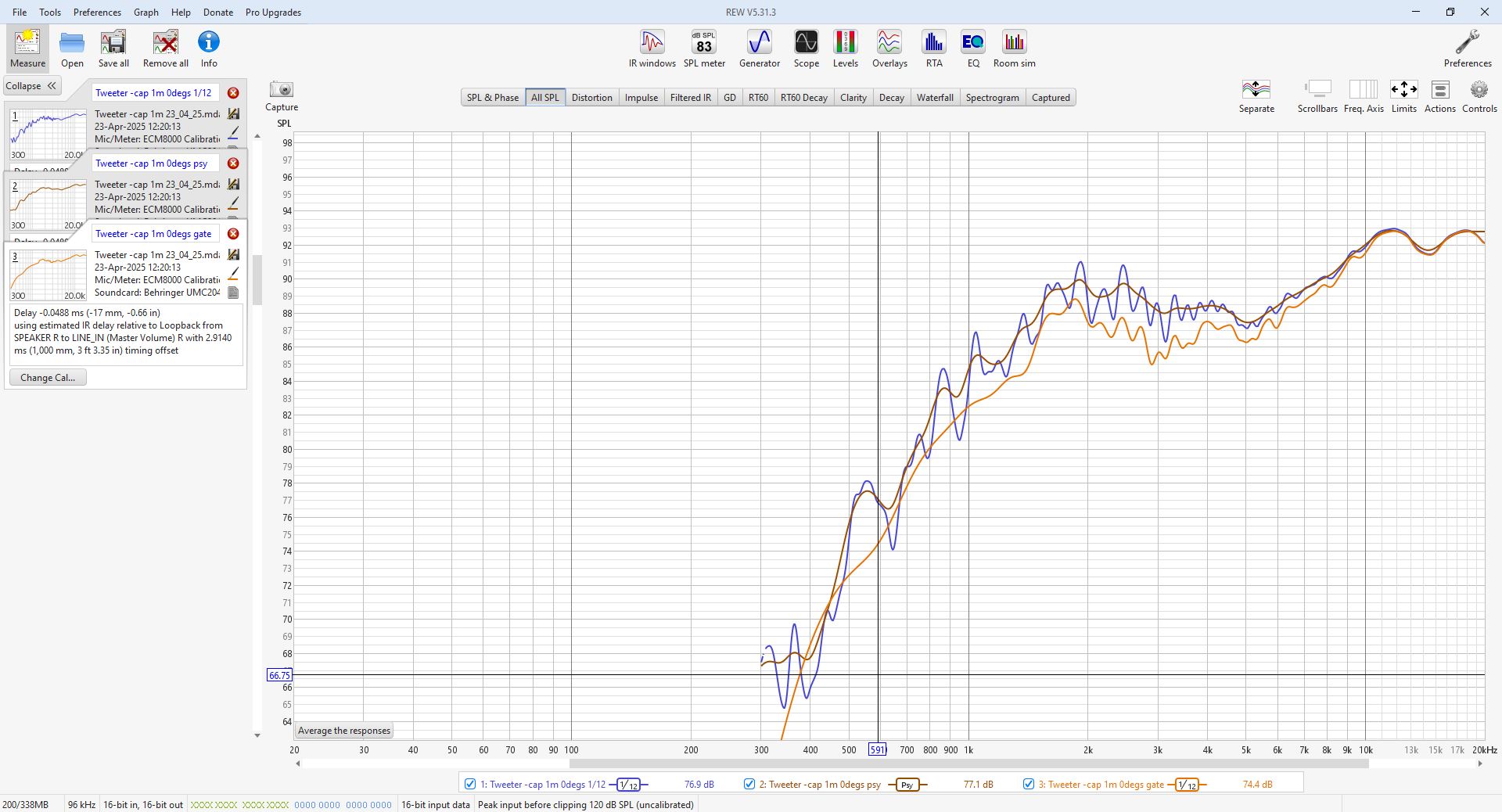

Now the bit where I would like a bit of critique of what I have done to tame the rising frequency response of the tweeter that is seen in many Morel units. I added a small inductor in series to tip over the curve at around 8Khz and then added a notch at around 10khz. This seems to flatten things off nicely but is having and inductor in series in a tweeter circuit a good idea and will it affect the sound negatively?
In general think the p[assive version matches the design aims and the active system fairly well.

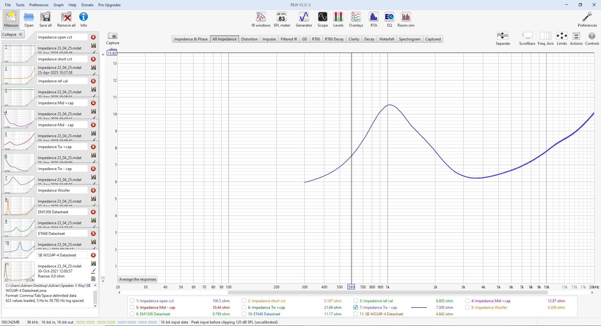

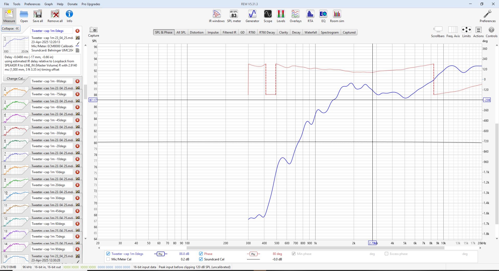

@temp25 Tweeter FRD/ZMA attached below (taken without protection capacitor). These were taken at 1m from the baffle at the centre line and tweeter height. This is for on-axis (0degs) and impedance taken in box (not that that makes much difference for a tweeter). No gating but psychoacoustic smoothing applied in REW.
I have also added pictures of the tweeter FRD and ZMA in REW plus at 0,30 and 60 degs off axis (note - tweeter is not central to the baffle therefore + and - provided) and also a blown up version of the crossover response for reference.

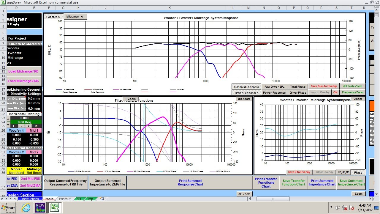

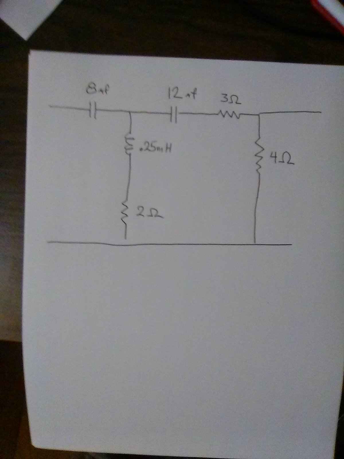

I couldn't get the files to work, but what I did was look at the filter transfer functions. I think I see what you want, but I'm not sure. Anyway, this filter topology might get close with some adjustments. The big thing is the padding is near the tweeter. This makes the crossover see a flat impedance.
@temp25 Thanks for the pointer. I plugged in your tweeter scheme and it was pretty close.
I then tweaked a bit to get the in in-room closer to the target and also to align the phase a little, looks much simpler. The tweeter impedance dips down to 3.0ohms but that should be manageable with a good class D amp. Thanks.

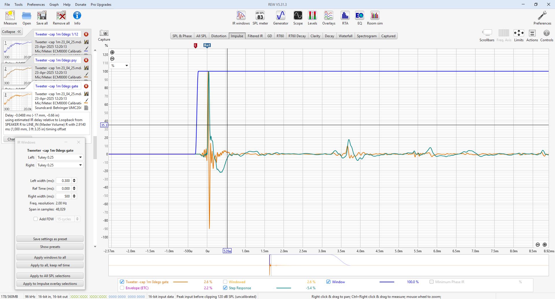

In terms of gating I did look at applying this in REW post measurement and it does to seem to make a huge difference. Below is the impluse without and with gate at 4ms (1st big reflection) and then a comparison of ungated 1/12 smoothing, ungated psychoacoustic smoothing (one I am using) and gated 4ms 1/12 smoothing.

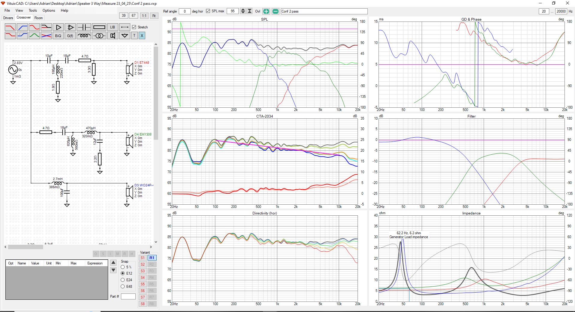

Try this. Instead of 4 ohms, and 3 ohms, try 8 ohms, and 3 ohms. Replace the 4 ohm with an 8 ohm. Then add a 2 ohm in front of the x-over. As long as there's some resistor across the tweeter, it will make the filter easier. (sometimes).
The 2 ohm I showed can be adjusted to change the shape of the roll-off, as can the cap values.
I tried adding the resistor before the xover and upping the parallel resistor but this introduced a bit of a dip around 6khz for some reason.
A little more tweaking with the values in the mid crossover to add a little to the tweeter impedance (now at 3.1ohms with woofer at 3.2ohm minimum).

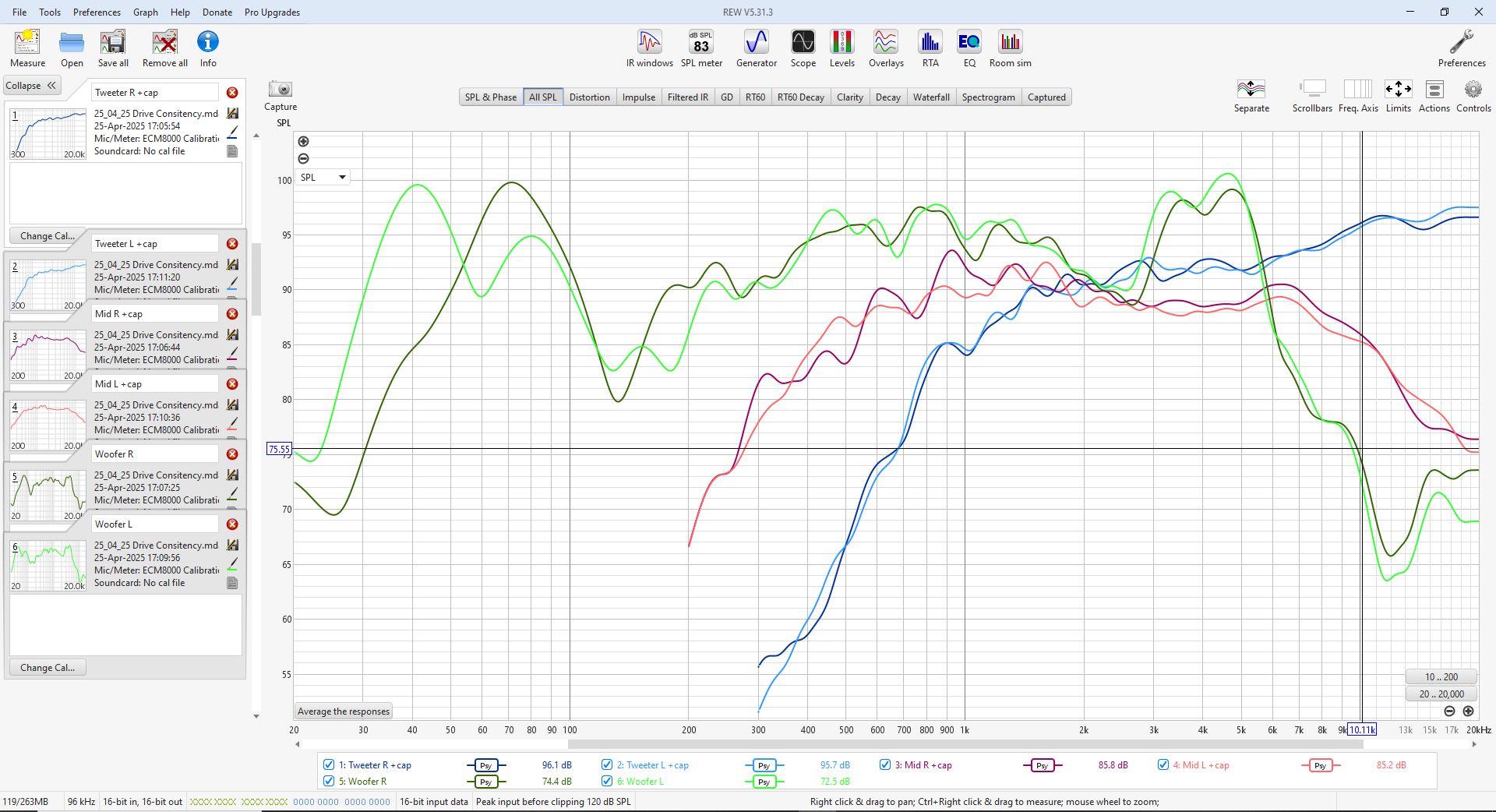

Just a quick sanity check, rough and ready measurements in my study (10x10ft 8.5ft ceiling, quite cluttered, not ideal.
Comparison of left and right drivers, confirms nothing is funky about the tweeter and it does indeed rise above about 8khz (as opposed to the Morel graphs).

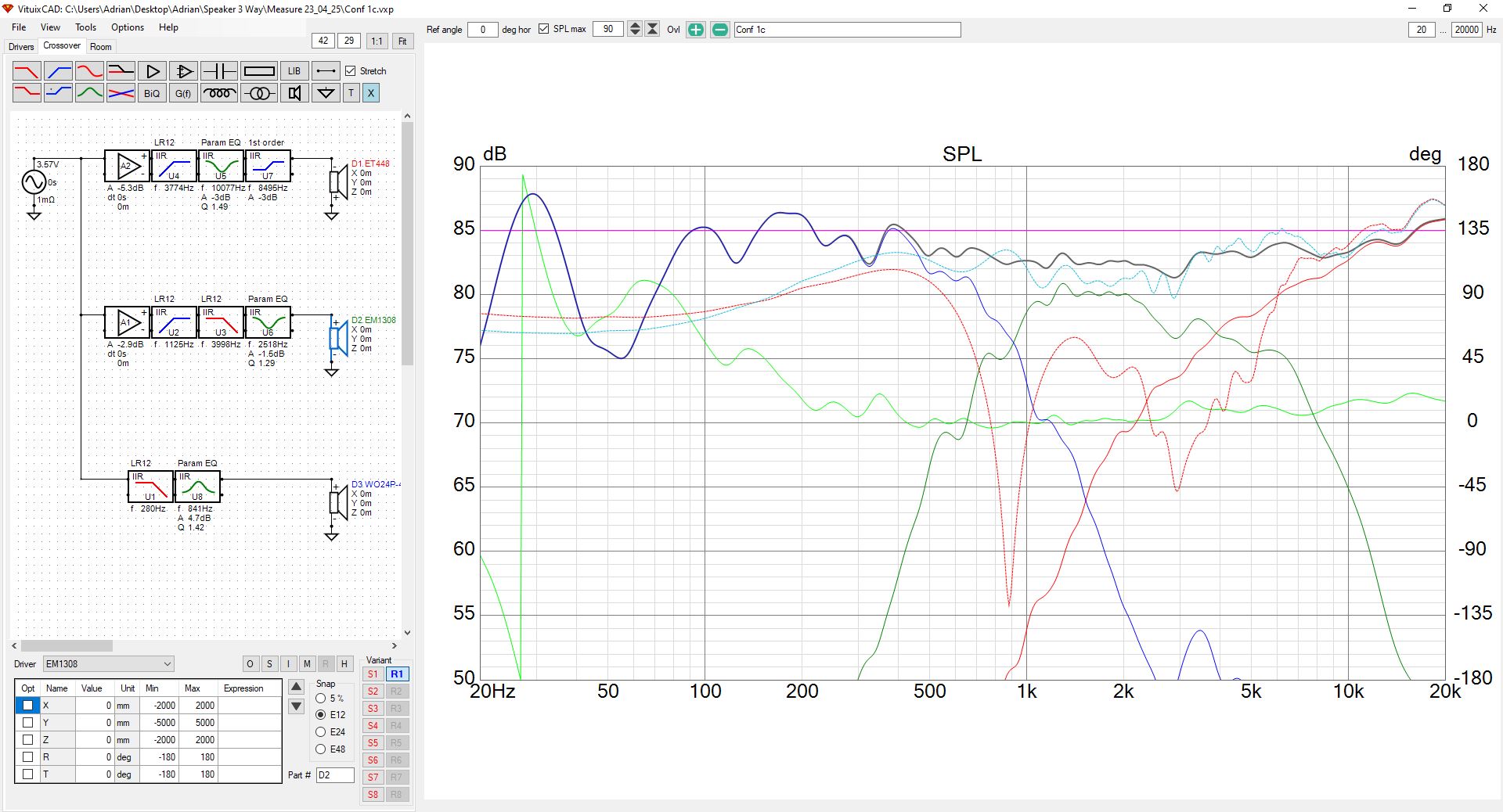

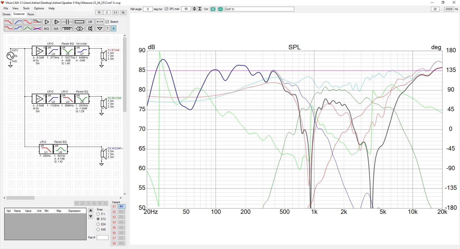

Also played around with the active crossover and this looks reasonable.

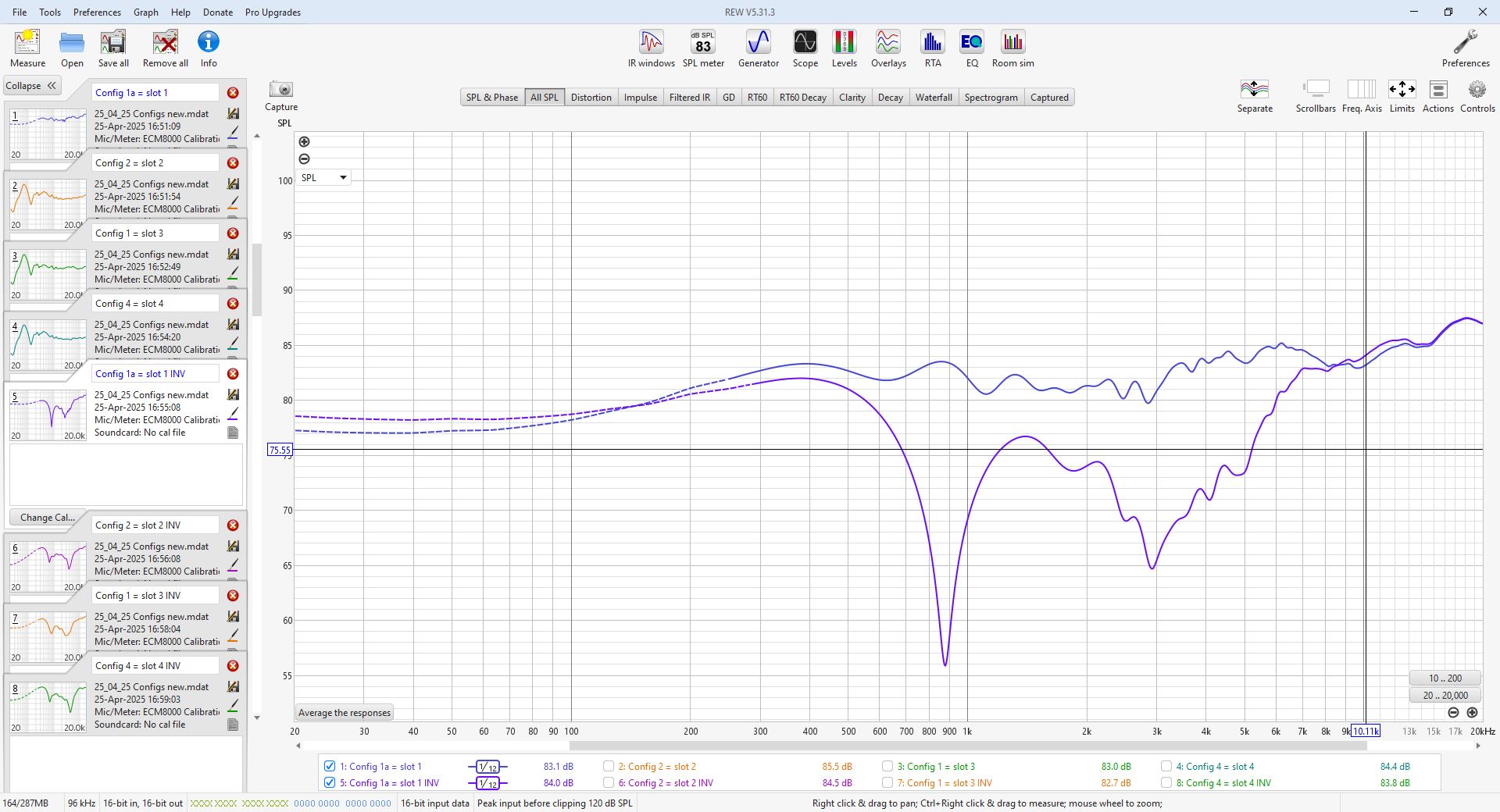

So plugged this into the minidsp and ran a sweep on axis at 1m plus a sweep with the mid inverted and added a 4ms gate. I saved the frequency traces and imported them into VituixCad as overlays. Bass null look pretty much spot on, mid null look a little out but still pretty deep. I'll have a listen to this over the next week or so along with some others and see what my brain likes.
gated Config 1c +INV.JPGConfig 1c compare to measure.JPGConfig 1c compare to measure INV.JPG
If you want me to continue, post a zma for each driver. I can't get the REW exports to work for the impedance. I'm probably doing something wrong. I did get the sweeps turned into frd files. I made a x-over sim, but used incorrect impedance files.
Did you want the top end so bright?
To me, more forward is more SPL at around 1k.
@temp25 I really appreciate your help and the time you are spending on this, many thanks.
I have added the separate zma's (.txt files so may need renaming), otherwise I have used the " File > Export > Export Measurement as text " function which seems to give a frequency/impedance/phase zma output.
In terms of brightness, I don't find it too bright in my room which seems to be born out by the "in room" simulation (orange curve, middle left pane) but the on axis looks like it has quite a bit above 8khz but this is tamed in-room. Agreed, adding a bit around the 1khz will bring out the vocals.
I probably ought to have said that I mainly listen to prog metal, prog rock and some other forms of metal (Ambient, Doom, Metalcore, Djent, Thall etc. and post rock/metal). So, some of these recordings are pretty dense but some are very well recorded contrary to popular belief (The Steven Wilson engineered Opeth albums are excellent, try Damnation). But in general these tend to need fast/dynamic bass for the kick drums but also a bit of a boost up top to bring out the cymbals, vocals are often back a bit in the mix as well as they are more seen as another instrument in metal rather than the star of the show (e.g. Tool). Anyway, this may help understand why I like the sounds I do.
I have a three of four crossovers with different attributes that i will be listening to over the next couple of days (active models) to see if I can pinpoint where I need to add/remove.

Your model looks good on axis, nice an flat, I see you added notches in the bass and mid and then brought down the last octave. What slopes are you using for the low/high pass. You also settled on similar crossover points as I did, around 800hz and 3.5khz. Based on the distortion plats the mid should not be used below about 700hz and the tweeter below about 2khz and conversely the woofer is Ok up to about 1khz which is about an octave below where it starts to beam badly and two octaves below the start of the break up at around 4-5khz. So there are fairly obvious crossover points for these drivers.
