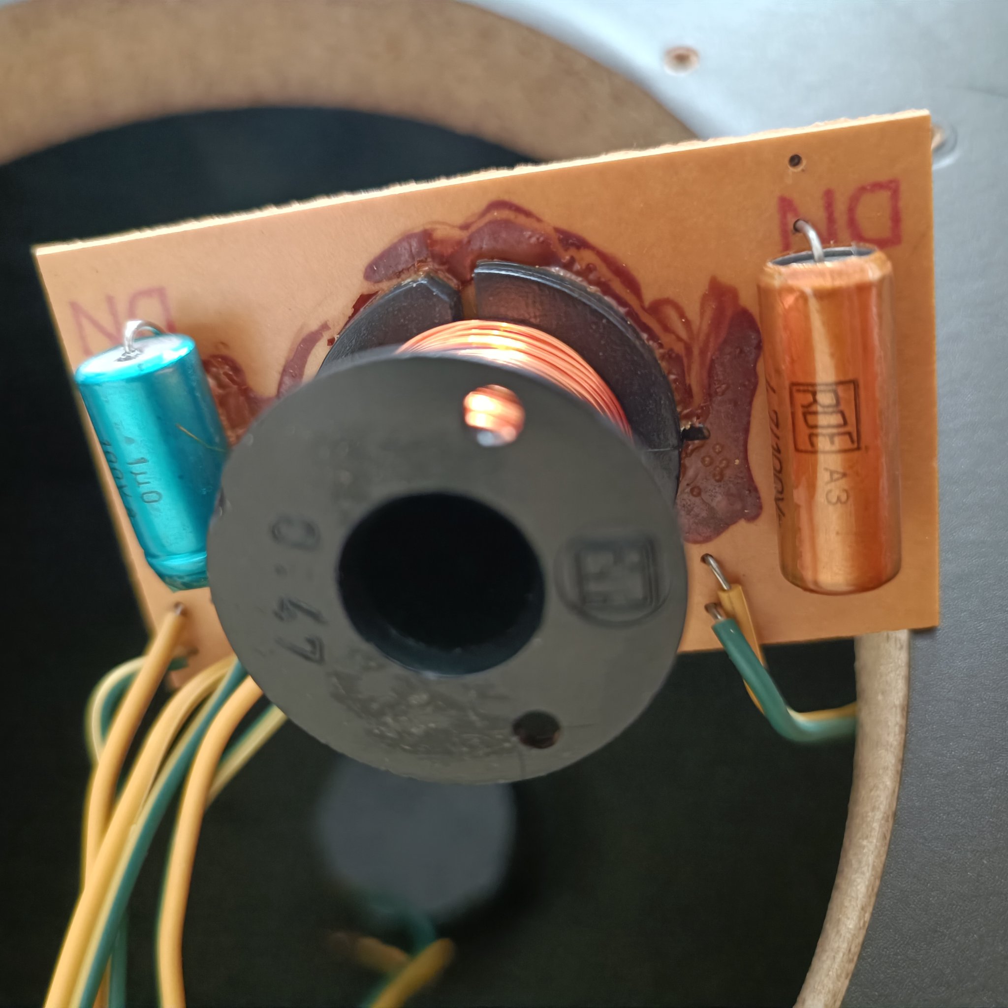

I have a Philips FB297 model 3-way speaker. I wanted to change the electronic capacitors in the crossover circuit, but the capacitor shown in the picture (blue) which I thought was 1uf showed 4.5uf in the measurement. I was surprised. Old blue capacitor with 1u0 written on it. What could be the real value of this capacitor?
Sorry for my English. Thanks for any help.

Yes- as Galu says- they have an aluminum electrolyte paste inside between the foil plates that can dry out, and the plates are closer together, and the capacitance value increases. Replace both capacitors- it look like the other one is a 4.7uF? Either pick a bipolar electrolytic that is a higher voltage if you can find it, or if you have a little money you can replace these with the correct value film crossover caps that will work a bit better and pretty much never deteriorate again.

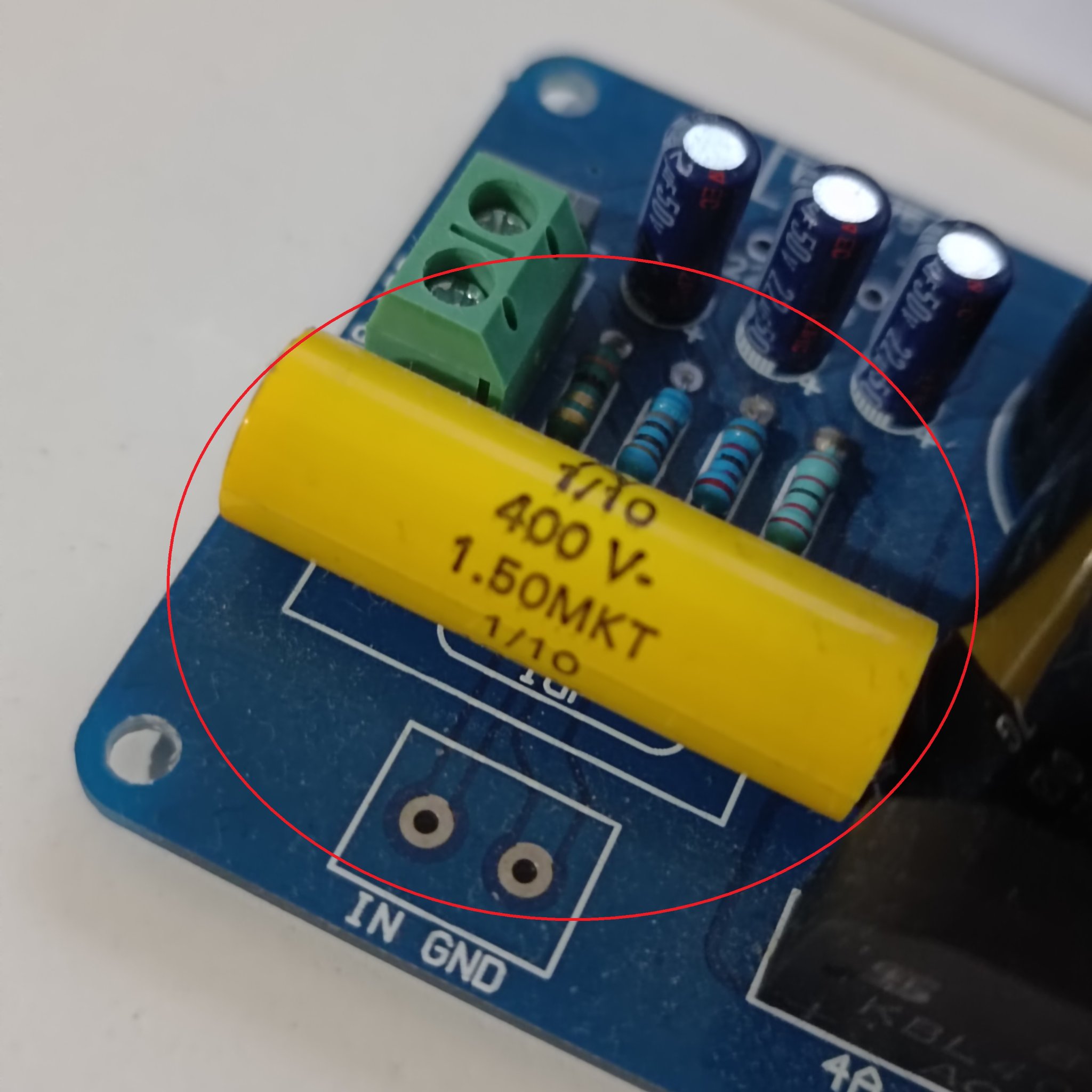

Thank you for your valuable answers. I will probably use a polyester capacitor (yellow) like the one in the picture. If you think it will make a significant difference in sound quality, I can find a polypropylene one or if you have a better recommendation. The gold colored one is 4.7uf but when I measure it, it shows 5.6uf. Yes, a change is necessary.

I agree with using a polyester capacitor.
A polyester (mylar) film capacitor is better than an electrolytic capacitor, i.e., longer lasting, more stable value over time, self-healing characteristics (metalized polyester), lower dialectric absorption (DA), lower equivalent series resistance (ESR), etc. But, I doubt you would hear the difference between the two types of capacitors in a blind comparison, assuming they are the same value. Some people claim they can, but audibly the differences are very subtle.
Polypropylene is even better than polyester, but the differences between polypropylene and polyester are even smaller than the differences between polyester and electrolytic.
The electrolyte paste forms the negative plate of a wet electrolytic capacitor, while the aluminium oxide film on the positive foil is the dielectric.
It's interesting to examine the mechanisms that cause wet electrolytic capacitors to change value over time. Here's what I came up with:
If the electrolyte stays wet, but no voltage is applied for a long time - the caustic electrolyte etches into the oxide dielectric layer, the negative and positive plates effectively come closer together and the capacitance increases.
If the electrolyte dries out - the negative and positive plates effectively become further apart and the capacitance decreases.

It may seem strange that many OLD electrolytics actually measure higher in value, but their Q and ESR are actually poor.

Bipolar electrolytic capacitors like this one can increase in value as they age over time.
The correct value of the capacitor is 1.0 uF. Be sure to replace with a bipolar (non-polarised) type suitable for a loudspeaker crossover.
1uF is small enough that you could replace it with a non-electrolytic cap, such as a Mylar or polypropylene type of cap, which have no polarization at all. A 50V or more voltage rating would be adequate.
