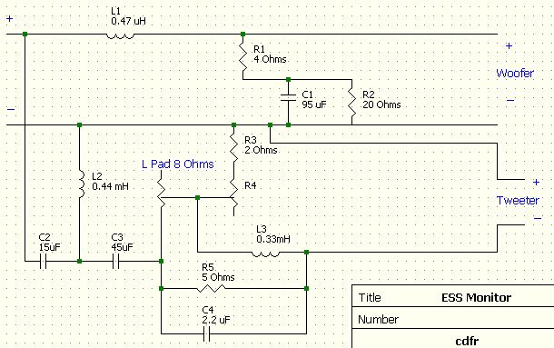

I have some difficulties in figuring out how to calculate the frequency cut off and the attenuation of the two cross over attached.
Those are from ESS AMT Monitors.
The figure 1 (filter 1) is copied from an ESS schematic.

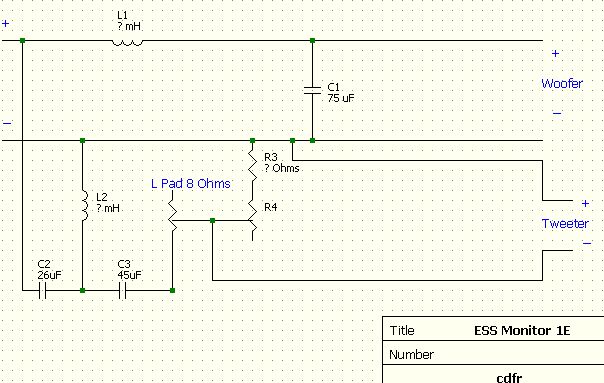

The figure 2 (filter 2) is what I drew from my ESS AMT 1E monitor from 1994. I do not have a the values for the inductances L1 & L2.
In both cases I believe that the crossover frequency is ~1000Hz
Currently I use the figure 2 filter on my AMT 1E on which I have added 1 Heil (so I have two Heil per speaker in parallel). To compensate for the impedance change, I added in series one resistor of 1.8 Ohms. Each Heil being ~3.5 Ohms, I end up with 1.8 + 3.5/2 = ~ 3.6 Ohms. It sounds good that way.
Now I am using that same filter figure 2 on a planar speaker I am building with the Heils being the treble. Same conditions the filter works well.
However I am not sure of what I am doing (as you can notice 😱), The two Heils present together with the resistor present an impedance of 3.6 Ohms to the filter (Not sure what I do is correct or the best solution) and my flat pannel present an impedance of 7.3 Ohms. In both cases the impedance is resistive only.
I would like to modify filter 2, to have the crossover frequency at 2400 Hz. This is why I am asking for help in how to make the calculations.
In a second pass I would like to try filter 1 on the 2 Heil set up &flat pannel and cross over at 2400Hz. Same issue what re the formulas to use to calculate the filter,
Any help that can point me in the right direction is welcomed.

Hi Baddow, I did not make much progress there. I am working blind using a spice freeware and fidling with values, but not making real calculations.

I am using 5Spice (5Spice circuit analysis and simulation software homepage - download your free copy now).
Baddow, you can always use attenuation to match the efficiency of your LF drivers.
I think that the best configuration would be to have a LF driver (or 2) and a Medium going up to 1500Hz. I found that the Heil does not sound so good between 1000 & 1500Hz.
