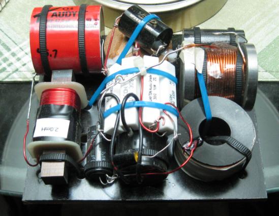

I am working on my first crossover network from scratch, probably a 2nd order 2-way. My questions are twofold:
1) Is there any difference in performance if I build them with point to point on a perf board vs using a stock foil board with the large pads/grounds?
2) Most of the stock foil boards are only for the basic 4 components plus maybe a fuse. What do you guys do for L pad resistors, Zobel, BSC etc? Is everything on the same board or is there a second board?
Thanks,
George
Everything is on the same board for me, unless a single board will not fit. I use p-to-p wiring and try to use as few jumpers as possible, so layout is important.
Keep coils at orthogonal positions to each other if closely placed. Try to keep coils away from other metals in the box, as this will affect value, this includes driver magnets. Use Brass/Nylon mounting screws if screwing them down.
Try to keep breathing room around resistors in case they get hot, and use 10-15W minimum value.
I prefer pegboard and zip-ties, and maybe some glue if required. My glue of choice is E6000, and I use any old 80# tensile strength ties unless using small ones for resistors.
I've attached one of many examples.
Hope this helps,
Wolf
