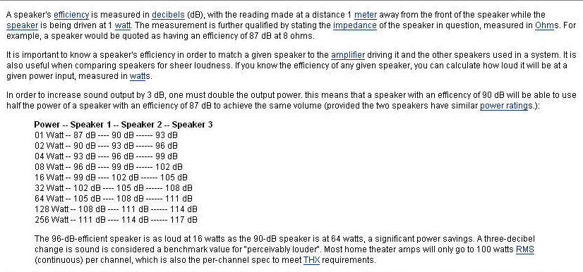

nunayafb said:
((Acoustic power)/(Electrical input power))*100 = Efficiency
Most drivers are about 0.1-0.5% efficient
Hi,Thawach said:[B
About the efficiency and sensitivity I'm not agree.I think that the sensitivity be the same. The loud is higher that's not
the sensitivity.The sensitivity of driver is only measure it at
the 2.83 v/1w/8ohm. When the woofers in parallel(4ohm) are not the sensitivity.+6 db=the efficiency. [/B]
efficiency is usually quoted as a percentage being shorthand for a proportion less than 1.
Sensitivity is usually quoted as the SPL in db/m/W or db/m/2.8V
Thawach's quoted text (post83) has substituted the word efficiency where clearly most readers would expect to see the word sensitivity.
In my opinion this http://www.diyaudio.com/forums/attachment.php?s=&postid=1389157&stamp=1199267194
is, by convention, wrong.
Hi!AndrewT
The efficiency that I had already known.It is express in percentage .But I want to know when i measure each one speaker in hometheater.I use decibel meter.It display in db.I think that db is not the Sensitivity because it is not 2.83 v/1w/1m. And sometime the speaker is 2 or3way.I want to know that i call that is "loud". Is it corect?
Thawach
Thawach
call it SPL and define what conditions existed during your measurement.
Do not call it efficiency, that will confuse everyone.
