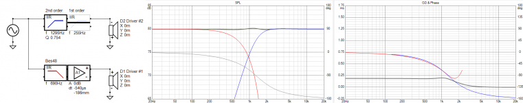

...The point is that it has half the excess phase of a similar filter without offset...
It occurs to me that this depends on what it means to say "similar" filter.
The excess phase is low for a similar 8th order lo-pass.
But more or less identical excess phase to the not-very-steep hi-pass.
So no real improvement if the constraint is the hi-pass, and it usually is.
Simpler to just put in an all pass delay in the woofer and be done with it.
Have to think if the idea can be saved.
Otherwise, phase linearization could be done with rePhase as an option, to learn if it makes any difference.

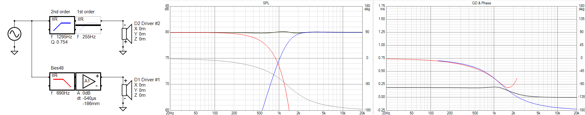

Its group delay is approximately 70% less than that of an LR 4 @ 1 khz. If a high order on the lowpass plus lower group delay is your concern then go for it.
I use some topology myself that would have about 50% more group delay than yours but which is 3rd order on the highpass and whose group delay is slowly dropping (like two cascaded 2nd Order Filters with a Q of 0.4). But it is only 2nd Order LP doesn't compensate for the delay of the horn offset. That one I do with an additional Bessel LP on the woofer path.

4. The hi pass is 3rd order, probably the practical minimum when both acoustic and electrical roll-off combine.
With a typical real-world horn, you'll find that even a 3rd order high-pass is not achievable in practice. What you'll end up getting, invariably, is a non-standard acoustic slope, with two separate "knees", one at Fx (crossover freq.) and one at Fc (horn cutoff). The result is a higher slope below Fc, AND more phase shift at and below Fx than predicted by a "simple" ideal high-pass.
The best way to approach this kind of simulation is not to try and simulate any combination of textbook HP & LP filters (even if asymmetrical) applied to ideal infinite-bandwith drivers.
Rather, it is to start with a simulated horn driver (with a 4th order or often even 6th order "natural" high-pass at Fc), and then superimpose the electrical HP on that.

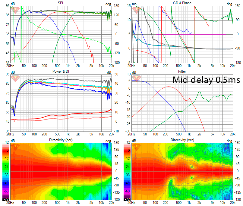

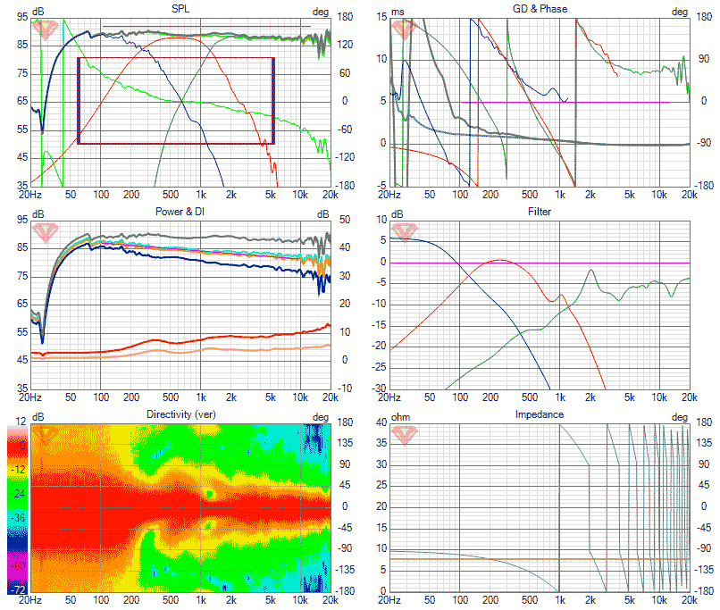

I'm exploring how to reduce group delay in a system (3-way prototype) and tried fiddle with horn / mid xo. The xo posted by AllenB seems to work except the horn high pass ended up being very roughly 4th order with weird knee shape and mid low pass is 8th order Bessel. I'm able to get rid of ~0.5ms delay on the mid that was required with more closely approximated LR4 filters. So, compensating for the physical offset of the devices with asymmetric slopes seem to work somewhat fine and got reduced group delay although I'm not sure if it is was audible at all to start with. Anyway, a quick experiment. I haven't compared if there is difference.
Interest in this was due to discussion of group delay in the Camplo 2-way mega thread and found this thread by searching. The deeper horns (exponential) have group delay in the design (cutoff) and from my own prototype projects I've found out that to get a crossover to work it seems the deeper the horn/waveguide is the more delay required on the mid for smooth response at the xo. I have observed the added delay on the mid woofer appears in the system group delay as well and reasoned that a shallower waveguide means less group delay for the system. Does this seem reasonable? In which case one should not use so deep a horn that generates system group delay close to audibility threshold. The xo slopes affect as well and the proto got a lot less group delay (at lows) with the W-M crossover with bessel filters as well, in comparison to LR4 for example.
I didn't optimize the slopes or did other changes on the attached xo sim. Need to checkout if the predicted in-room response can be closely matched to compare if either sounds somehow better in the prototype.
Still many questions for me to figure out. For example how a FIR filter that would linearize the phase and group delay would get rid of the physical misalignment? The concept is hard for my brain 😀 Thought to post here so that I remember to investigate this aspect further some day.
Attached GIF shows the effect of different M-T crossover slopes. The one with 0.5ms delay is roughly symmetric LR4 and the other is slap on 8th bessel low pass and a bit modified LR4 high pass. While the in-room response estimate stays almost the same group delay is reduced by the 0.5ms on the mid woofer bandwidth. Group delay is the dark gray trace on the top right graph.

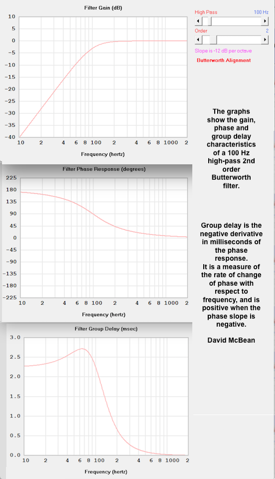

As David McBean pointed out in that thread, group delay (GD) is the negative derivative in milliseconds of the phase response. It is a measure of the rate of change of phase with respect to frequency, and is positive when the phase slope is negative.

From math book, flat line would yield flat derivative. Straight line phase, with an angle, would yield straight derivative as well. But since the GD plotted in ms the line would look curving up even though the derivative of phase was straight. Alright, maybe not concentrate what the GD plot looks like, only care about what the scientific studies have found to be audible and be happy with it 🙂
Derivative Rules
There are rules we can follow to find many derivatives.
For example:
The slope of a constant value (like 3) is always 0
The slope of a line like 2x is 2, or 3x is 3 etc
