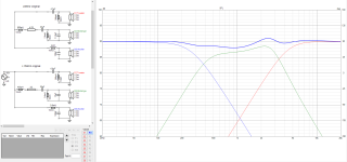

I’ve already put these values into simulation software, VituixCAD2, to see their filter’s characteristics. It showed the L1590/2 has peaky SPL response at the crossover region, whereas the L980/2 has smaller peak there.

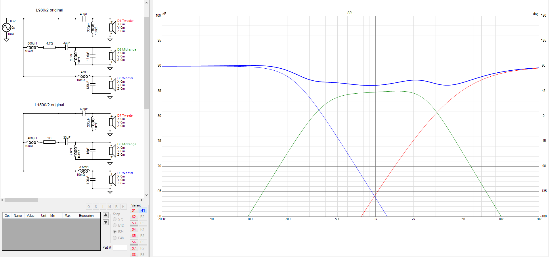

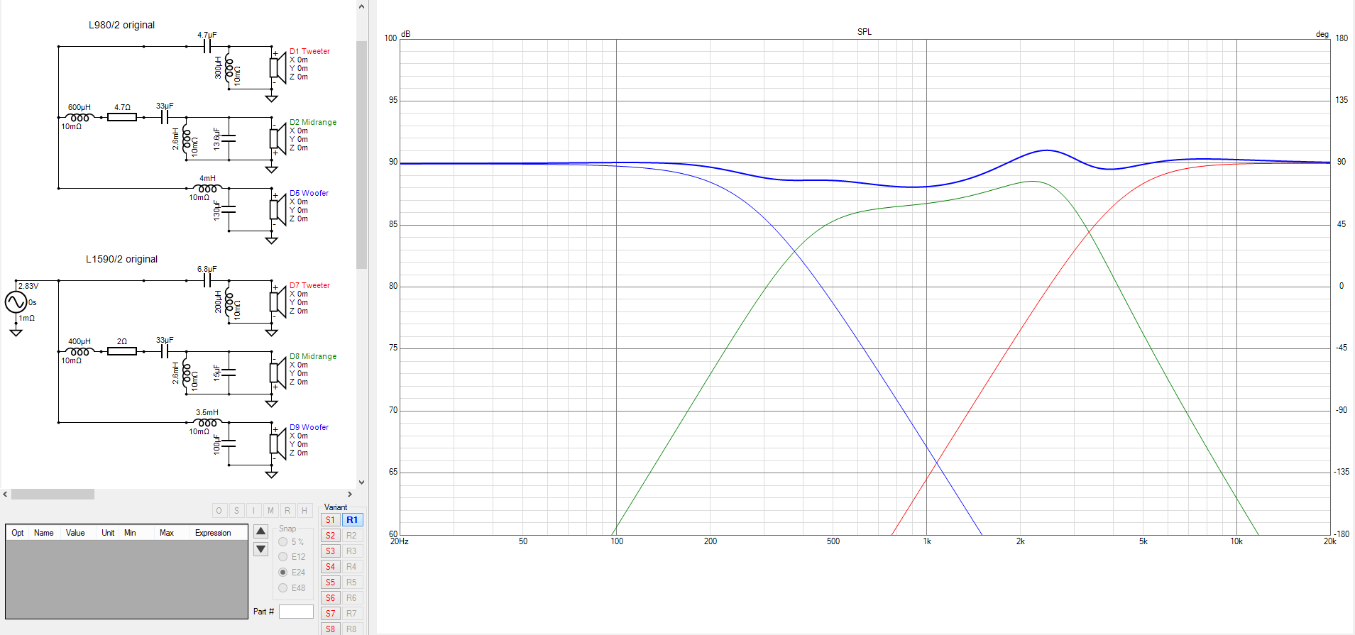

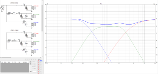

Attached are simulations of the crossovers of both L980/2 and L1590/2.

Do they sound like they're voiced differently?
Yes, AFAIK, the 980s were designed for studio monitor used while the 1590s were designed for home used.
I also used to convert my 1590’s crossovers to the 980's, but I've now restored them back to the original. I found that they’re voiced differently. The 980’s were a bit softer and more polite, whereas the 1590’s had a stronger, more pronounced, and more open voice.
That forward midrange might help sell units, but I'm sure some of us would choose to dial it back.
That begs the question of whether the difference is mostly equalisable voicing, or whether the cross itself is different the way we do blending these days. I'd say the first. The voicing would have been done that way because it was the only practical way. You could (and probably should) voice to your own liking, and while you're there manage the room a little within the confines.

Sim looks close to ~350Hz for the L1590, but the mid crossover for the ADS L980 was listed at 500 Hz.

The high crossover was listed at 5000Hz high and the speaker impedance at 8 ohm, your sim comes in ~3.15kHz, with the tweeter level hotter than the midrange.
Actually, the 980’s mid-to-low crossover point is listed at 450Hz regarding the spec sheet.
ADS seems to be as you mentioned, in practice.
