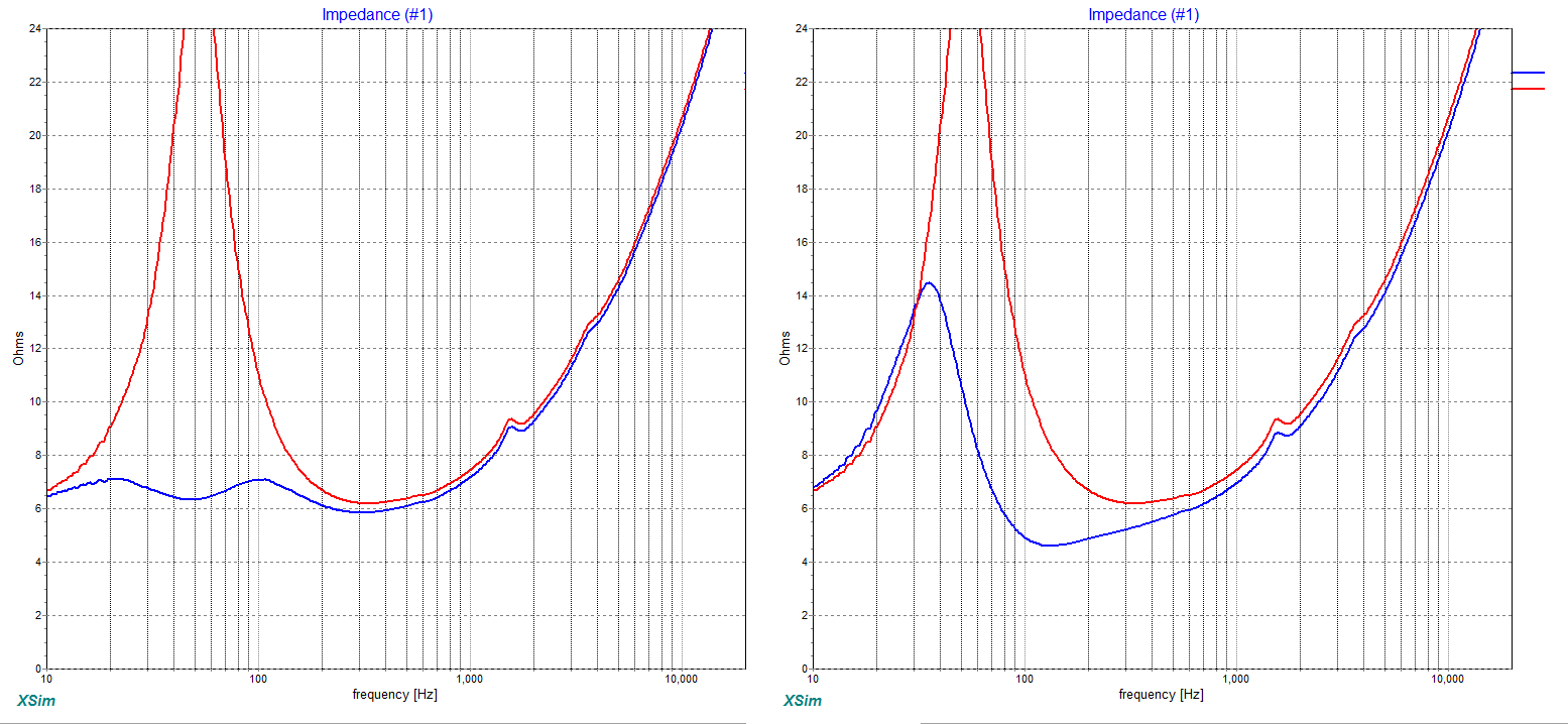

Just one thing I dont understand is is the LCR targeted at one frequency or is it like 40Hz min 50 hz max as even if you measure the res. freq. the equipment is never 100 % accurate.
Also which dictates the lower freq. is it the cap or inductor.

Try not changing anything on the woofer LCR. After a q&d sim in Boxsim I don’t believe you’ll be able to hear the difference between a roughly matched network and a spot on one. Unless you are going to change fb more than 30 percent.
make the box as close to spec as you can get away with.
