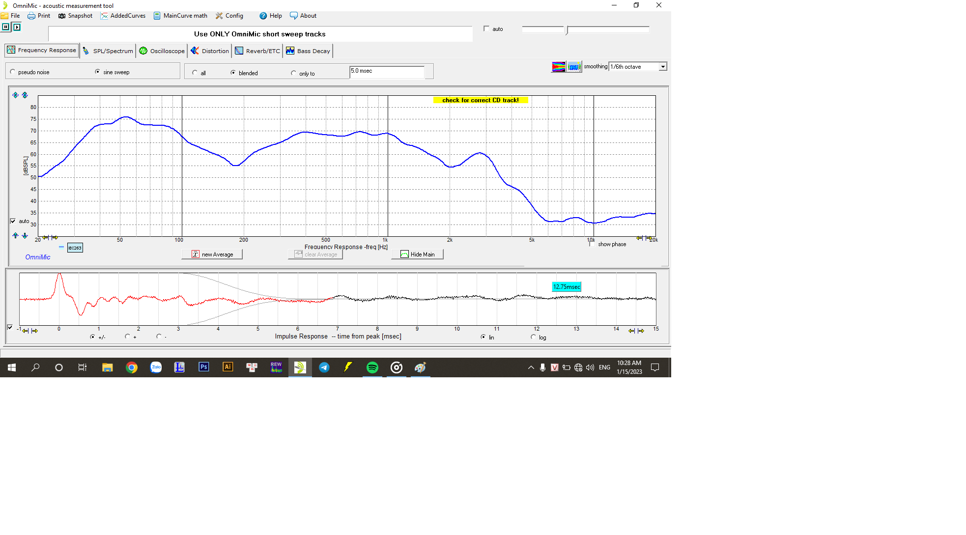

Hi all,
Measuring TAD TL-1601, I found its frequency response missing 100Hz to 300Hz range. it has a very deep "abyss" in that range (~15dB).
Pls check this pic.
I need advice on how to cross this bass driver, i have tried to cross it with third-order, fourth order crossover (500Hz) but that "abyss" is still there.
Thanks all.
As has been stated by others, that is not the real response of the Tad 1601/A/B or 03 at least.
1m measurement inside with 7 ms gating possible reflections, depending on distances.
Comb filtering from the horizontal config, also 4-500 hz is too high you will get plenty of combing etc unless 2.5 way config. The everests are a decent example to study.
And the obvious floor bounce cancellation often comes in this range.

Ill do the near field measurement
It is a floor reflection destructively interfering with your woofers output. Technical term is SBIR, Speaker Boundary Interference Response. Has nothing to do with drivers themselves. Years ago I had a similar issue with 12" woofer 55 cm above the floor:

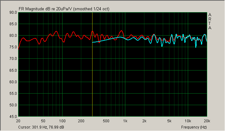

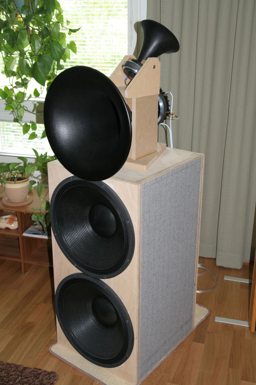

"As is" there is no way to fix it - no reasonable acoustic absorbtion is going to be effective at 200 Hz - but at listening position the dip is not going to be so severe. However, you can turn a vice into a virtue by turning your woofer box sideways - this way floor reflection will reinforce your woofers output, creating a short line array. Kimmo Saunisto had a 2x18" system empoying this trick (and cardioid enclosure to boot). He crossed at 400 Hz with a coaxial horn.
https://web.archive.org/web/20200512164727/http://kimmosaunisto.net/KS-1804/KS-1804.html
Look how smooth and even the in-room bass response is:
View attachment 1131015View attachment 1131016
(well, I understand you probably aren't going to do this; still worth it to show the elegance of such solution IMO)
