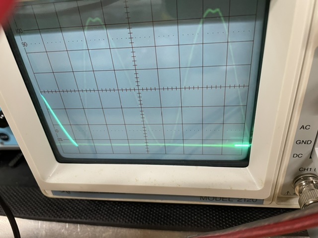

Understood. Actually I had forgot to turn on my bench ps. The amp was pulling down a Pb battery. It’s pulling up to 90ish amps now.... but I think there’s still a possible issue? The bottom waveform clips way before the top. Maybe this is why I don’t really care for class D. VDiv set to 5v. Probe at 10x.

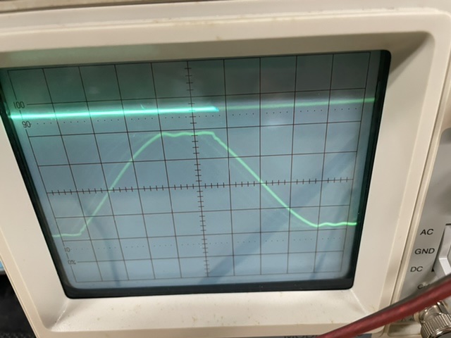

Even under NO LOAD, the bottom waveform clips before the top same as image above. I'm only seeing about 42vAC across speaker terminals. Checking rail voltage.....

Rail voltage is 126vDC directly across rect Anode and Cathode center legs. Output FETs are all seeing +-62vDC referencing RCA shield depending on the leg/fet etc. The FETs I am certain are seeing rail voltage.
So... Something is causing this amp to clip at about 40vAC at speaker terminals. I'd think there should be another 70ish AC volts on tap due to having such a high rail. Rail is not sagging under tests/load or no load more than 0.5vDC.

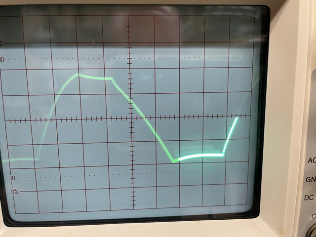

If you use one scope channel for the rails and the other for the output, do you see that much of a difference between the output and rail?
Test the 2 channels on the same point to make sure both channels are reading the same.

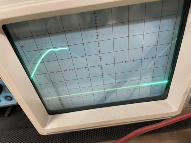

5vDiv. 10x on the probes. Reference is RCA shields for both probes. One probe on the rail directly at output FET set to DC on scope. Other probe on speaker terminal set to AC. I think shows a better story but does this look alright? Looks like a few volts shy of rail on both sides.

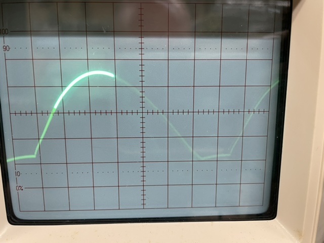

Are the vertical amp 'cal' pots set to full clockwise for both channels?
This doesn't look like 50v/div. That would make the rail voltage about ±140v.
Scope wasn’t calibrated but I think it is now. Cal was way off almost a factor of x2. Here it is again calibrated and showing at 20vDiv. Seems to be better matching now to my fluke 16 measuring +-63vdc rails. Perhaps this amp doesn’t need any more Dr Zeus vaccines.
