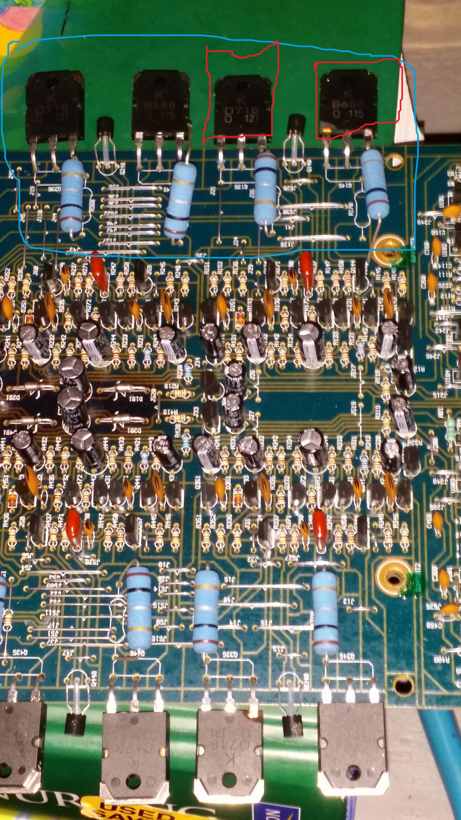

The blue areas on both sides appear to be within spec.
The red circled areas are the location of the bad channel.
I rechecked the output transistors on all four channels, they all meter around the same values on diode mode as listed in a previous post.

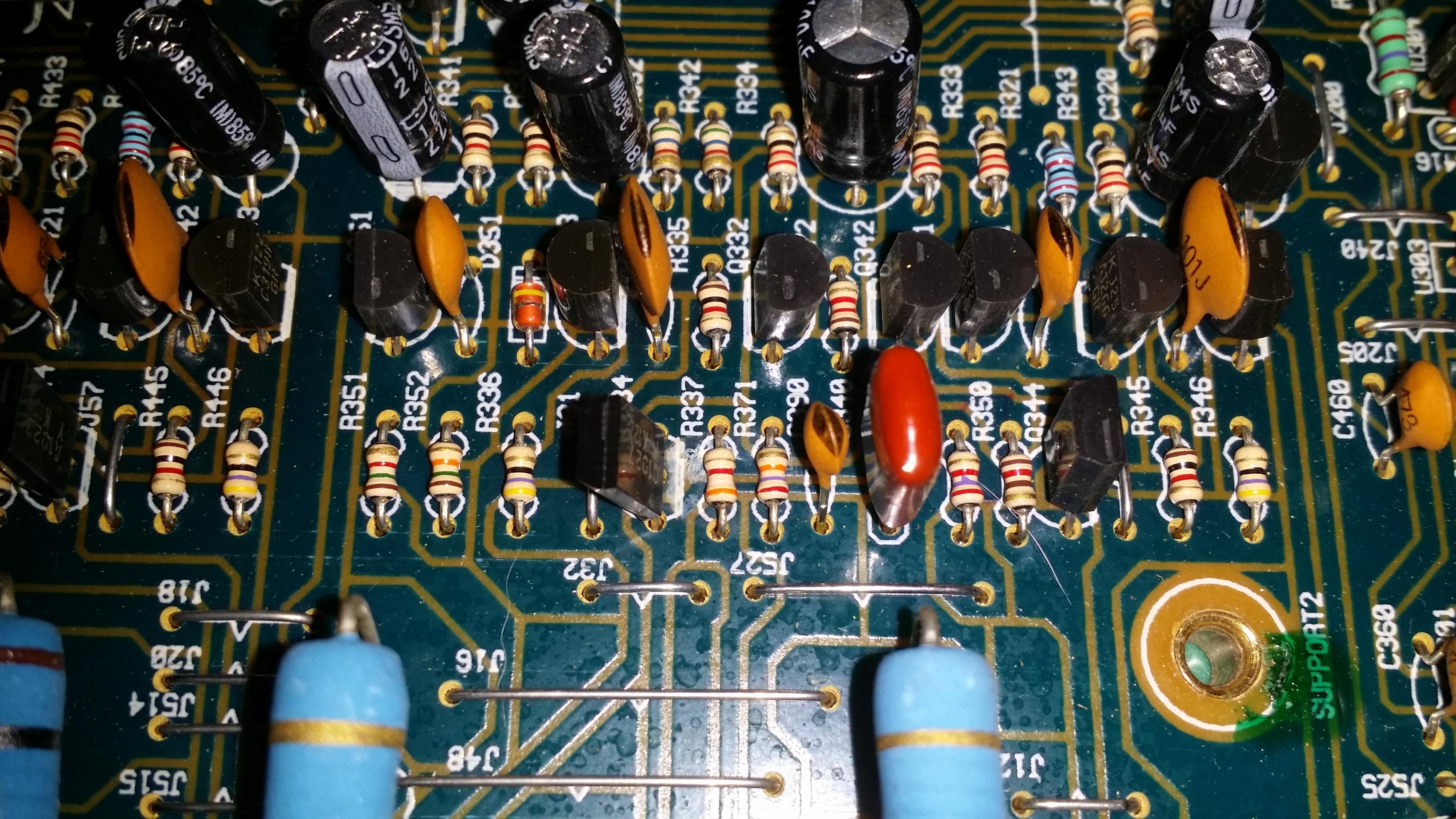

Anyways I was again looking over the board and saw something a might suspect.
Looks like some kind of residue or maybe moisture on the board. Picture attached. The resistor appears to be ok, spec wise, thoughts about the black transistor next to it? I measured it removed from the board in diode mode, using standard B C E, or left to right if reading the text on the transistor:
Negative lead B then positive to middle or C=1 on my meter, no change
Negative lead B then positive to outer leg or E=.559
No other combinations of meter to legs show any readings, 1, no change
Thoughts?

Why are you checking the resistors? They are generally obviously burned when defective in an amp like this. Did you compare the transistor readings?
The transistor could be defective. You should see ~0.6 from B-C and B-E and open with the leads reversed (out of the circuit).

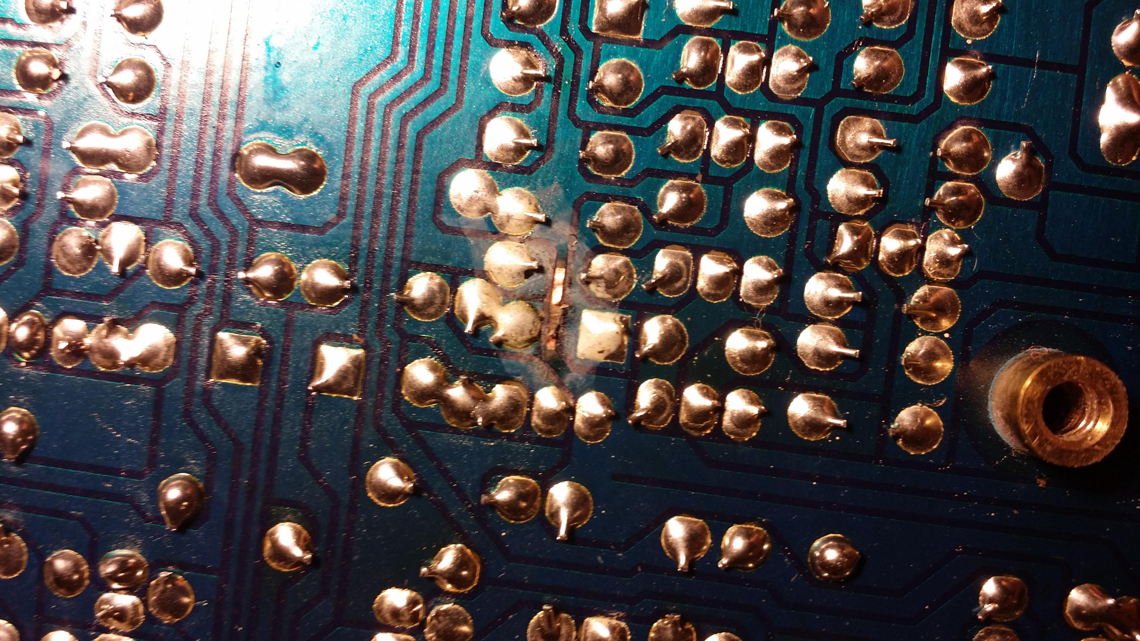

Look what I found...a broken trace. It was mostly obscured by the board leavings but after cleaning with some alcohol and q-tip, it was much more visible.
Not sure what caused this, and my trace repair pen was not much use (older) but I put some silver goo on the trace, checked the trace and it appears to have a solid connection.
Going to let it dry tonight and put some power to it tomorrow to see if that darn blinking stops.
That appears to be a ground trace. It was likely burned when a speaker wire shorted to ground.
In the future, use a piece of wire to jump to each side of the burned area. Remove the loose copper to prevent it from shorting to anything else unless the jumper you use is soldered to the loose copper.
