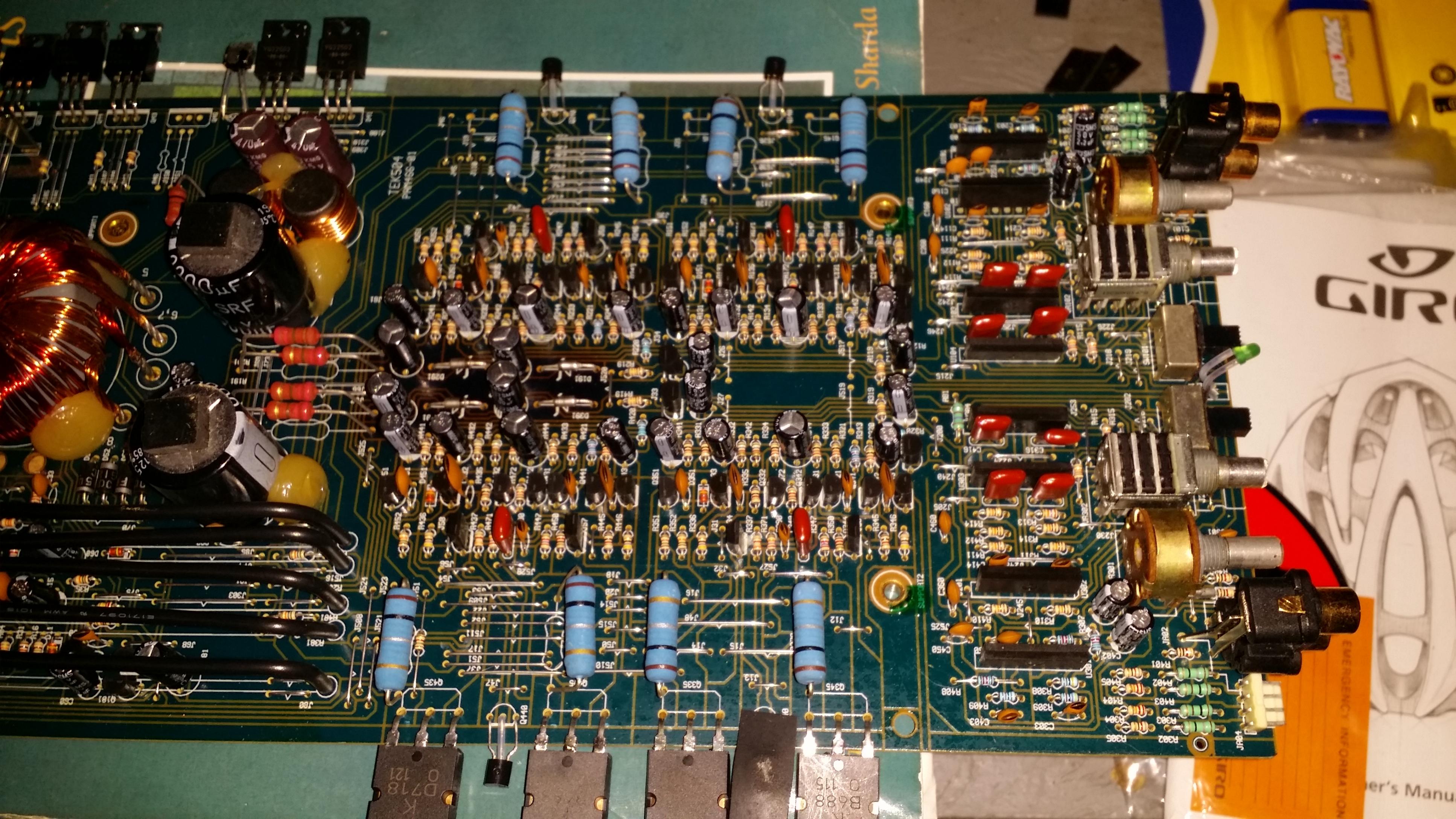

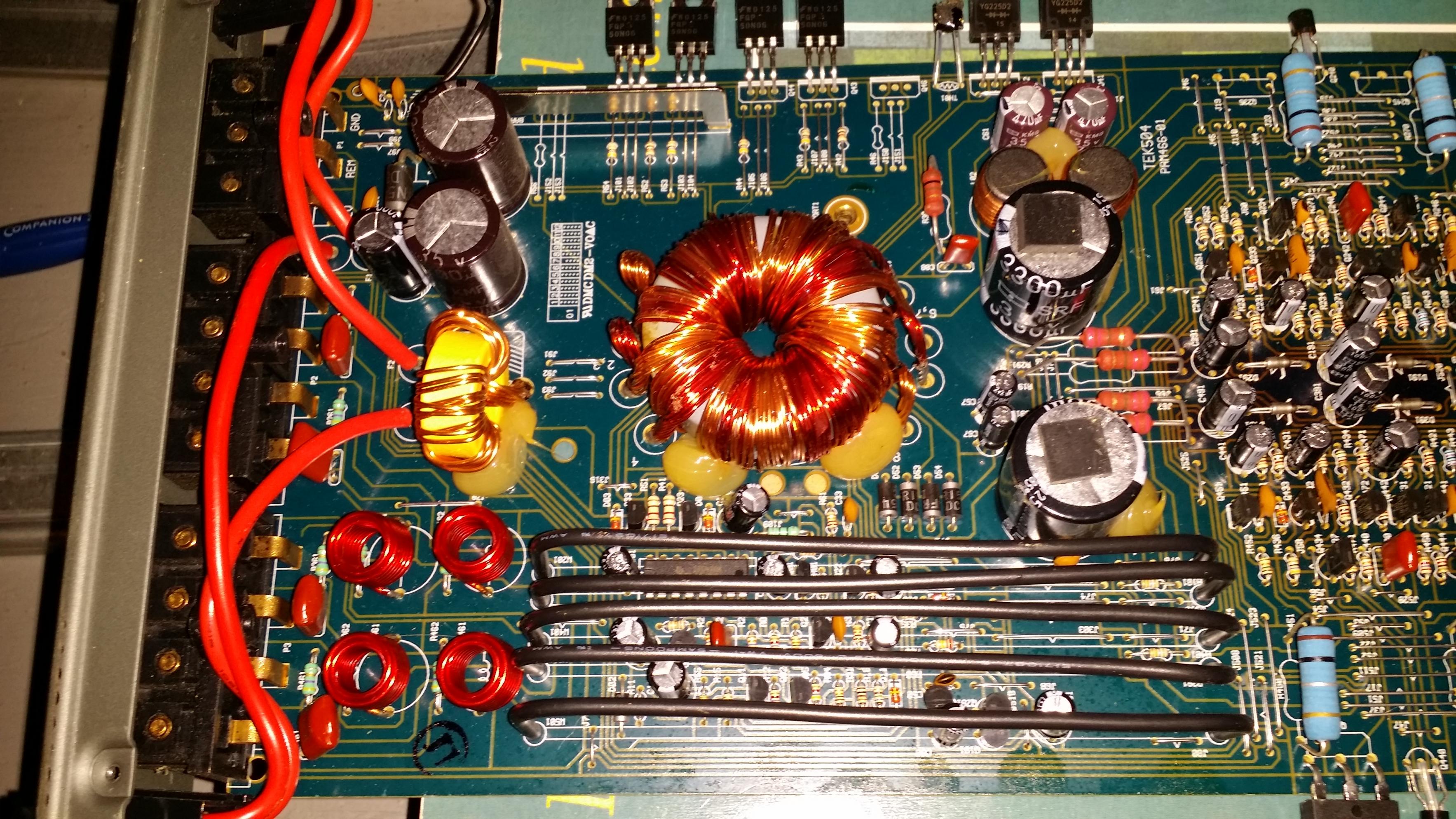

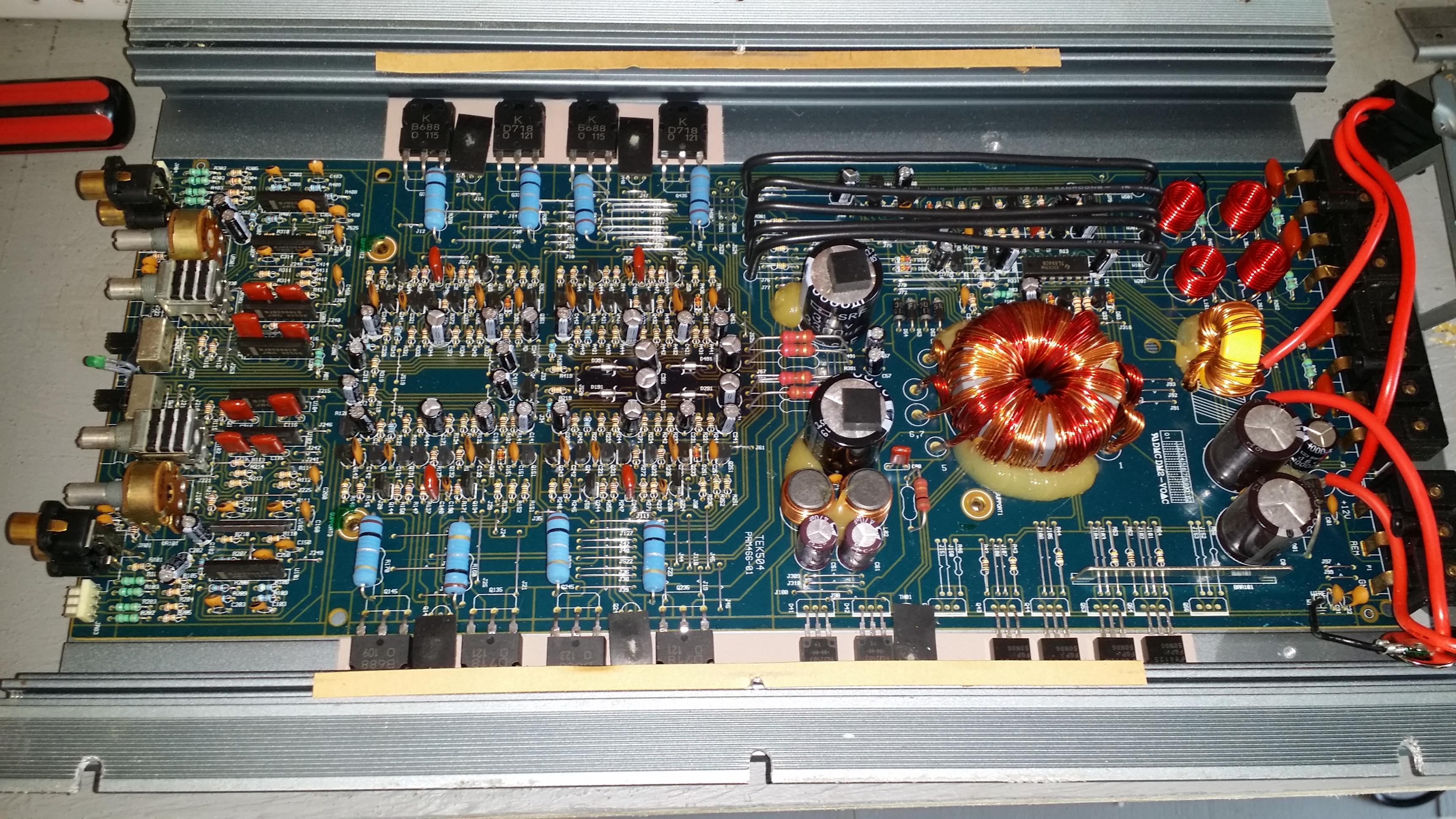

Hello, I am currently working on a crossfire tek504 (first repair).
The amp goes in and out of protect and also forces my power supply (ac to dc converter) to do the same when powered up.
I have read through the BCAE repair guide a few times to get some information as well. So as this is my first amp, I thought i'd dive right into metering the d718 and b688 transistor pairs.
Diode test mode for d718, attached to amp:
positive lead to B, negative to C and E-.55
negative lead to B, positive to C and E 1.2~+
Removed from amp:
Nothing when reversed...
Similar readings for the b688 when in amp and when removed from amp
Confused, I removed all 4 transistors from one side (two of each type), and they all appear to meter within the acceptable .5-.7 range using diode test mode when outside and inside the amp, but only read 0 when outside the amp when reversing the leads.
I was expecting one of those to be bad, thus causing all of the others to read bad while installed on the board.
All of the d718 and b688 resistors are behaving the same way while installed in the amp board (I metered them all).
Thoughts on what to check next?
I don't see any visible damage/soot/scorch marks and I believe that this amp was dead shorted B+ to ground at some point (not sure, friends amp i'm learning on).
Thanks for the assistance.
JF

There doesn't seem to be any shorted transistors.
Since you don't have an auto-ranging meter, you have to manually set it to the best range. When testing for leakage on a transistor out of the circuit, the highest resistance range is likely best. For testing in the board, you have to use a lower range because other components will skew readings. You cannot check for leakage with the transistors in the circuit.
Post a good quality photo of the board.

Transistors in right place, from left to right is d718 b688
resistors (large blue ones in pic) read within spec for ohms at .5.
Other thoughts?
Other thoughts?
To clarify, 0.5 ohms is only within tolerance if your meter reads 0.4 ohms when you touch the probes together.
Comparing the readings from the defective channel to another?
My meter reads .1 at rest, and I 0.00 when touching.
If I read the colors correctly, those should be .5ohm resistors (the big blue ones are what I'm measuring) and I measured all of the resistors, but they are all connected to the board still.
So I removed one leg of a resistor from the board from the suspected bad channel and one from a good channel.
Measured at 200 ohm setting and both were in the .7 ~.8 range, suspected bad and good.
