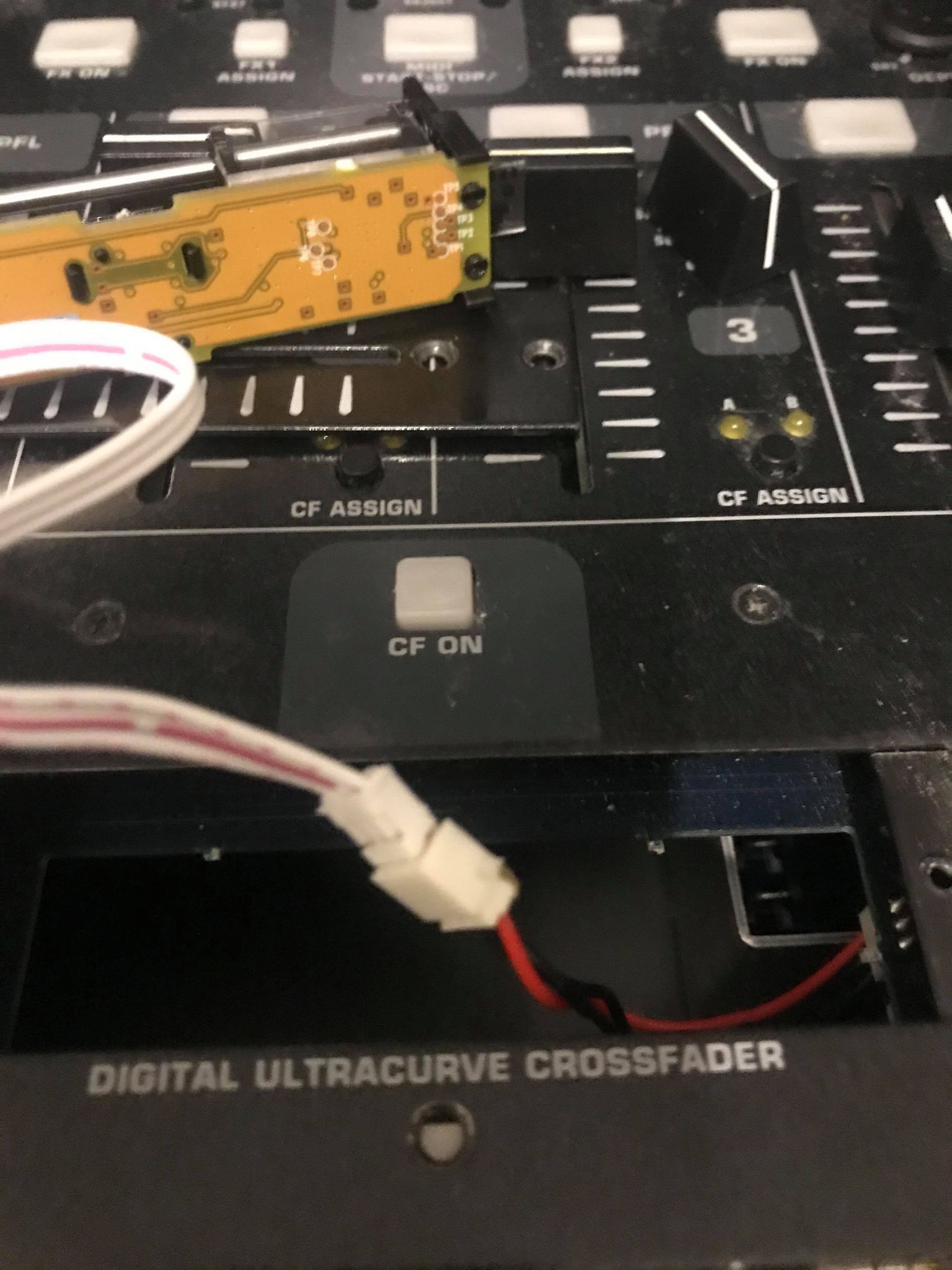

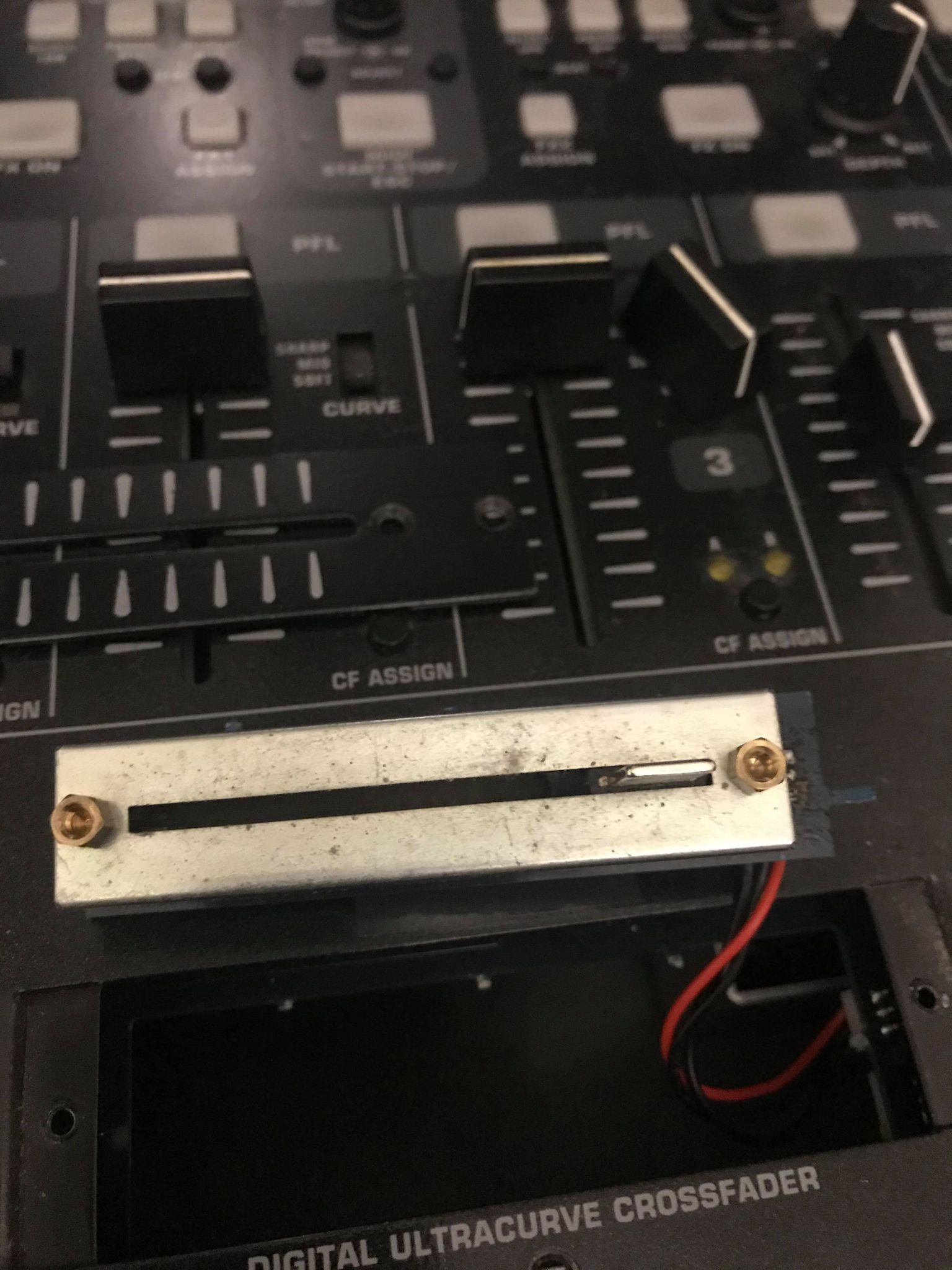

However, when i took the top off my mixer i was shocked to find that the original fader was not plugged in at all and was hard Solderd to the mother board, and so there was no way of removing the fader from the mother board (so i at 1st thought)

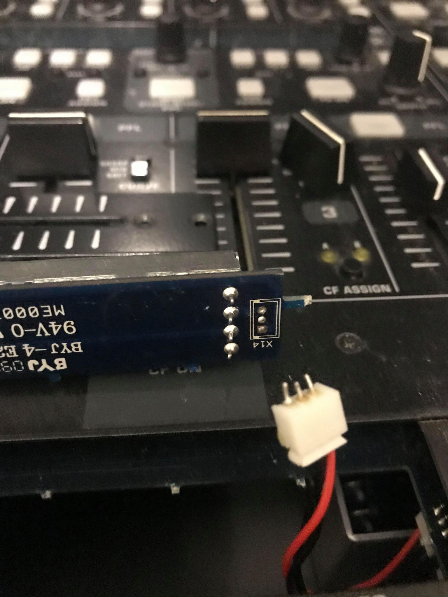

Next to the hard solderd 3pin was an actual 3pin plug that would indeed fit the new fader. so i looked into weather or not this was where i was supposed to put my new fader.
After looking at the instructions provided with the New fader it did indeed look as if i could do this. However i then realised that the original fader would still be attatched and therfore how could this be so...
I decided to take the old fader of its cable leaving the cable attached to the motherboard and i then simply plugged in my new fader to the side sitting 3pin female and tested the fader. Which unfortuantly did not work... it did make some chance and as i slid the fader side to side i would get a stuttering effect like (on off on off on off - across the whole fade) rather than a simple fade in and out accross the range of the fader.
So i presumed that either the fader was knackerd (BRAND NEW) or i was missing something.
Eitherway. plugging the new fader into the secondery female 3 pin did not work. So i thought about my options... Maybe i could hard wire the New fader onto the remaining wires from the old fader and all being well this would work nice.

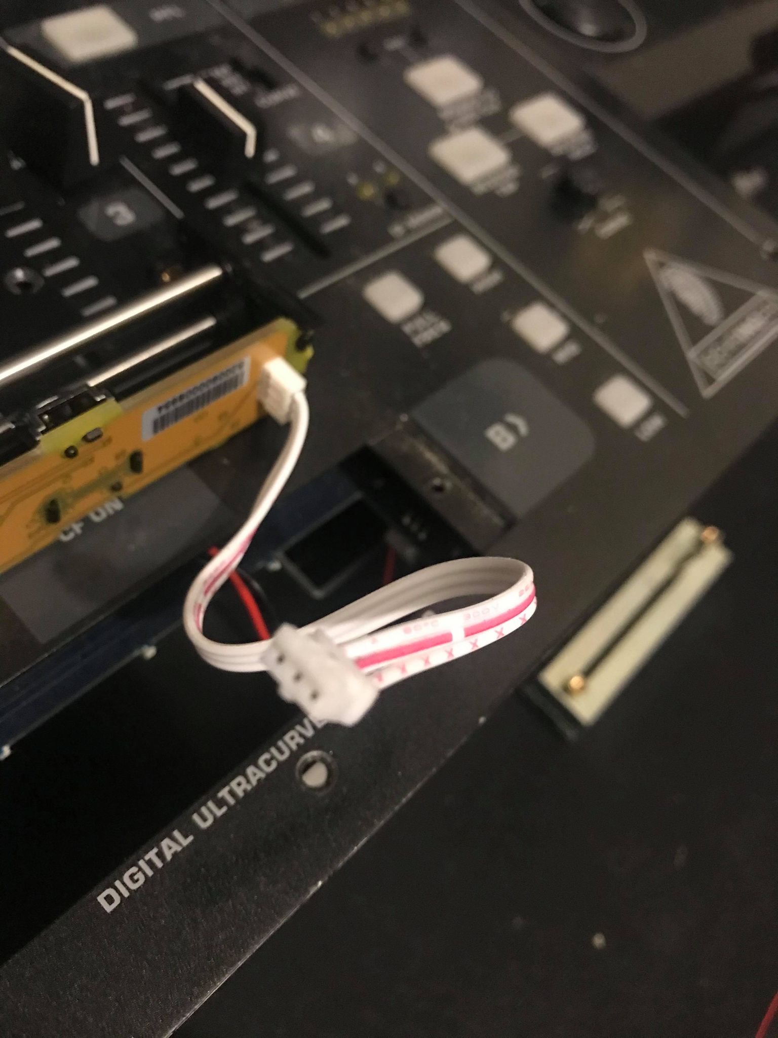

I decided rather than connecting and soldering the ribbon of the new fader and the old faders ribbon together than i would use the old faders 3pin female plug and connect the 2 ribbonss together with the 3pin female as a conduit connector.
this worked out great and the 2 ribbons connected nice (see pics)
Perfect i thought, this has got to work. So again i tested the fader, only to recieve the same results as before. A stutter effects as the fader slid from side to side.

f2.jpgOld fader 3pin male ribbon with a female 3pin reciever at its side
f3.jpgAdding the Old Faders Female Reciver to the original ribbon (to receiv the new faders ribbon)

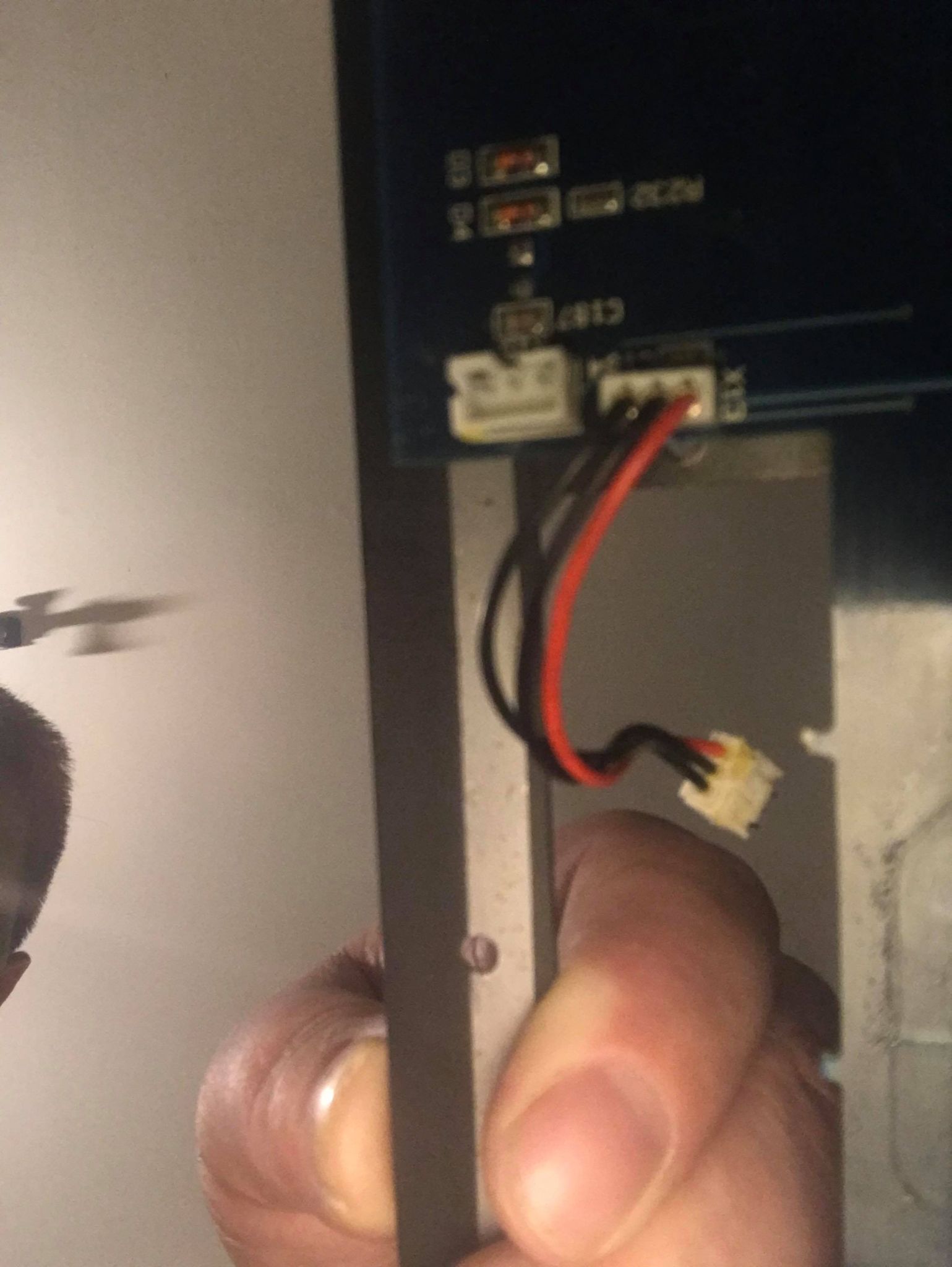

The end result being the New fader connected to the Old Faders Ribbon that connects to the motherboard of the mixer (i would of thought this would of been the solution but no)

Basically, the empty Female 3 pin Connector next to the original Ribbon is wher this New Fader is supposed to be installed.
No instructions on what your supposed to do with the old ribboin, leave it connected or take it off.
But definatly your supposed to install the Infinium onto the Secondery 3pin port next to the original.
O.k So as i stated before i allready did this and it did not work. i just got the stuttering.

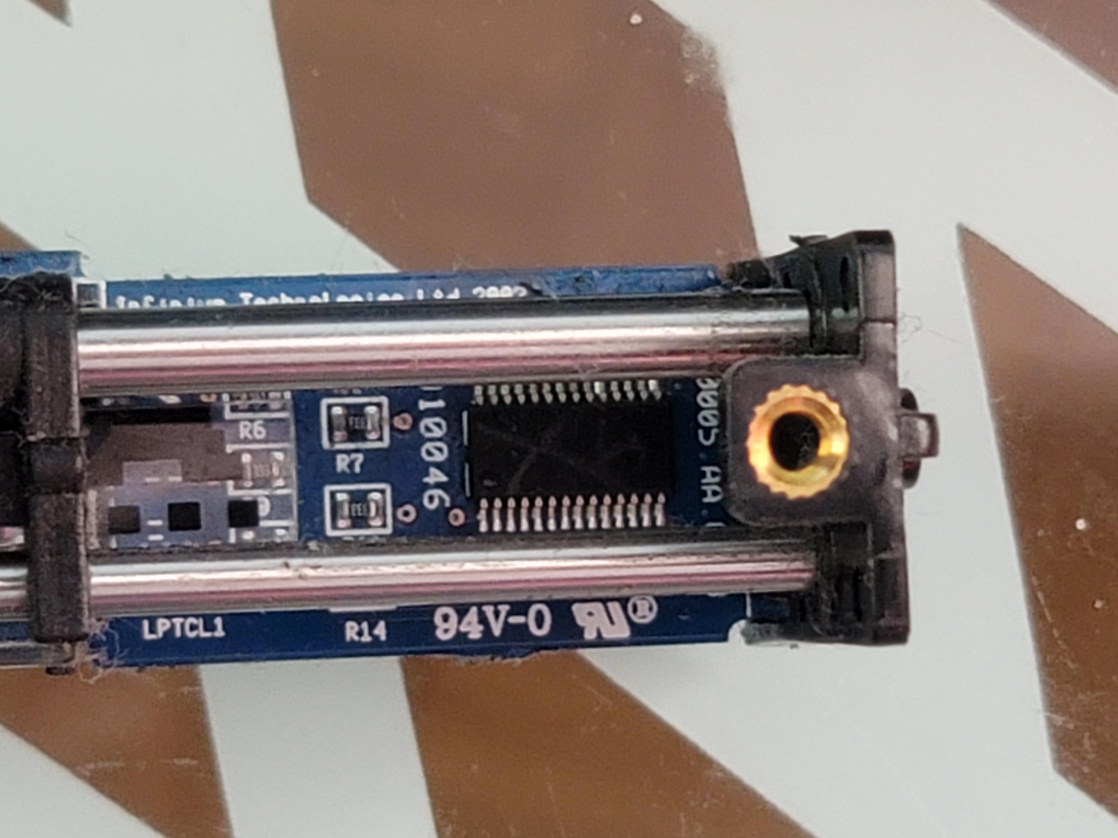

FURTHER UPDATE (NOW I KNOW WHY)
So after looking into this in detail, i decided to give it another go on my mixer. And of course it did not work.
But as i was putting the fader back into its box, i noticed how hot it had gotten and i took a look after the chips to see if they had fried or anything and to my Astonishment
I Found this.
161200387-123168149755477-3716570867450682969-n — ImgBB
The bloody nerve.
The supplier has only gone and sold me a Fault Fader with a Big Fat X on the main Chip.
No wonder it dont bloody work.

yes, you see. the X1 you have has the blue board and is the genuine X1. the 1 i got has a different setup on the board and has a creamy brown board.
The Main chip on yours is 3 times the size of the chip on the fake i got.
No wonder iv run into problems...
shame iv not got a pic of the fader to show you. But its 100% not what you have there.
Oh right i see what your saying... Theres an "X" on the chip.
I just presumed it ment the chip did not pass inspection lol..
I guess it means it was tested.
Eitherway. the bloody thing didnt work for me and was completly different to what you have there.
I bet if i was to get the origional X1 like youres that there would be no problem.
