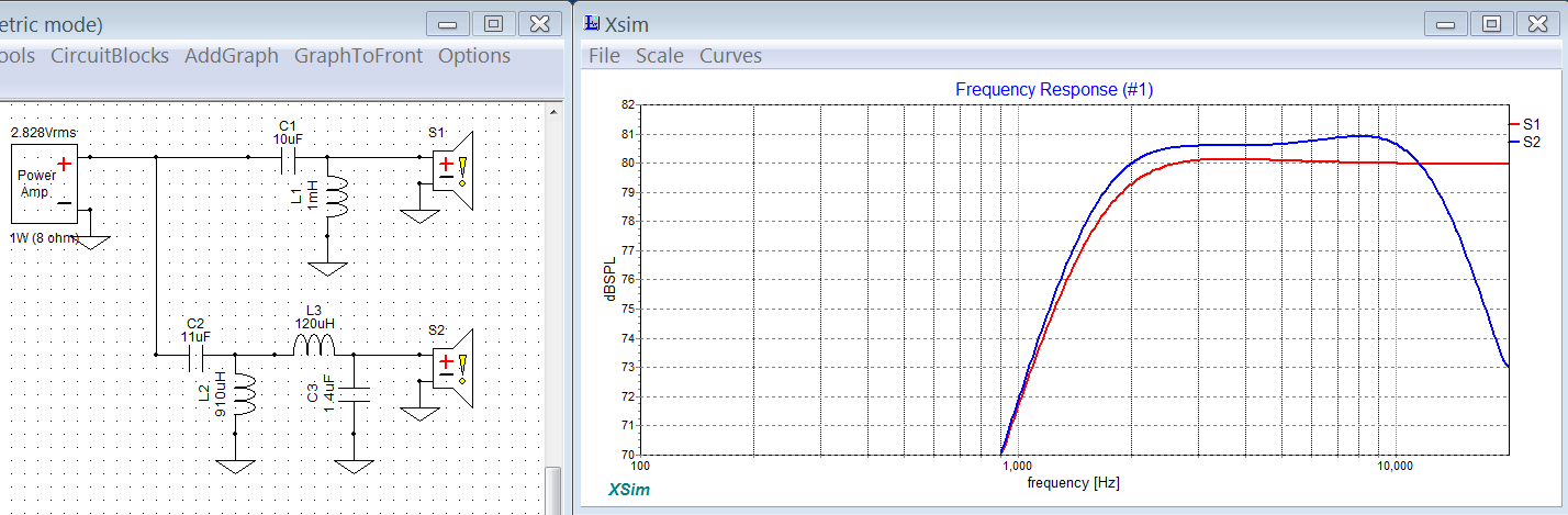

While that would be more challenging I think there's a point at risk of being missed, and that is that resonance is a relative thing (over a band of frequencies) and if it gives us what we need then it can be acceptable. How is it in that sense different in principle to any band limited system, like a driver, or an enclosure.
