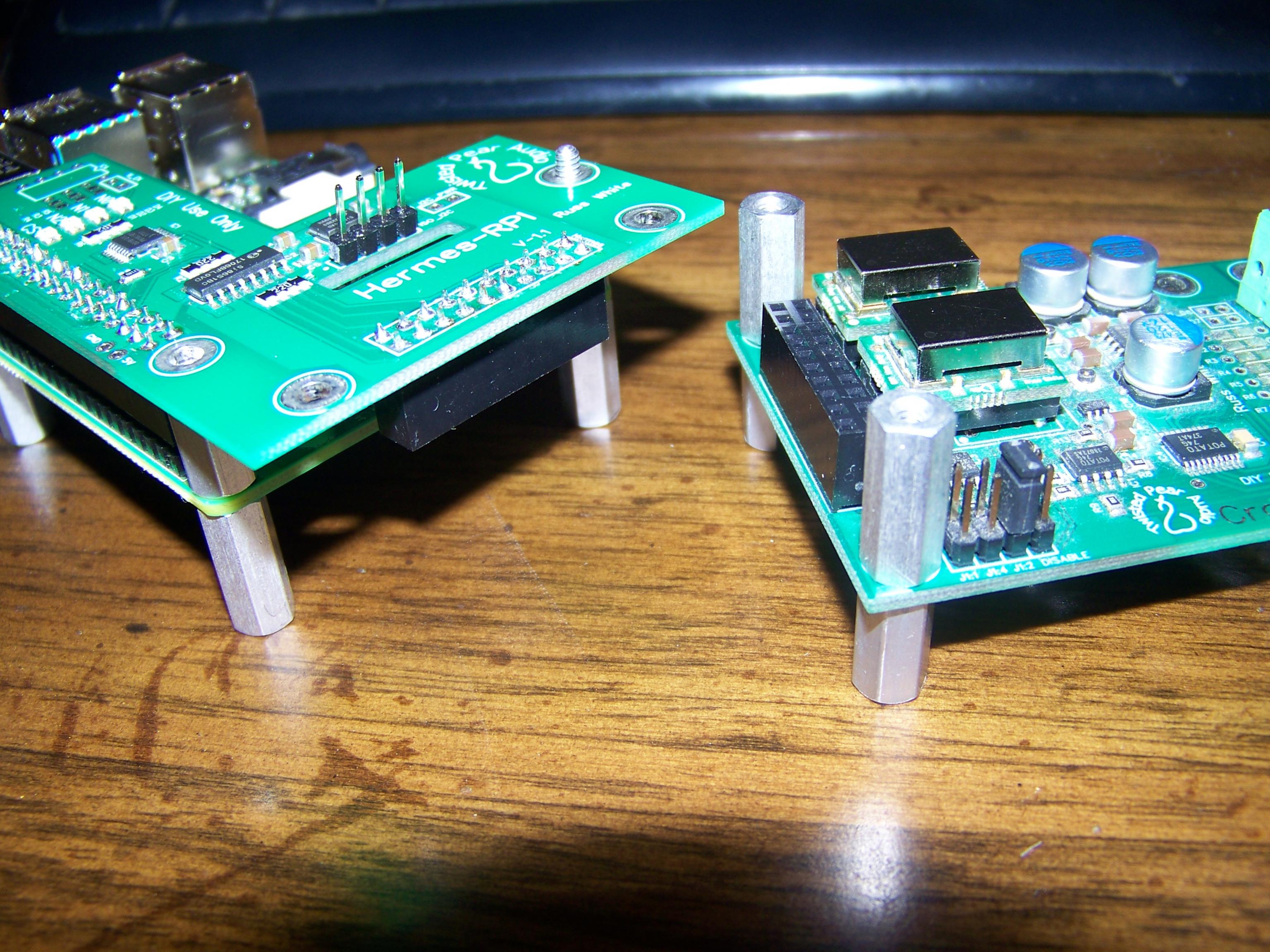

Hi!Hi,
can anyone say if the Miero mod/update will work with ROPIEE,
which is what I run on the Rpie which outputs to an iancanada
The current package from miero can be used to build the overlay file on the last raspbian with 5.4 kernel.
(But not the recent Raspberry OS with 5.10 kernel)
If ropieee is still with a 5.4 kernel too, then you should be able to copy the tpa-hermes-rpi.dtbo file in the right folder and add this line to config.txt
dtoverlay=tpa-hermes-rpi

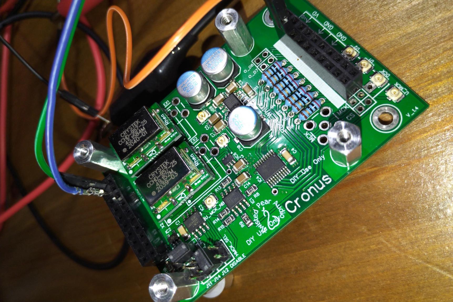

Getting a little bit further 🙂 I now have a proper looking signal at the Cronus output.
I cannot find anywhere, what does a jumper on HMCK_SEL do?
Found out that the Amanero plays even when there is no master clock signal. I read somewhere this shouldn't happen. Also found out that you need to power on the Cronus, then plug the USB into the computer otherwise there will be no signal at the Cronus. (Even though the Amanero seems to be playing).
The issue is with the Cronus/Teleporter combination somehow. Can the input voltage for the Teleporter be too low?

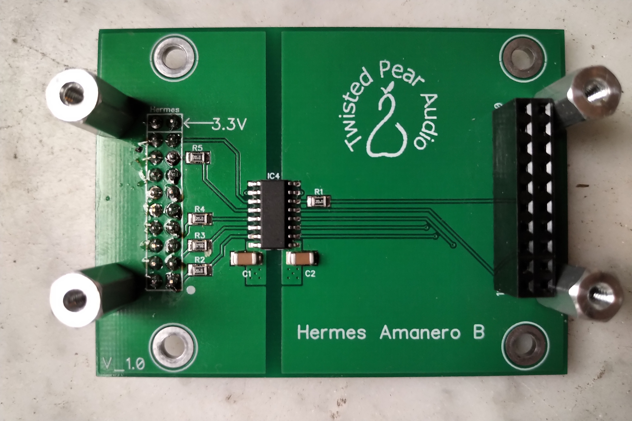

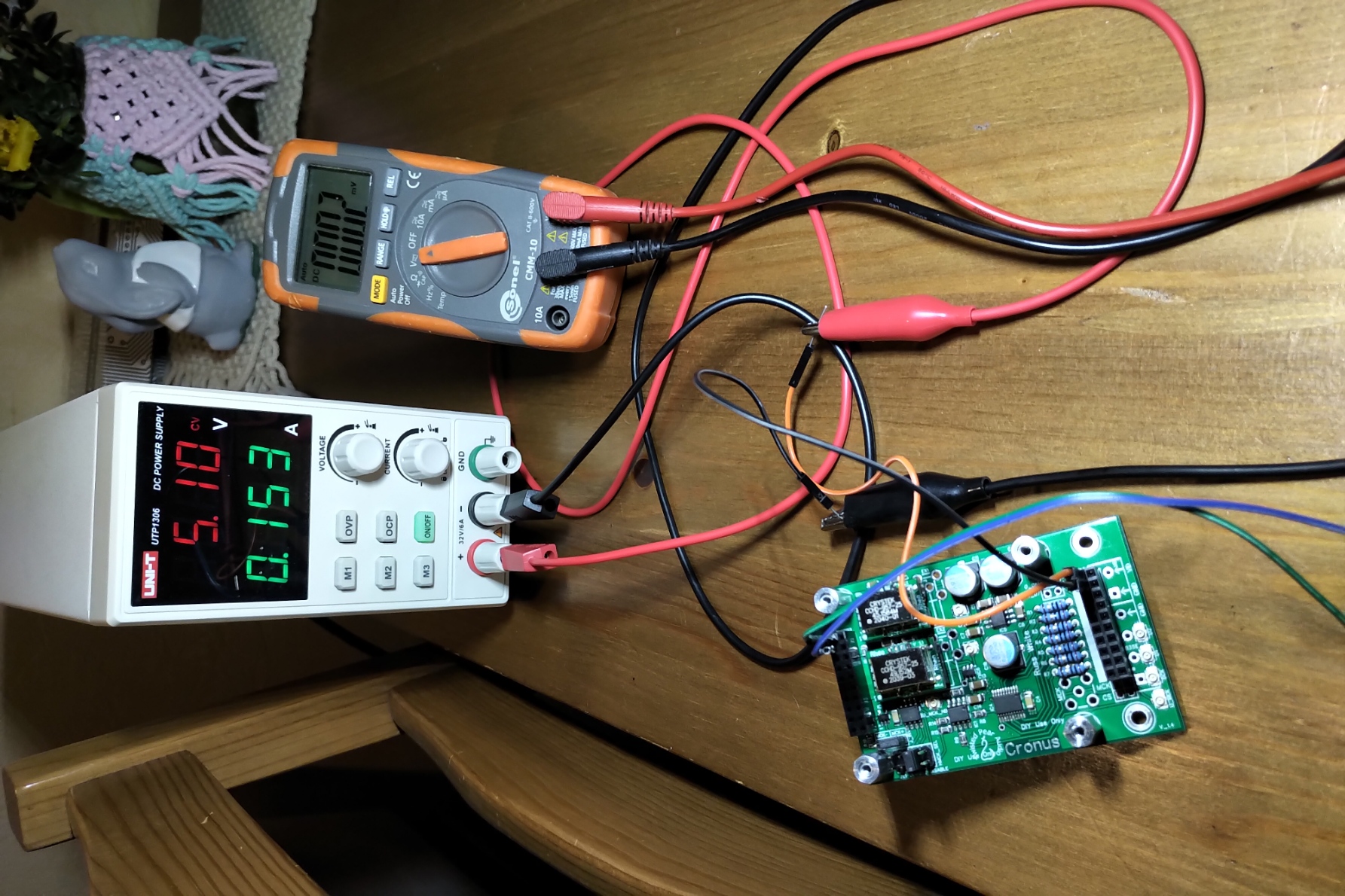

No 3.3V at output from Cronus to Hermes

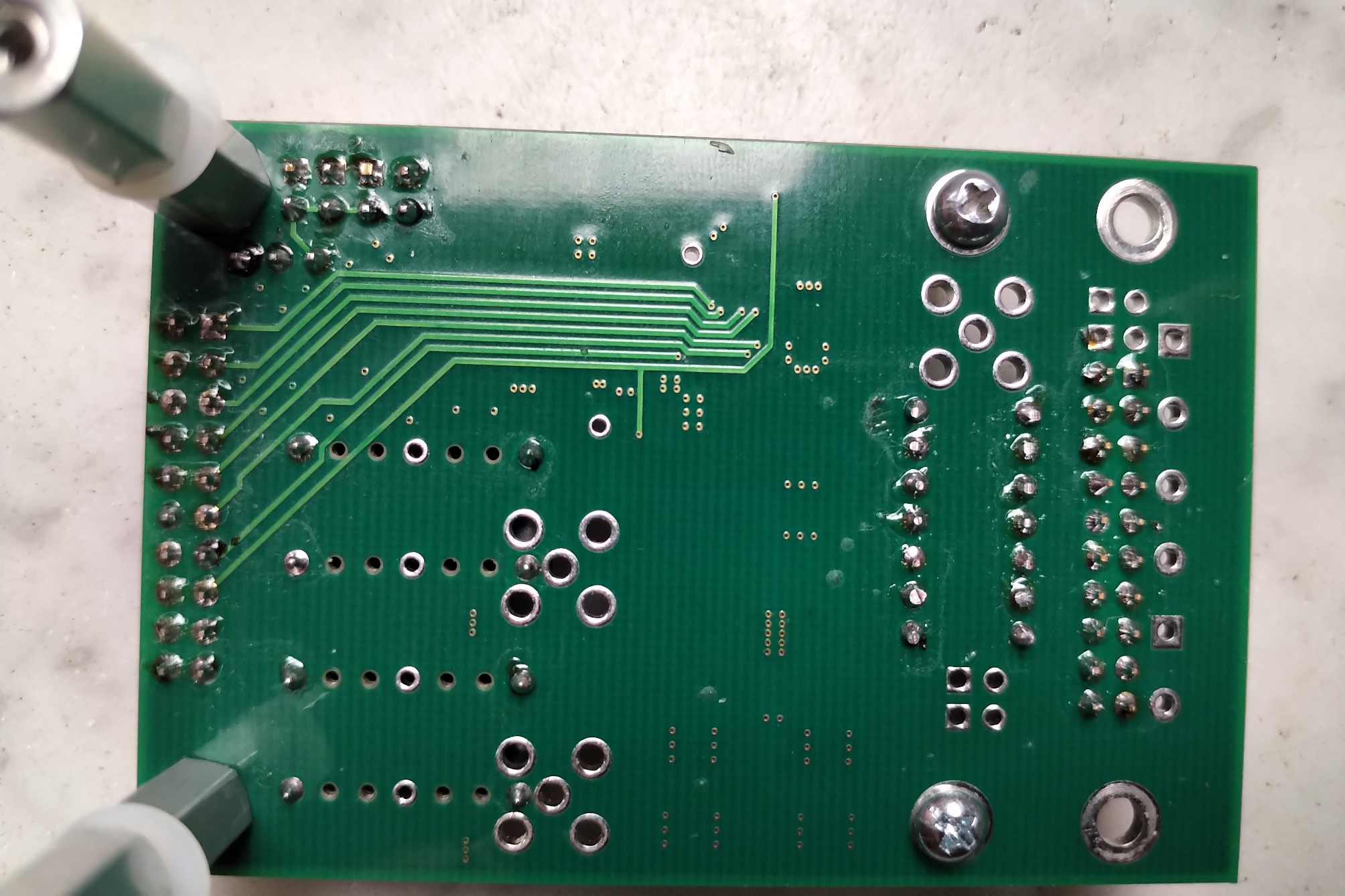

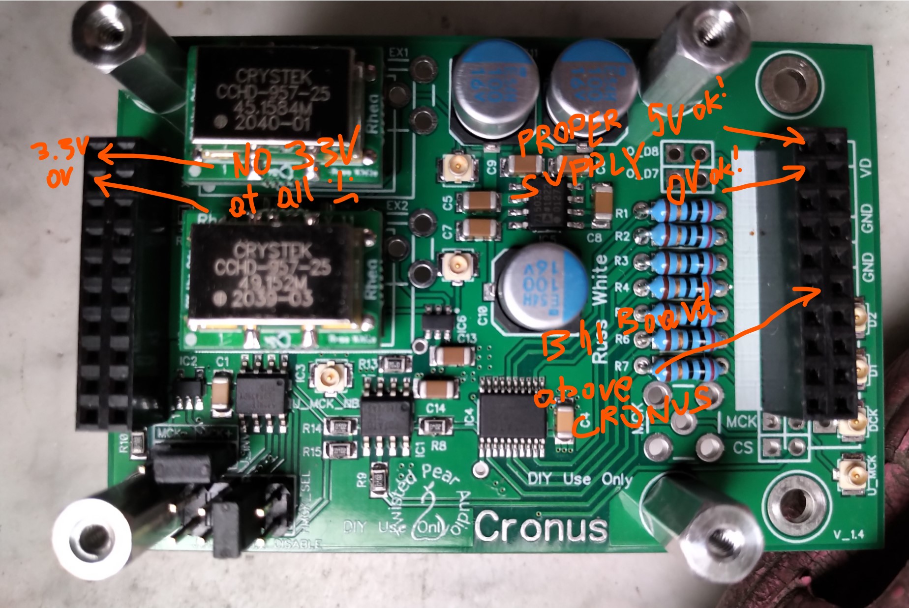

Hello everyone, can I ask for help?
I recently purchased Amanero / Hermes / Cronus Combo boards for Buffalo III DAC. Connecting Cronus to BIII is made directly via a 20pin header (so there is no mistake when connecting). I coped with the change Amanero to Slave firmware etc.
After all NO LOCK :-(
I checked Amanero connected directly to BIII via I2S, with CPLD_for_1080 and it works correctly.
Then I checked the Cronos module and as you can see that when I give 5V power to the supply header of Cronus, I have not 3.3V voltage on the appropriate Cronus pins for the Hermes module.
Does this mean that the new arrived Cronus module is not working properly?

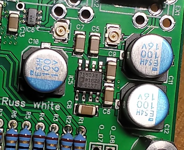

Incorrect Cronus v1.4 SMD soldering?
I am still looking at the received Cronus v1.4 module and please correct me if I am wrong, but is the ADM1750 linear regulator not mounted the other way around? This is suggested by other photos of the Cronus module on the internet. In addition, I checked it with a multimeter according to the datasheet https://docs.rs-online.c...98/0900766b812c18ef.pdf. Do you agree with me?
That chip is definitely backwards, sorry about that. I will send you a replacement module.
Good morning, thank you for your answer. So I am waiting for a replacement Cronus module. Please check the new one before shipping.

Brian, it is possible that the rotated AD 1750 chip burned out shortly after being first turned on. Do you think the Rhea modules survived this?
