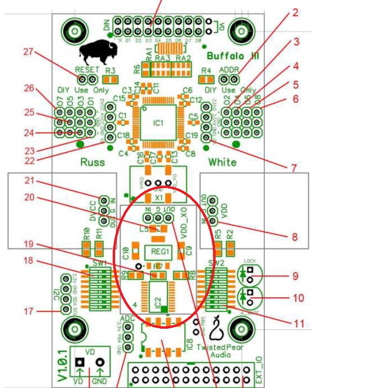

How to remove XO trident?
You must always remove the XO trident if you use an external clock. You don't do anything with the XO itself - leave it alone.
For dual mono with B3 or B3SE I would suggestion async mode (just leave Buf configured normally with XO trident) - but if you go synch you need to route the master clock to both DACs.
In any case for dual mono you just route all signals (except MCK if going async) to both DACs.
Can anyone explain this in more detail please? I have a B3. I can't figure how to remove XO trident.
Thanks,
Doug
Thanks,
Doug
See the attached picture. Just pull the trident regulator labelled VDD_XO. I've circled it in red.
---Gary
