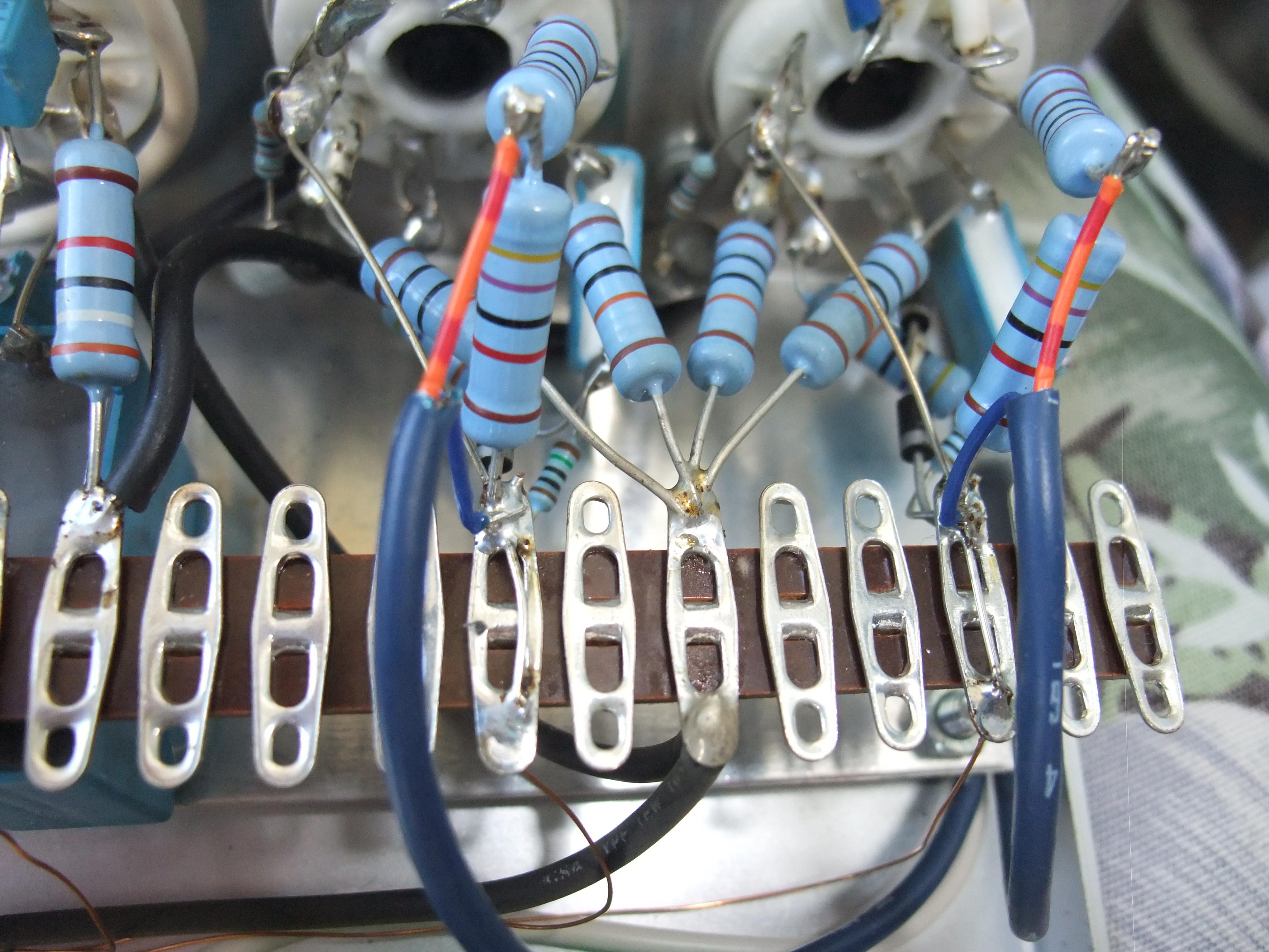

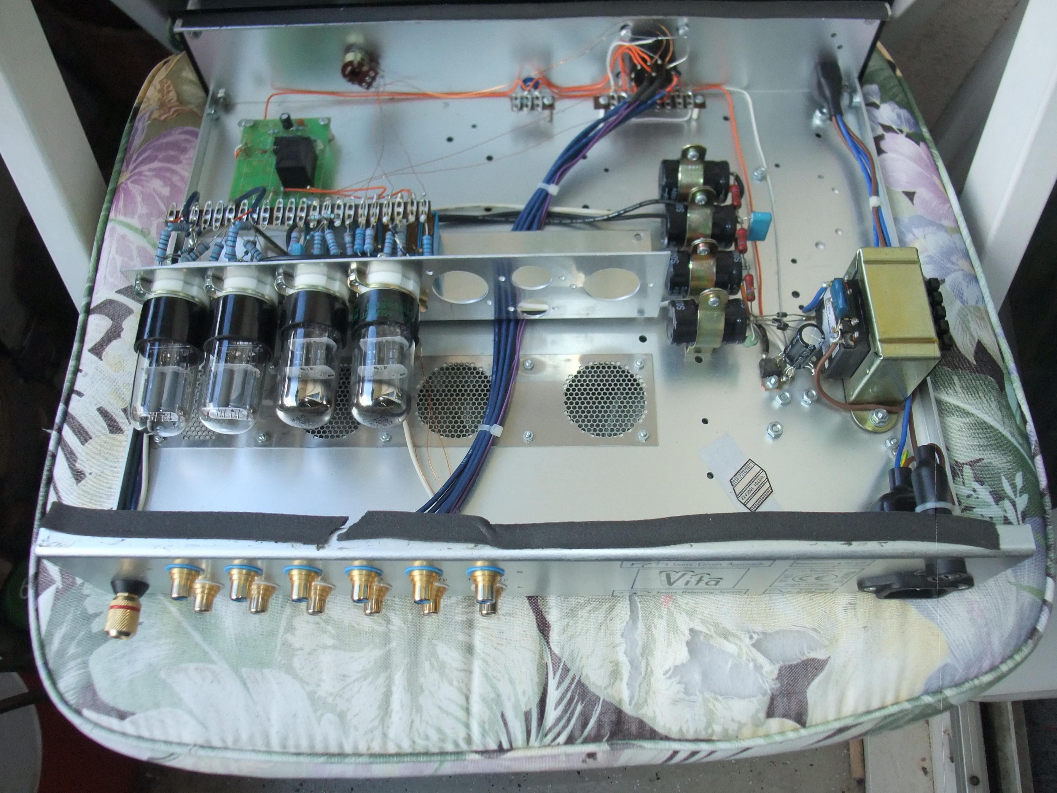

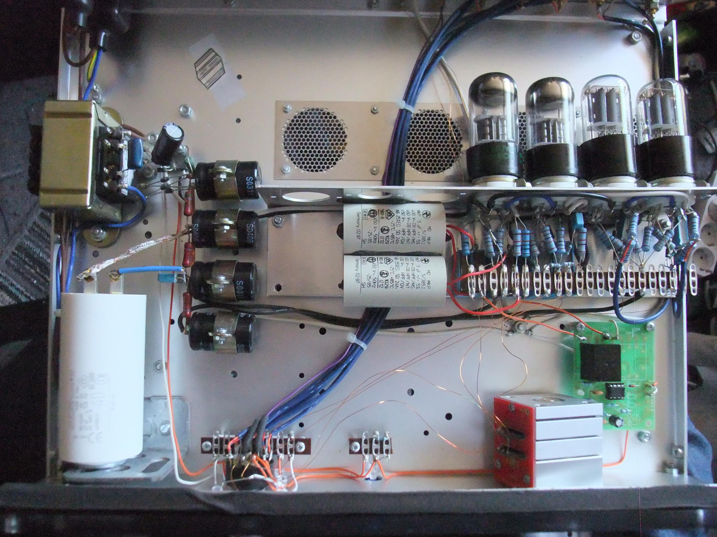

In the attachment sketched schematics which I have create and various images of this pre-amp device.
Follow deficiencies I discovered at first look:
1) No capacitor for input load of connected MM cartridge (phono input)
2) No bypass capacitor at input and no capacitor at whole at output of 12V voltage regulator (go to image No 8, post #2)
I would like to convert the line gain stage into a cathode follower without gain (buffer) and enhance the idle current from 1,4mA to 6-8mA. Is this possible with this tube without reducing life time ?

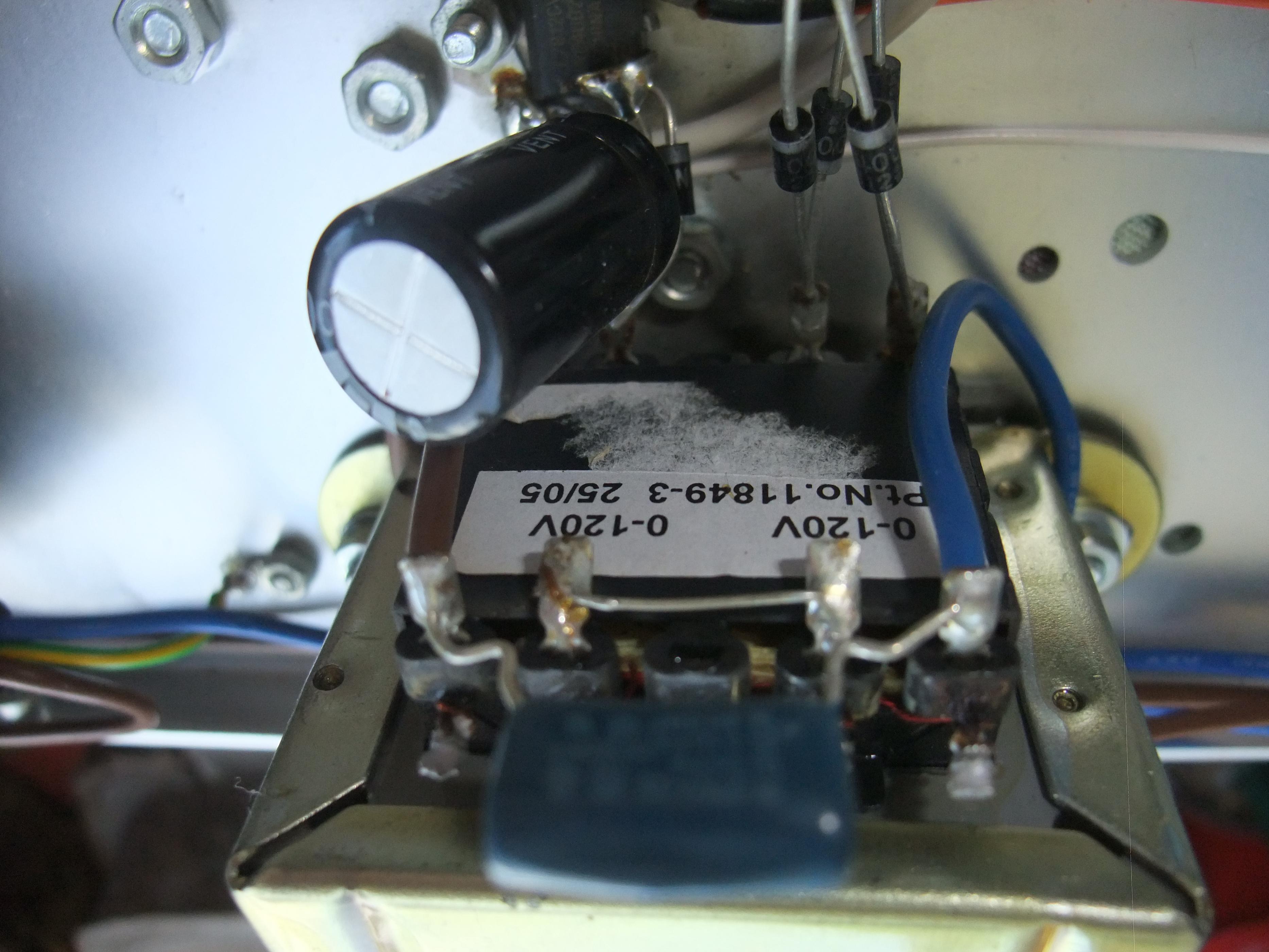

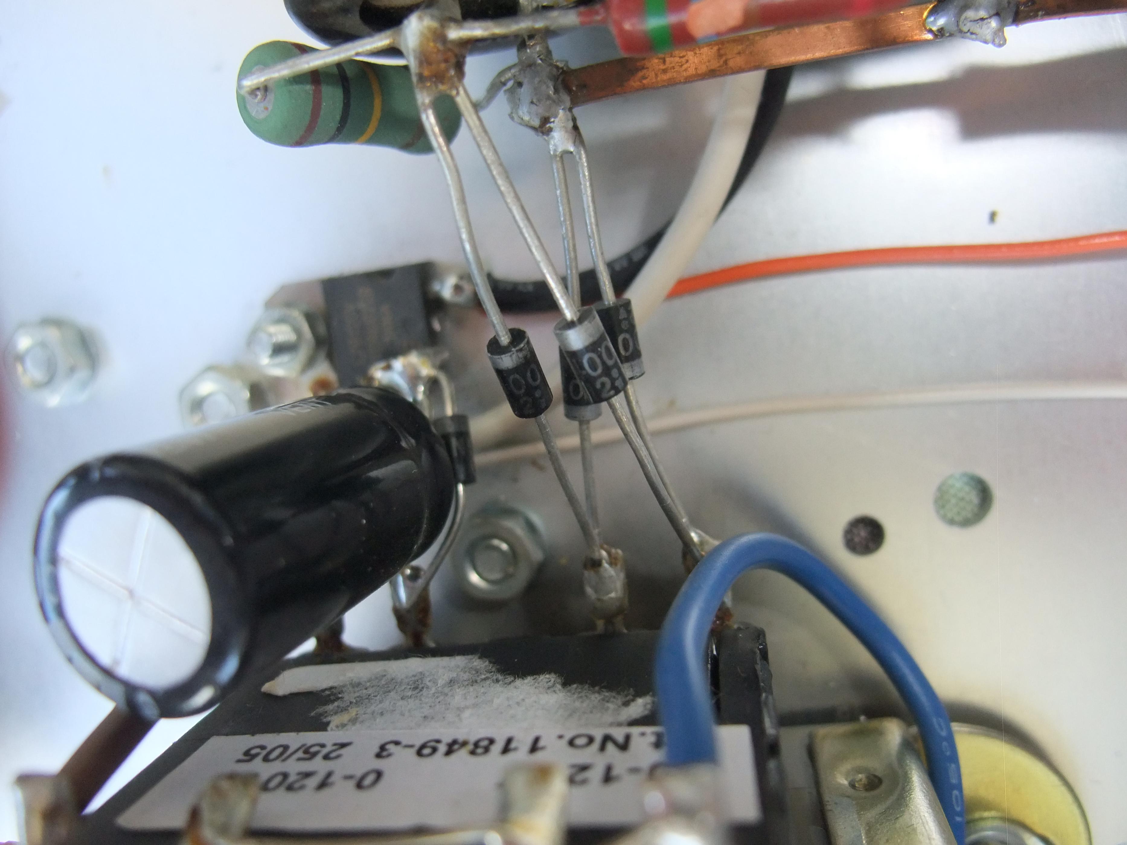

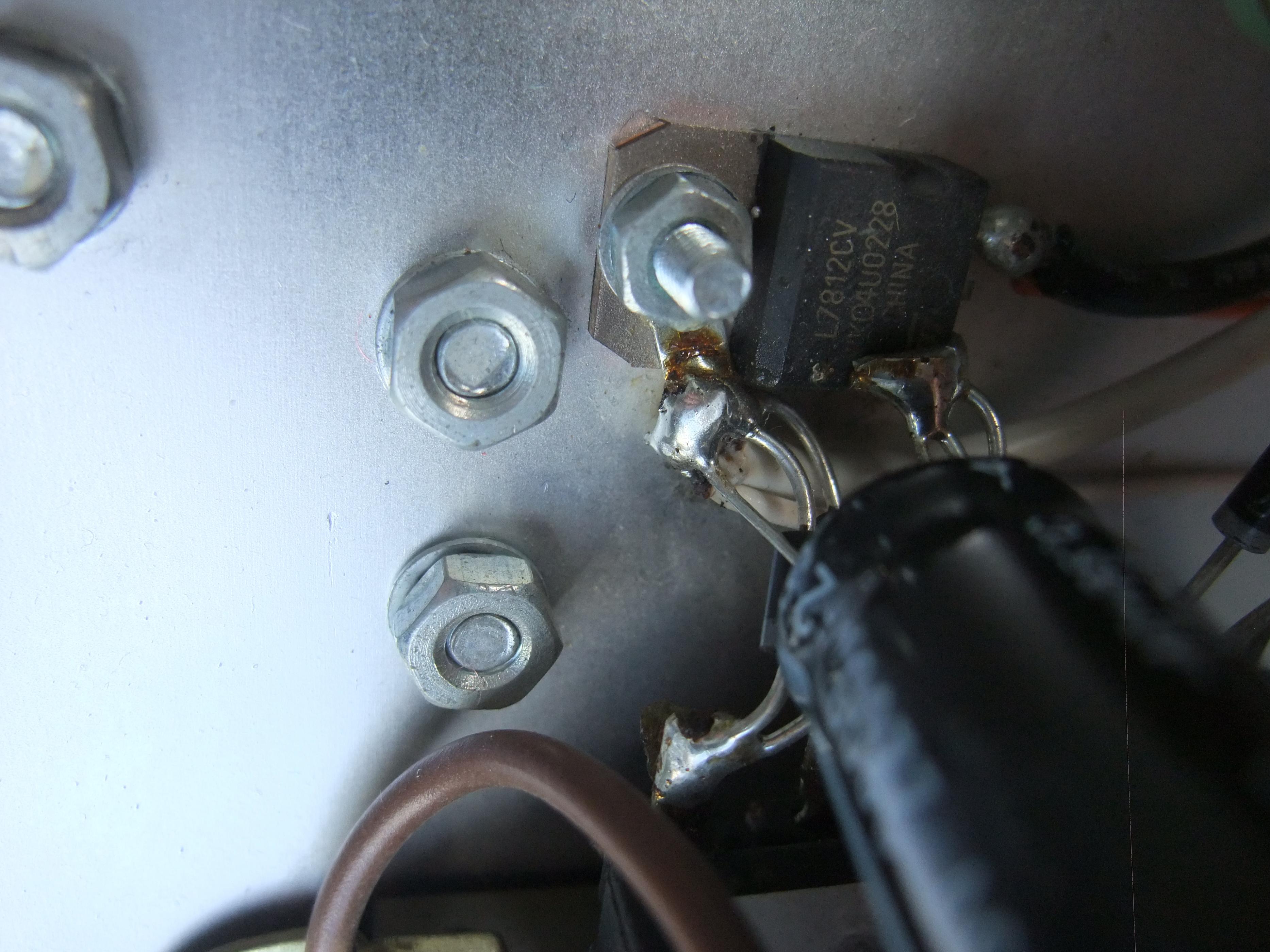

Others more knowledgeable than me may differ, but I don't think 6SL7 makes a good cathode follower. In the circuit above, it is used as an inverting "anode follower" (a little like an op-amp with negative feedback).
In the octal version of the Super Micro A that I have come across, Glen Croft used a 6SN7 for the line stage buffer. If you google "6SN7 cathode follower", you might get a few hits.
Alex
Alex
Yes you are right - this is basically the same different than between ECC83/12AX7 (1mA idle current) and ECC81/12AT7 (for 10 mA).

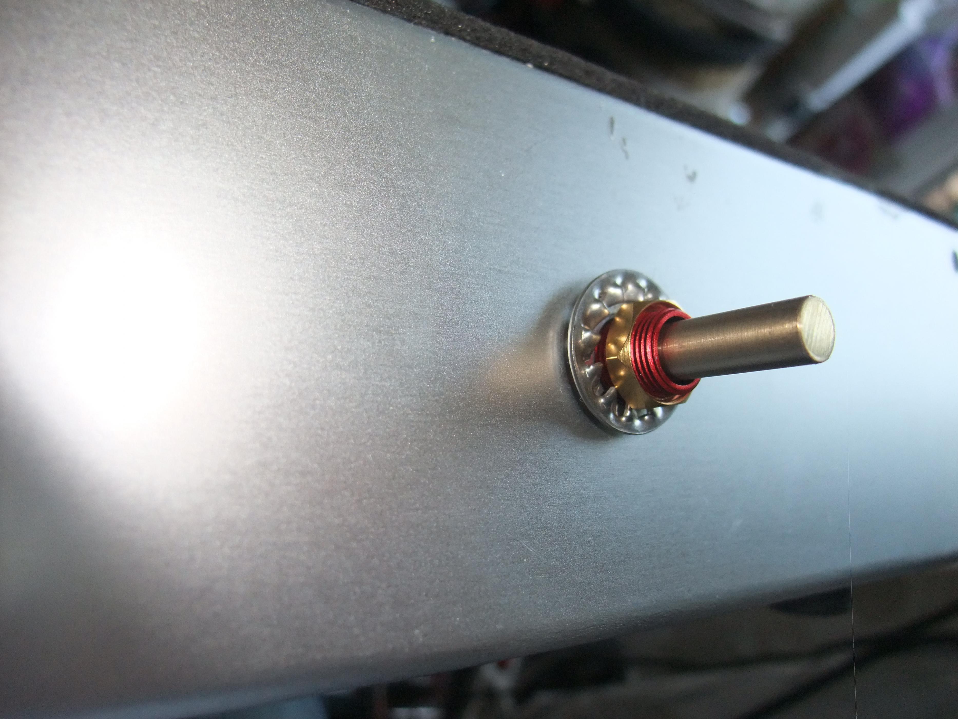

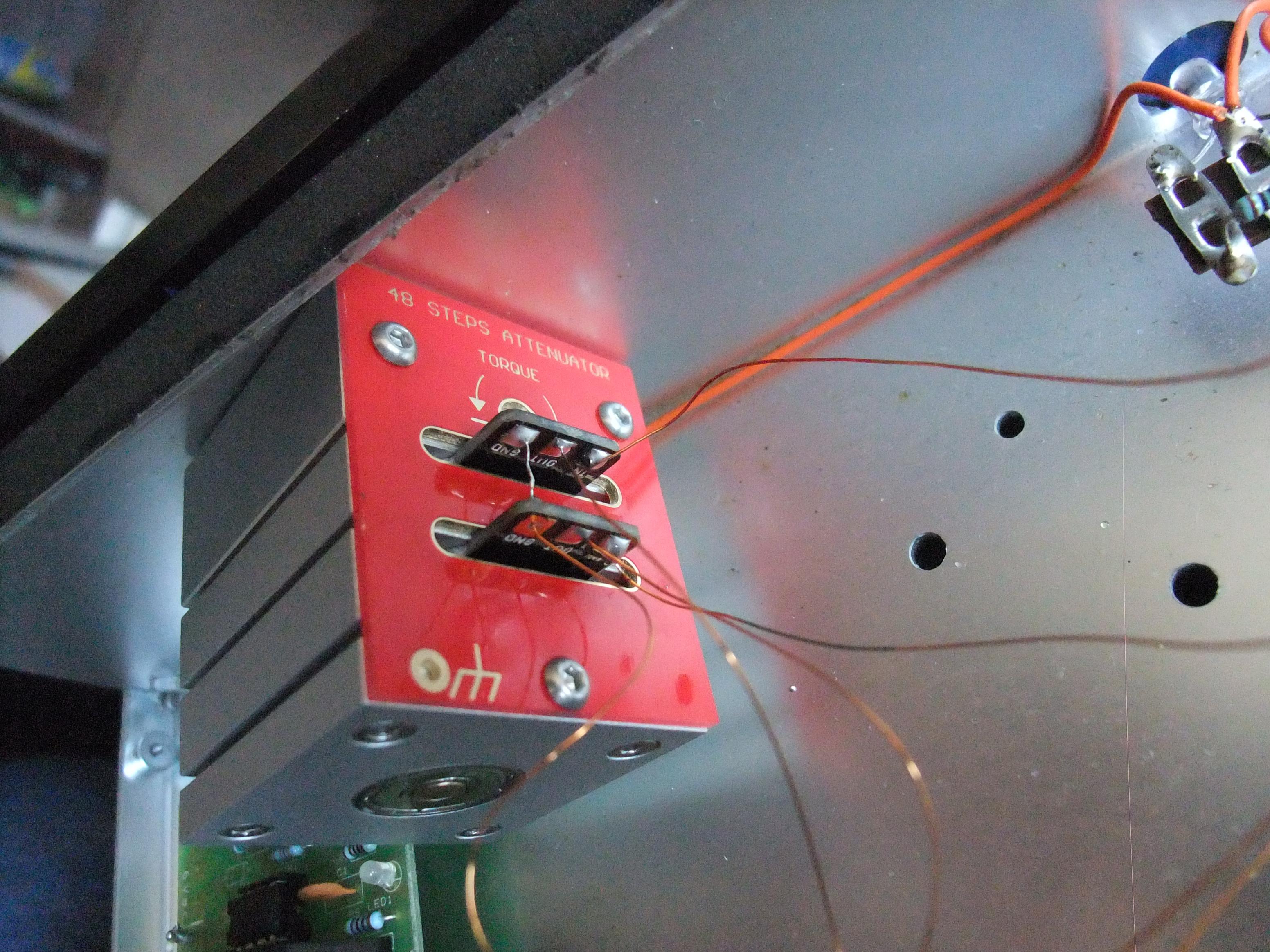

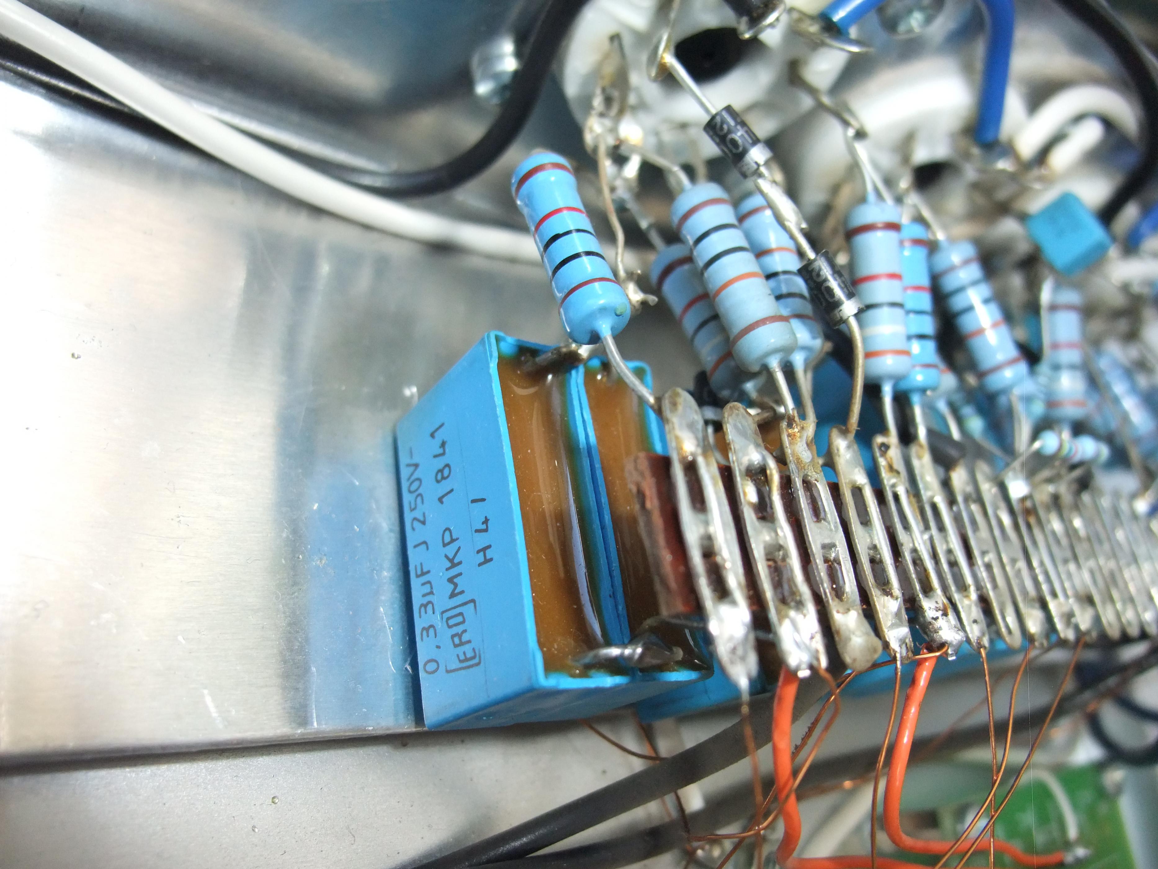

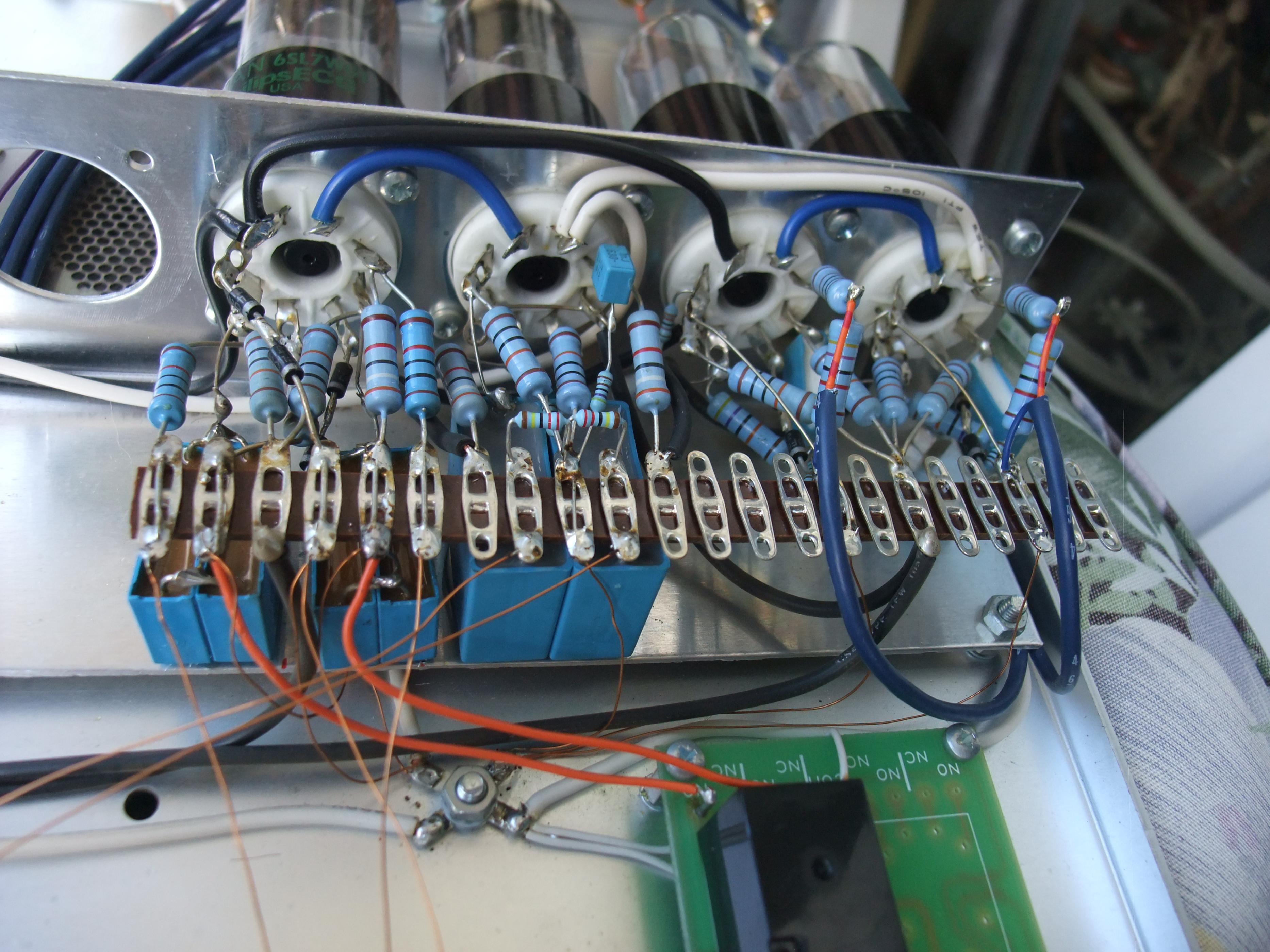

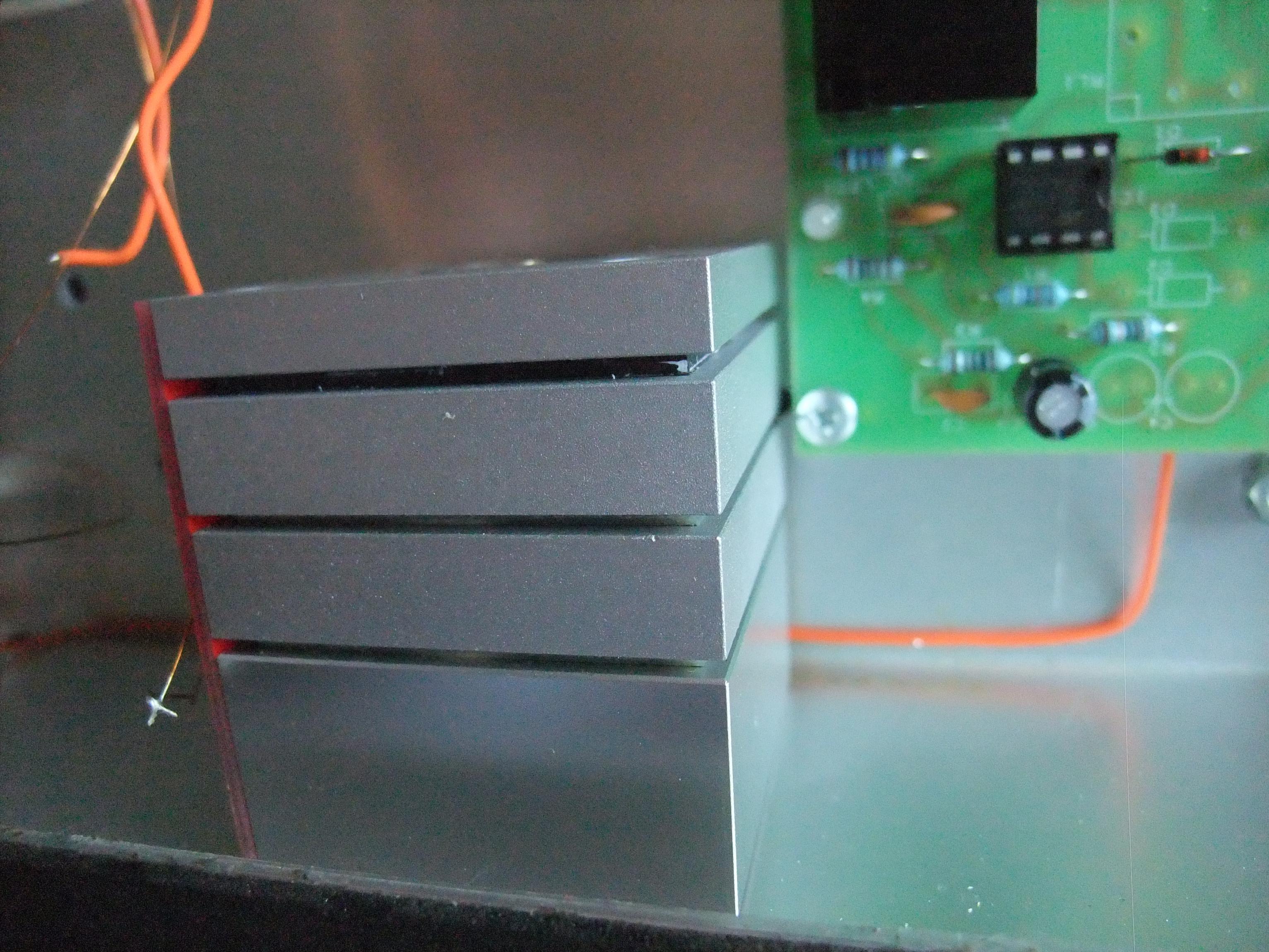

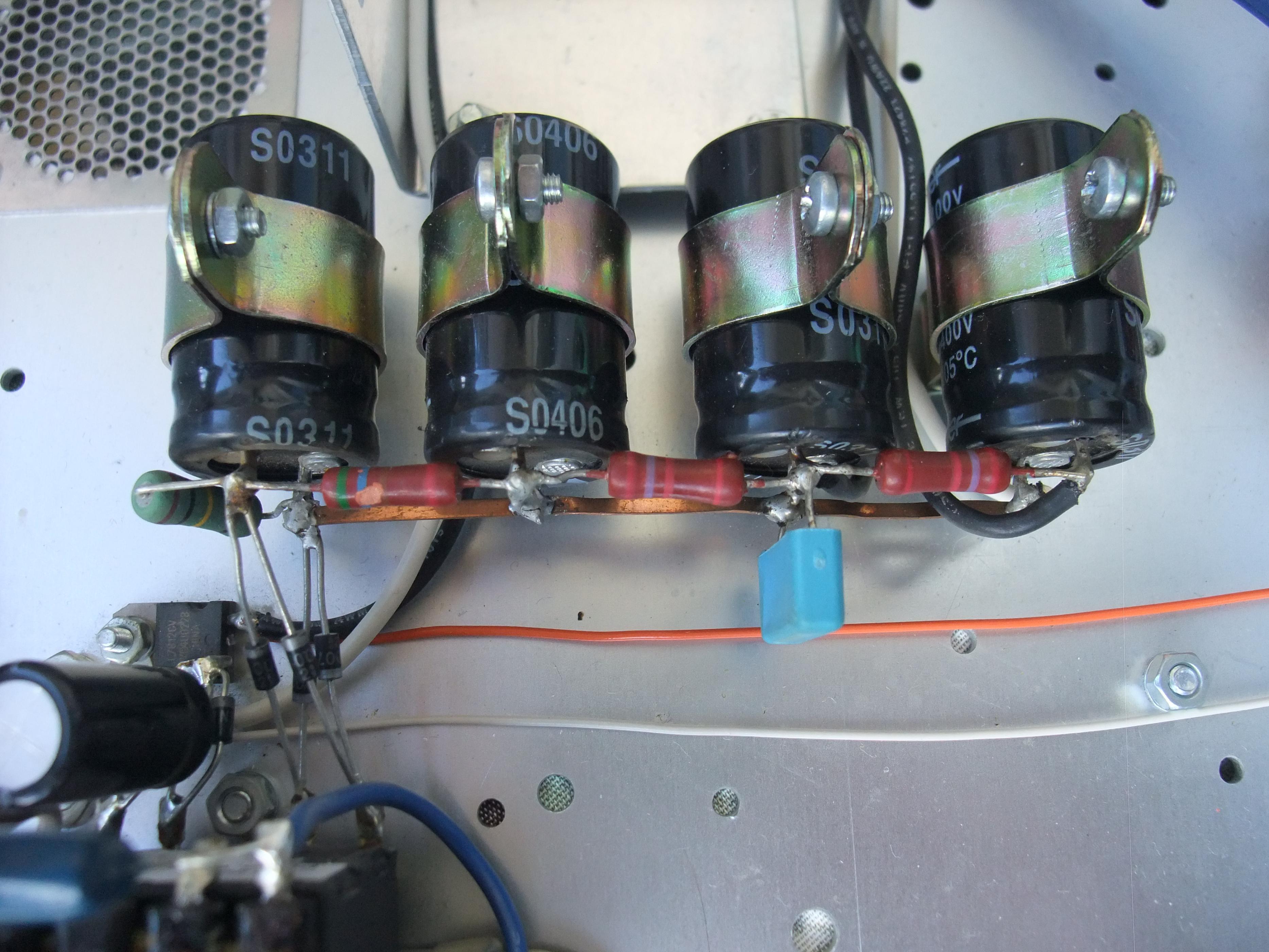

Modifications was realized as in follow:
1) Bypass capacitor (40uF) in parallel to the last electrolytic of the power supply (left in the front of the attached image)
2) Additional MKP capacitors in parallel to the output caps (5uF each - in the middle of the attached image)

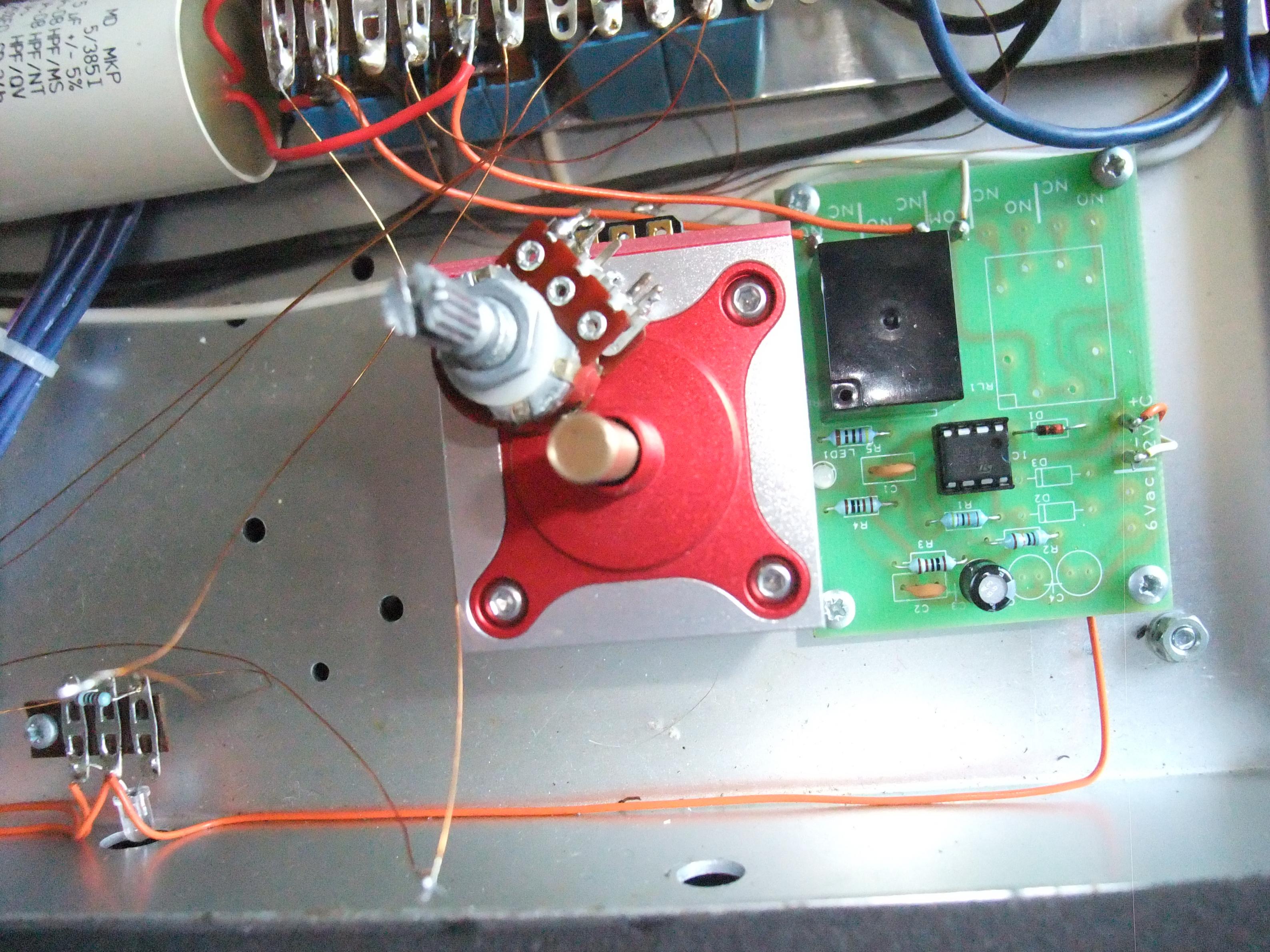

3) Ordinary low cost pot replaced by a Khozmo attenuator - go to the attached images in the follow post

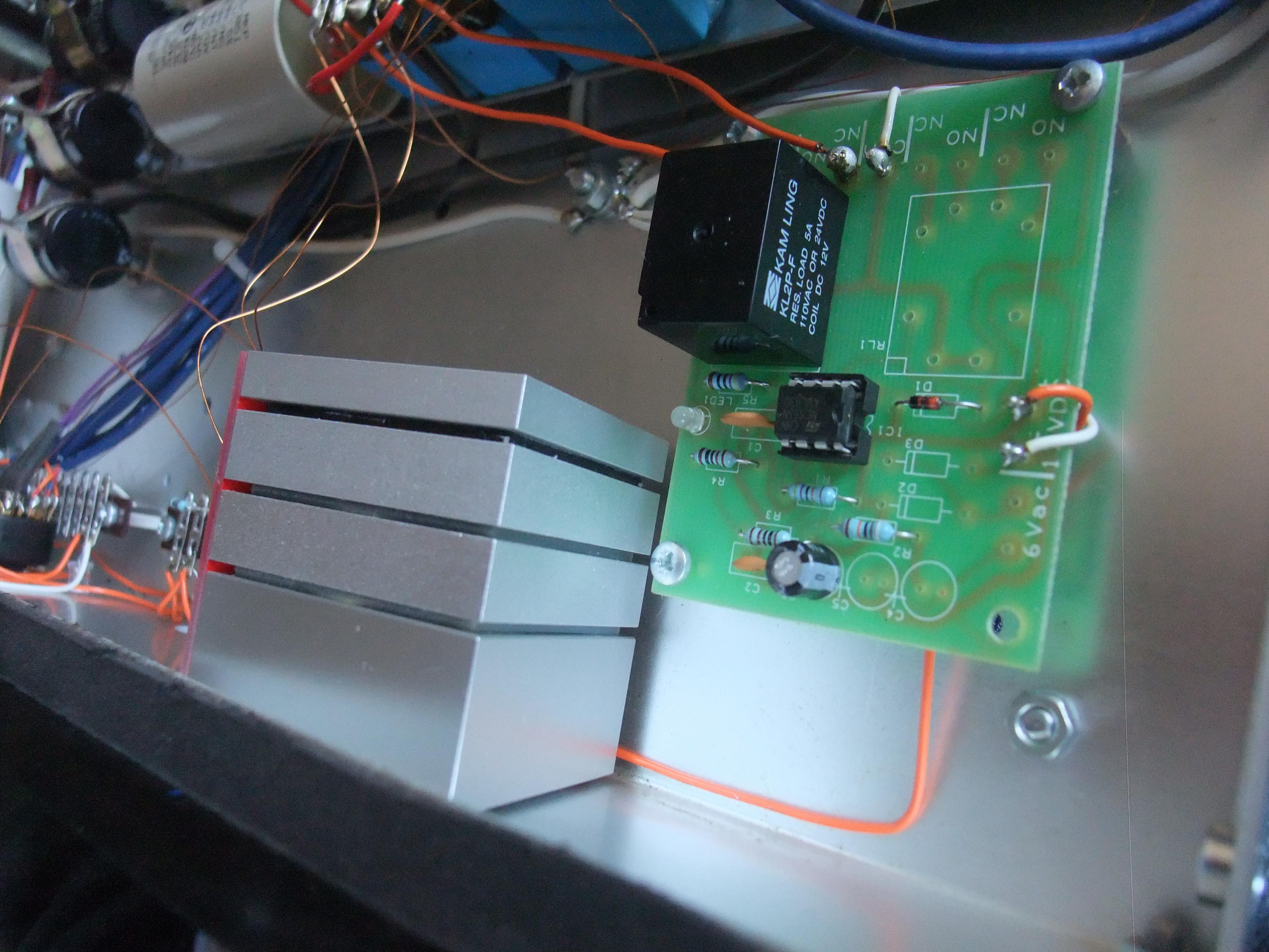

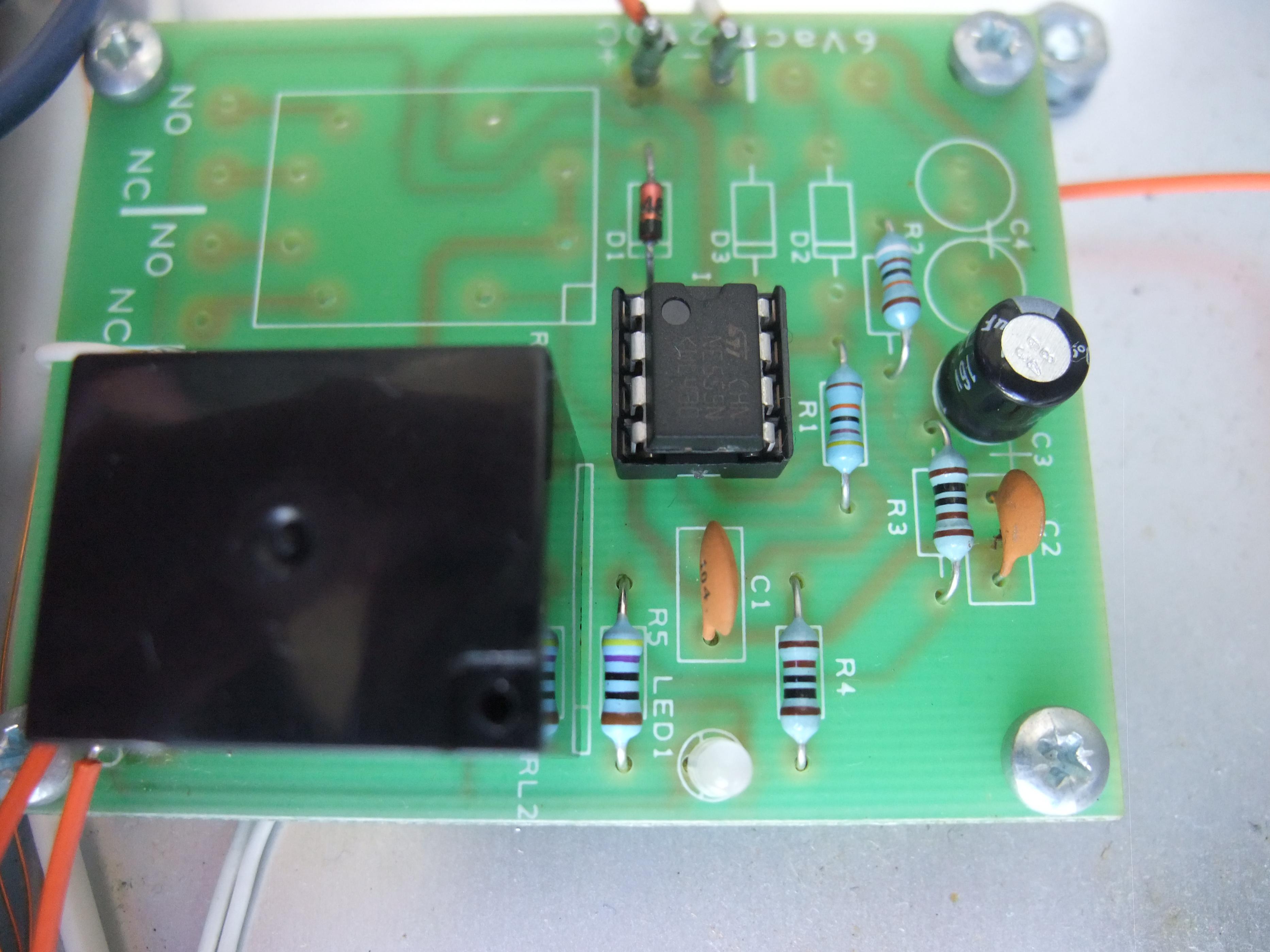

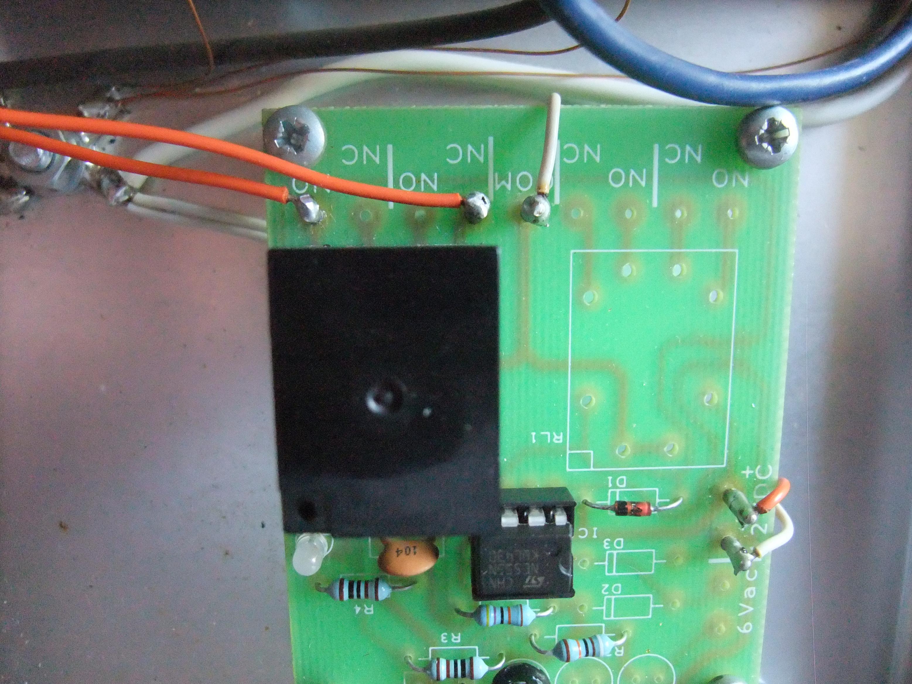

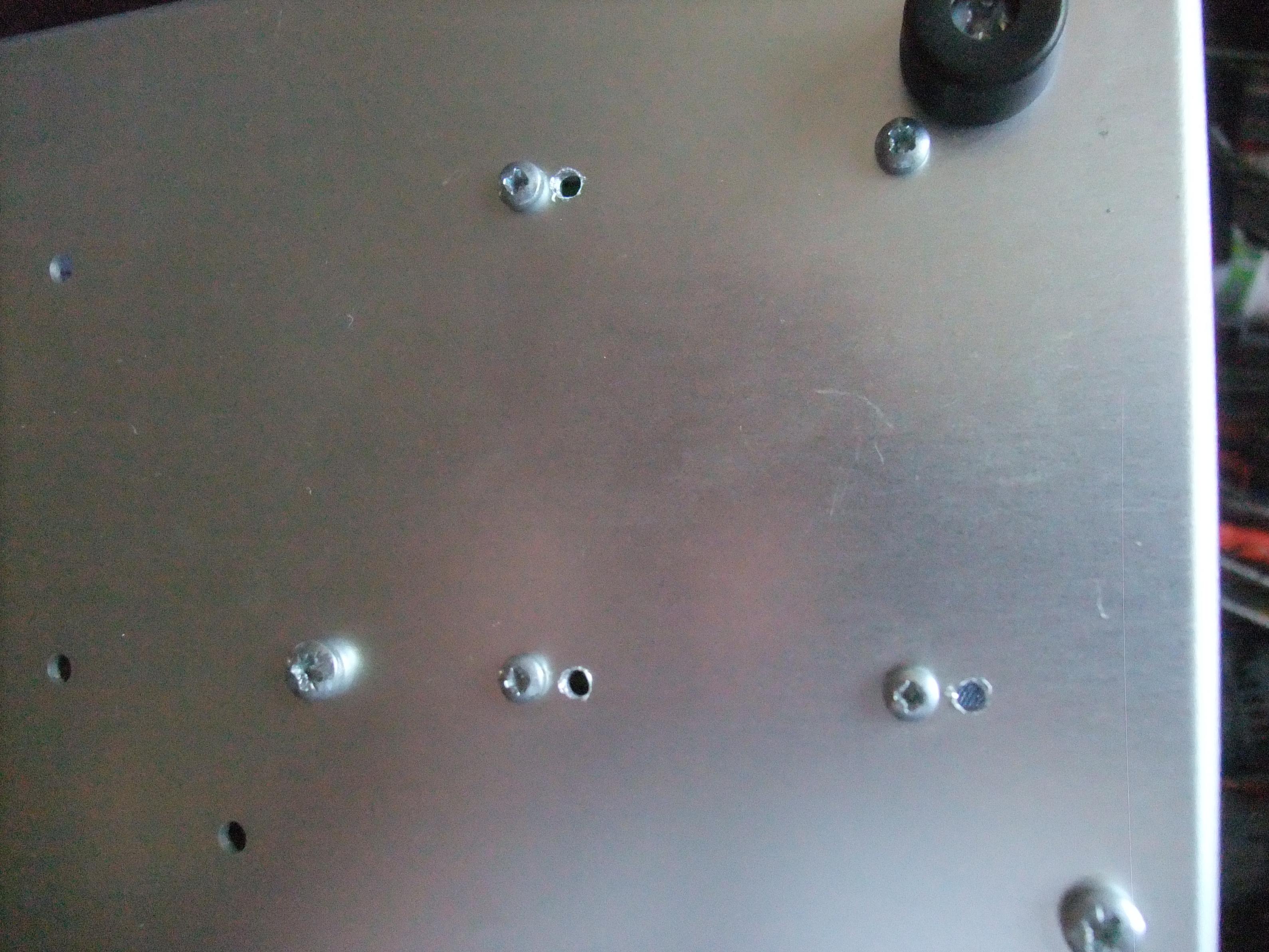

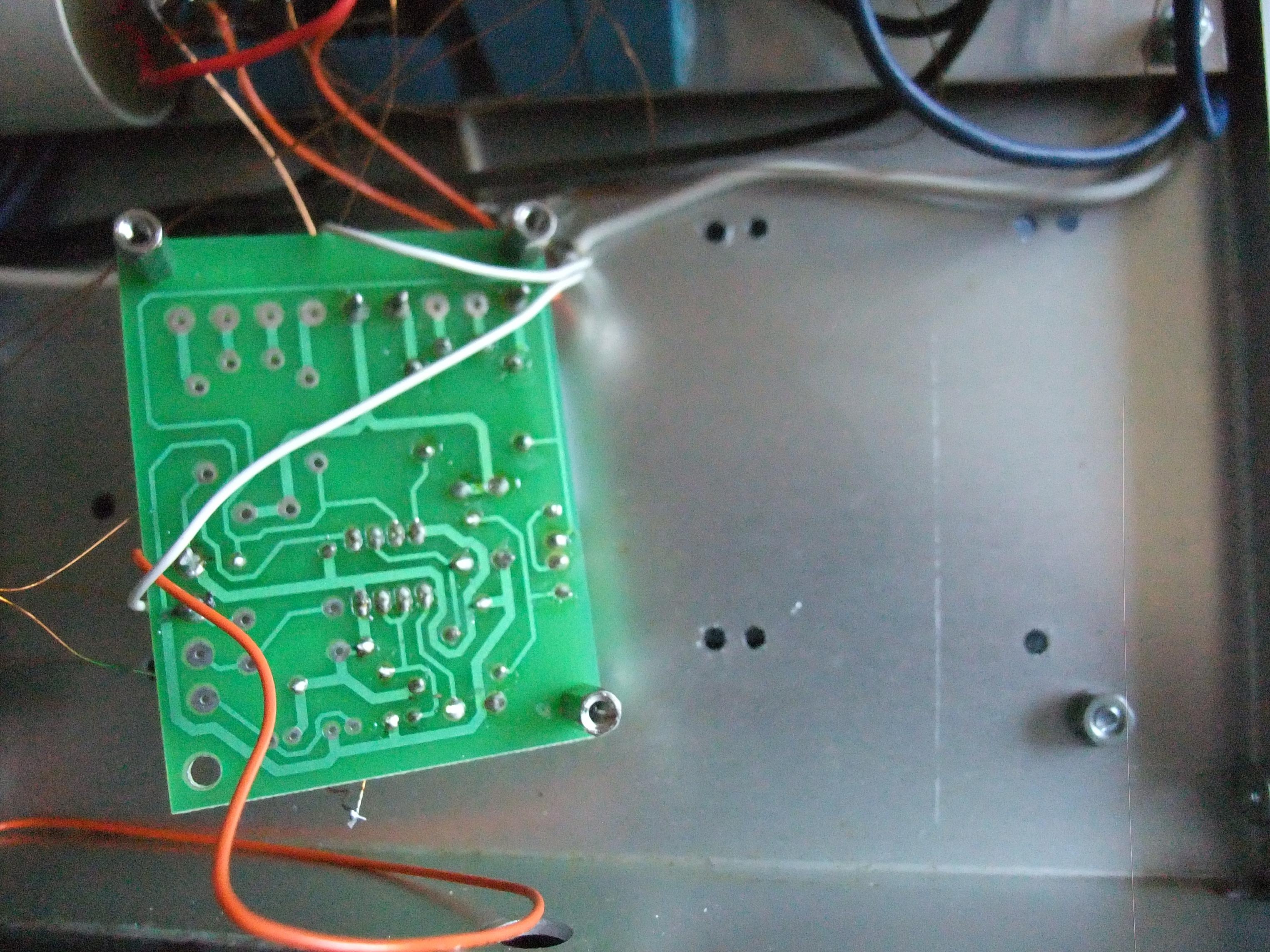

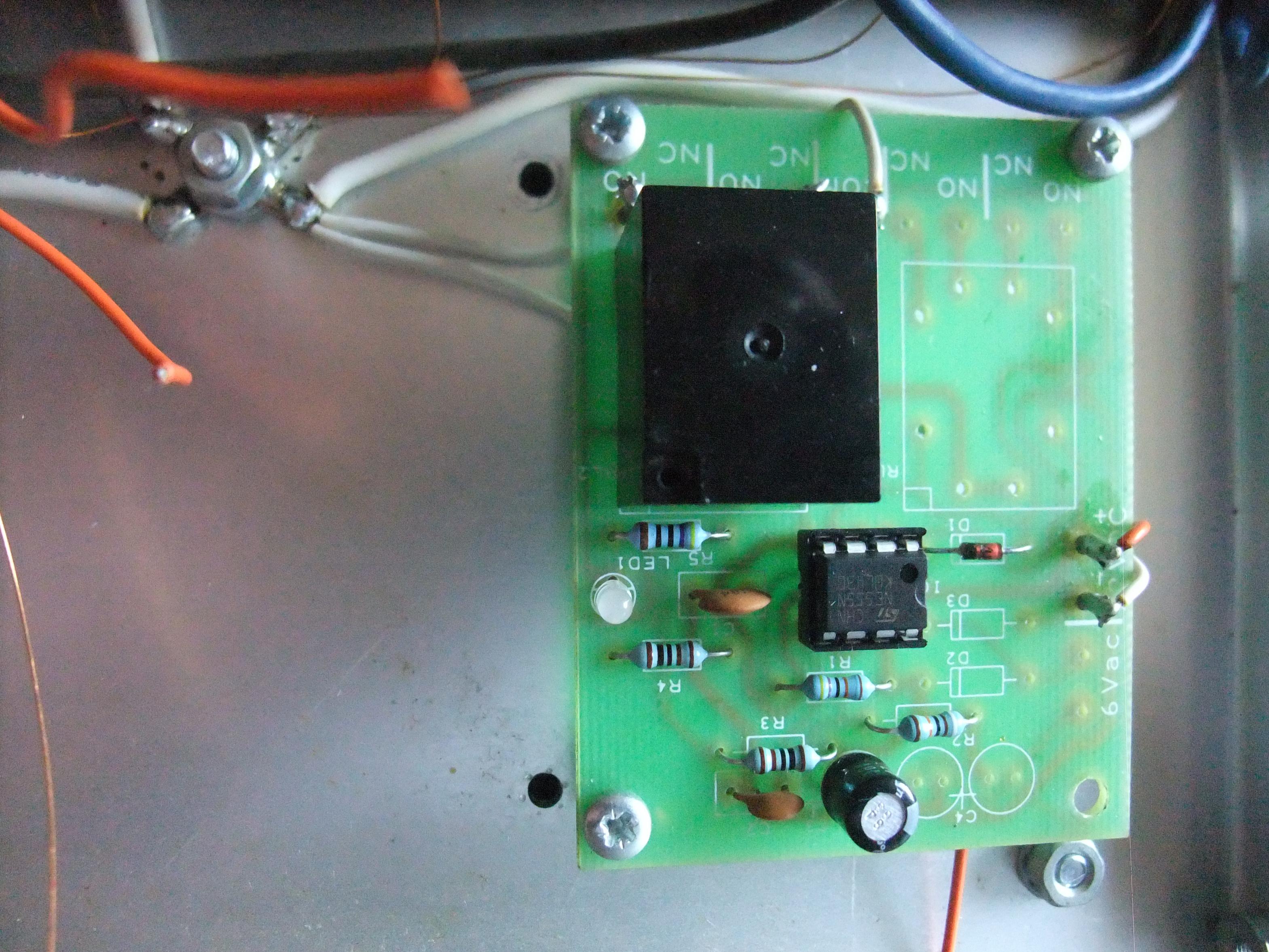

Images concerning the new implemented Khozmo attenuator
