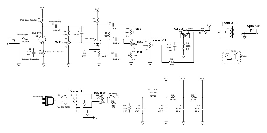

Oh, another question! A 6SL7 is a dual triode, like a 12AX7. Is there something not shown in this schematic about how it's wired, or is this amp simply ignoring one half of it?
And wouldn't it be quite useful to capitalize on that extra side for more gain?
Would it make more sense, assuming I wanted to stick with octal tubes, to use my original 6SQ7 as a preamp and add a 6SL7 for a gain stage (maybe using both sides?) or to simply use the two sides of a 6SL7 for preamp and gain stage, a la a Fender champ did with a 12AX7?
I'd just re-wire that octal socket to use both sides of a dual triode for preamp gain stages...
If you search on 'octal guitar amp' you'll probably get some ideas (?octal fatness, octal madness?)

That is a nice simple circuit.
A guitar amp usually needs more gain than a hi-fi amp designed for CD player or other 'line level' input signals.
100-200mV guitar signal vs 2V.
With a lot of reading over at the AX84 tube project site, and heavy borrowing, I'm thinking about something like this, then, using your octal preamp suggestions.
Lots of tone control, using both sides of a 6SL7 to add gain stage to make up for those losses, simplification of the wiring to the OT. I haven't sat down and calculated all the capacitance and resistance values yet (because I don't quite understand how*), but the wiring should be about right I think.
(* -- My copy of Morgan Jones' Valve Amps book is sitting at my local Post Office, so I'll have some heavy reading to do next week. 🙂 )

One thing I haven't sorted out: Would I benefit from adding some diodes and rectifying the heater circuit and running those filaments DC? Or is that not feasible, possible, or a good idea?
You could make that work. It will be easier to troubleshoot a simpler circuit with just a single volume and tone control, though.With a lot of reading over at the AX84 tube project site, and heavy borrowing, I'm thinking about something like this, then, using your octal preamp suggestions.
I only had a quick look, but the schematic seems to have all the values for caps and resistors. The thing that is missing (which you may find in the discussion threads at AX84) is the voltages for the B+, B+2,preamp plates, HV secondary on the PT, etc.. Usually I've needed to do some 'fine tuning' of the power supply to get something close to 'right' voltages on the tubes. (Remember that Fender specified +/- 20% on values.I haven't sat down and calculated all the capacitance and resistance values yet (because I don't quite understand how*), but the wiring should be about right I think.

Some guitar amps use DC for the heaters (or the preamp tube heaters) but I wouldn't bother. Lots (millions?) of decent amps have been built with AC heaters.
You can always do DC heaters later if you are trying to solve a hum problem (though even then DC heaters wouldn't be at the top of my list).

Yes, they are listed on the AX84 P1 schematic, but I don't know that they'd be at all accurate for my PT. That's part of what I meant by trying to calculate the values before I buy parts ... once I learn how. 😱 I'm guessing that once I calculate (or measure, more likely) what actual raw B+ voltage I'm getting, I'll then be able to figure out what values all the caps and resistors should be along the way, both for setting the B+1, 2, and 3 voltages, and for proper biasing each tube. Might want to add one of those tiny trim pots to each of the bias resistors to make that easily adjustable, but I don't know how important that would be.I only had a quick look, but the schematic seems to have all the values for caps and resistors. The thing that is missing (which you may find in the discussion threads at AX84) is the voltages for the B+, B+2,preamp plates, HV secondary on the PT, etc.. Usually I've needed to do some 'fine tuning' of the power supply to get something close to 'right' voltages on the tubes. (Remember that Fender specified +/- 20% on values.
In the original Capehart-Farnsworth schematic (that my PT and rectifier are taken out of), the 6X5-GT filament is wired in parallel with all the other heater filaments, right off of a leg of the heater secondary winding. That gives me 6.9V, measured on the bench with no load.Your rectifier tube wiring will be different (5V heater).
Checking the data sheets for the 6V6, 6X5, and 6SL7 they all want 6.3V and if wired in parallel the total resistance should be 4.667 ohms. I don't measure resistances that high on the 6V6 and 6X5 I have here, but not astronomically off.
Is there something I'm missing about this, that I couldn't just wire the heaters of these three tubes in parallel, like C-F did?

With the TMB tone stack and the master volume knob, I have a feeling you will need both gain stages. They really suck the signal.

Yes, you'll be using the 6V heater string- no problem the way the C-F was wired.
🙂 Not a worry! It was a good test to help me see if I'm really starting to understand any of this stuff yet.Please ignore that reference to a 5V heater - I wasn't paying attention.
Great! I think I will make one change, though in that instead of running them the way C-F did, with a single hot wire to one leg of the filament and ground the other pin to the chassis, I'll feed them with twisted pairs to cut down on noise.Yes, you'll be using the 6V heater string- no problem the way the C-F was wired.

I had good luck using a 500 ohm pot across the heater voltage. The wiper went to ground. Then you adjust the pot for minimum hum.
A lot of amps use a center tapped filament winding and then ground the center tap. That is better than tying one end to ground. If the center of the heater voltage is grounded then you have one end of the heater going + and the other end going -, so they tend to cancel out. If you tie one end to ground then the other end is all signal to get coupled into the cathode.
