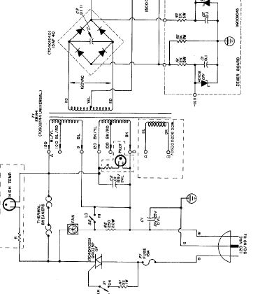

Soft start - I'm thoroughly convinced now that the best soft start circuit is one that doesn't connects the AC power until the AC line crosses the zero point.
I've been repairing/refurbishing a commercial 800 watt class A/B audio amp with a 40lb transformer that develops +/-80v rails. It had some catastrophic event that took out most of the top side transistors as well as a half dozen components earlier in the chain. Anyway, This amp uses a triac module to deliver line voltage controlled at a lower current by the main power switch. The power switch closes and supplies the gate of the triac with enough voltage to turn it on. Triacs don't turn on until the V crosses zero. Voila!, instead of shocking your system with an almost infinite DV/DT at the peak of the cycle, the transformer gets connected to the line when it's close to zero volts. The event had taken out the triac BTW such that it went short circuit so the effect was, when you closed the power switch it didn't matter where in the ac cycle the transformer got connected. Under this circumstance the overhead lights in my lab would blink! After replacing the triac the lights no longer blink.
The circuit is simple, ie the power switch delivers AC to the gate via a 25ohm 1/2w resistor. The switch also directly connects to one of the triac anode/cathodes. The other anode/cathode connects to the transformer. So the triac also allows the use of a smaller power switch since it will never connect at the peak.
It's a very cheap soft start.

Here's the schematic. Note the components just after the power switch.
I have a bench sander that often starts with a jolt but some times it doesn't because I've hit the manual switch at the zero crossing. The jolt is bad! - big inertial load on the motor, ie the sanding disk. It often jars loose the disk securing screw. I plan to add one of these triacs.
I may have read it all wrong, but that triac seems to be triggered to conduct anywhere in a cycle but +/-1.5V about zero crossing, at the moment the power switch closes the gate circuit.
It seems to me the purpose of using a triac is all for the longevity of the power switch by subjecting its contact to nothing more than a small gate triggering current. That circuit, on the other hand, does have the benefit of turning off at load current zero crossing when the power switch opens the gate circuit.
Please correct me if I missed it.
Well unfortunately the magnetizing current is 90° off the voltage and highest when there is a 0-crossing.
It is also that swiching on, the Xformer can saturate and create additionally a considerable current spike in the primary only limited by the DC resistance.
This happens also without load because the inrush current is double when the core is not magnetized.
The magnetizing current is then constant, flowing back and forth 90° and superimposed to the load current.

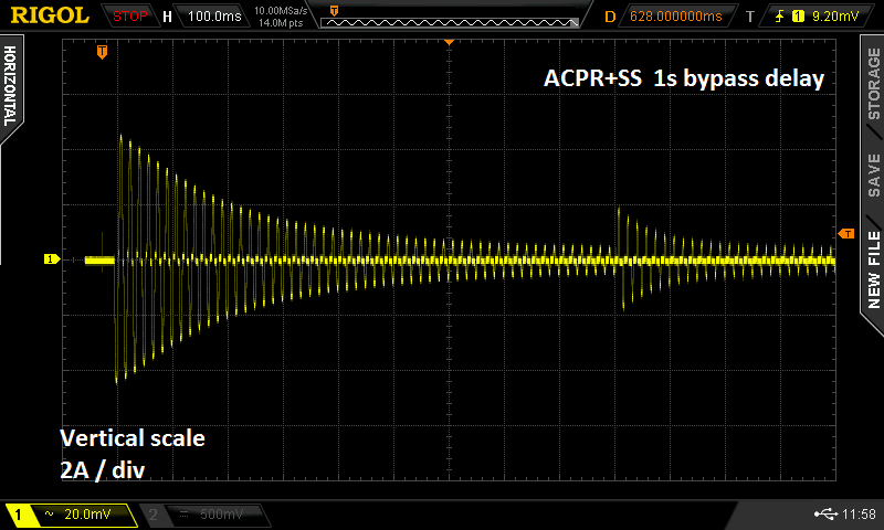

Several "soft start" PCB designs here on diyAudio, include a user selectable delay-before-bypass. Usually the options are 0.5 sec, 1.0 sec, 2.0 sec ; and usually they are chosen with pin jumpers (which are cheaper and physically smaller than DIP switches). Here's an example of a soft start circuit in action, feeding a stereo LM3886 chipamp whose power supply is the stock, standard diyAudio Universal PSU board, plus a 300VA Antek toroidal transformer ("AS3222").
AC mains current is limited to a peak inrush value of 4.5 amperes: two and a quarter vertical divisions on the scope. Then the (current limited) transformer + rectifier circuit sloooowly charges up the PSU filter capacitors. Finally, bypass mode shorts out the current limiter after 1 second. At the instant when bypass is enabled, mains current jumps, slightly, but is still comfortably below the inrush peak.
Naturally you get an even more benign transient when you select the bypass delay option to be 2 seconds instead of 1 second.
