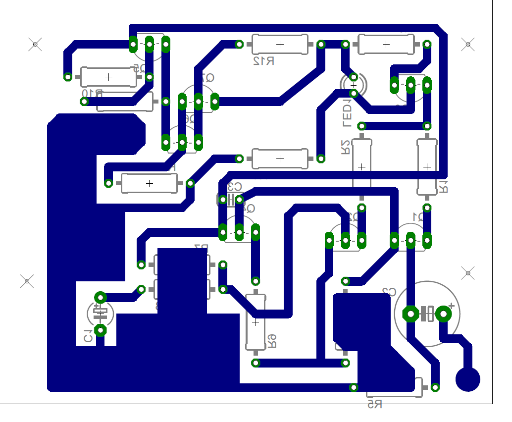

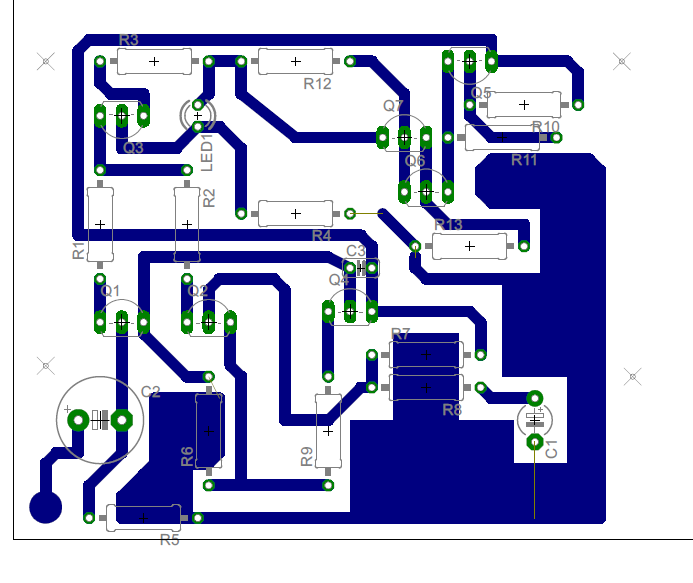

Critique my first PCB routing attempt

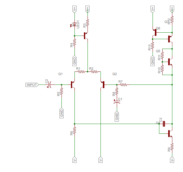

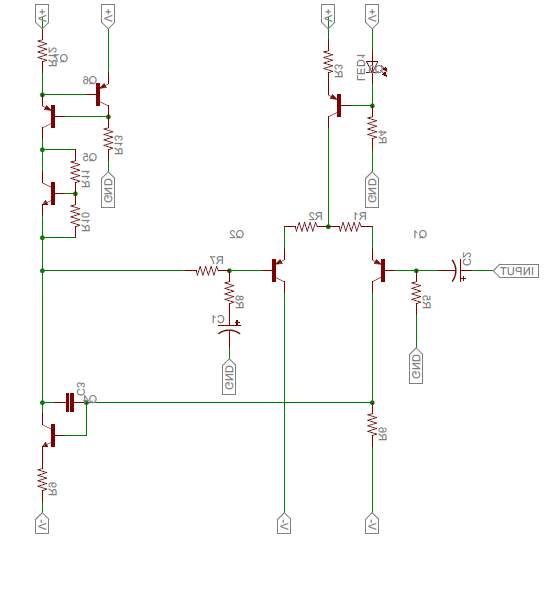

I created the schematic for the front end of a very simple amp for the purpose of practicing hand routing PCBs. I doubt I will etch this.
Please critique my attempt. My main trouble is that I wanted the rails to be in close proximity, and more "deliberate" looking. I probably would have fattened up the rail traces if I had been happy with their placement. I think the ground plane is ugly too.
Any thoughts?
I also just realized that in some cases the ground plane obscures the components. This happened somehow when I printed to the .pdf, as it looks right in the Eagle editor. Doesn't really matter in the end, as I would only print the copper for home etching.

Hi Dan Moos,
A good start. Just a couple of comments.
On the schematic:
Do a Tools > ERC, fix issues.
Check V+ on R3 and R12. There is a wire overlap and it may not be connected to V+. Drag V+ and check the wire rubber bands.
Fix positioning of component labels especially the transistors.
No output terminal.
It is a little unusual they way you have represented your rails.
On the PCB:
Do a tools > DRC, fix issues.
All traces should be mitred 45 degrees, you missed some.
A few missing traces at C1, R13 and R4.
What size are the resistors? They look a little big.
Ground planes are created by using the polygon command. Create a polygon (on the trace layer) matching the PCB border. Using the Name command, name the polygon the same as the ground net. Use the Ratsnest command to fill the polygon.
Use a vector font on the PCB. Options > User interface > Persistent in this drawing.

Thanks for the info!
I didn't know the method for filling a polygon. Thanks. My ground plane is a mix of squares and lines.
As for the schematic, it is a quick partial transcription of a schematic I did in LTSpice, and not intended to be "functional" per se. That said, I did miss what you noticed.
The rails were an attempt at learning the "name" command. O the ltspice schematic, they are done the usual way.

What I am most curious about is what you think about my component placement and routing decisions, particularly the rails.
@ilmzn:
Care to expound on the use of ground planes? I had wanted it to be more "pervasive" throughout the board, but it ended up just on one end. My understanding is a ground plane needs to create as little impedance between the components and the final start point. In that regard I thought I did ok, but maybe I didn't do this right.
The other thing I understand ground planes are for is to provide some emf shielding. I am certain that having my plane only in one quadrant of the board doesn't accomplish this at all. Any thoughts on how to get the plane to "reach" more of the board? I kept getting pinned in corners.
About the holes. Why exactly do I need to etch them? Is there a reason I can't just drill through the copper in the middle of the pads? There must be a reason, because everyone does it. I can't just leave a minimal hole just to aim the drill with?
