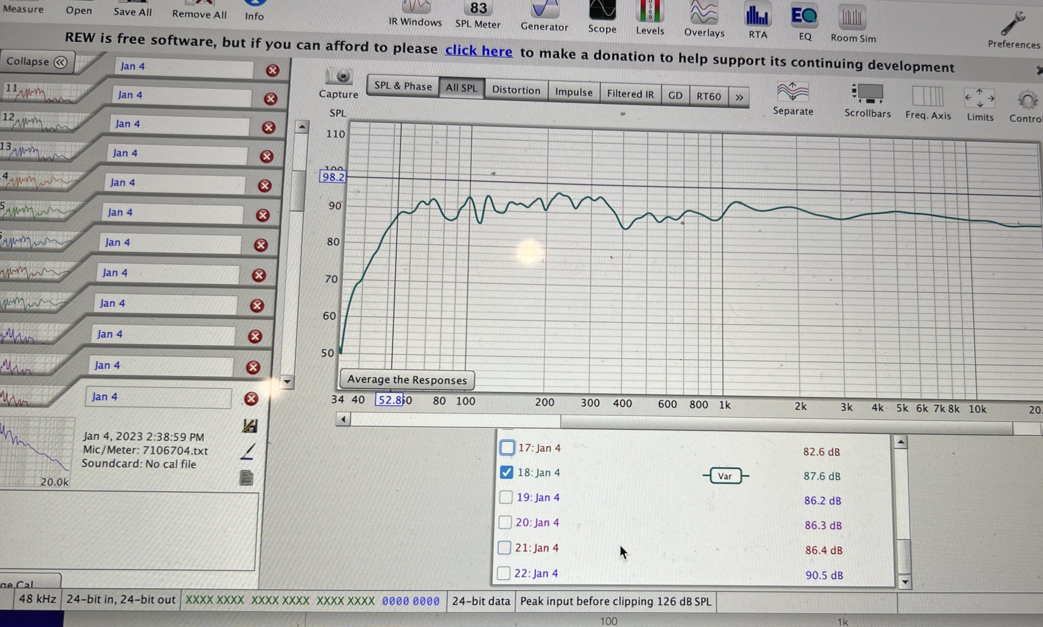

Critique my build! 15" 3 Way PA Loudspeaker
Good effort. I personally would cut the 1khz to 2khz by 3db, and 150 to 350 by 3db.
Are you sure there isnt a protective high pass filter set on your xover unit? Because it looks like it needs a serious low end boost currently about -4 or -5db at 50hz dropping further to about -20 at 40hz. This would be bad for modern techno or drum and bass. That said if you don't listen to that or anything with deep bass it would probably be fine.

Right that explains the drop off. That's one main problem with the DCX: running out of CPU. But that is just 2 wide-ish parametric EQs it shouldn't add had much. If nothing else just do the 1 to 2 khz one it will sweeten the sound a lot.

Heres the comparison between mic straight on and mic at 40 degrees, interesting things happening, what does this test illustrate?

Ok got outside and did left and right solo, then tested in stereo. It caused a pretty wild change in stereo on the highs, is this phase cancellation? How do I correct for this?

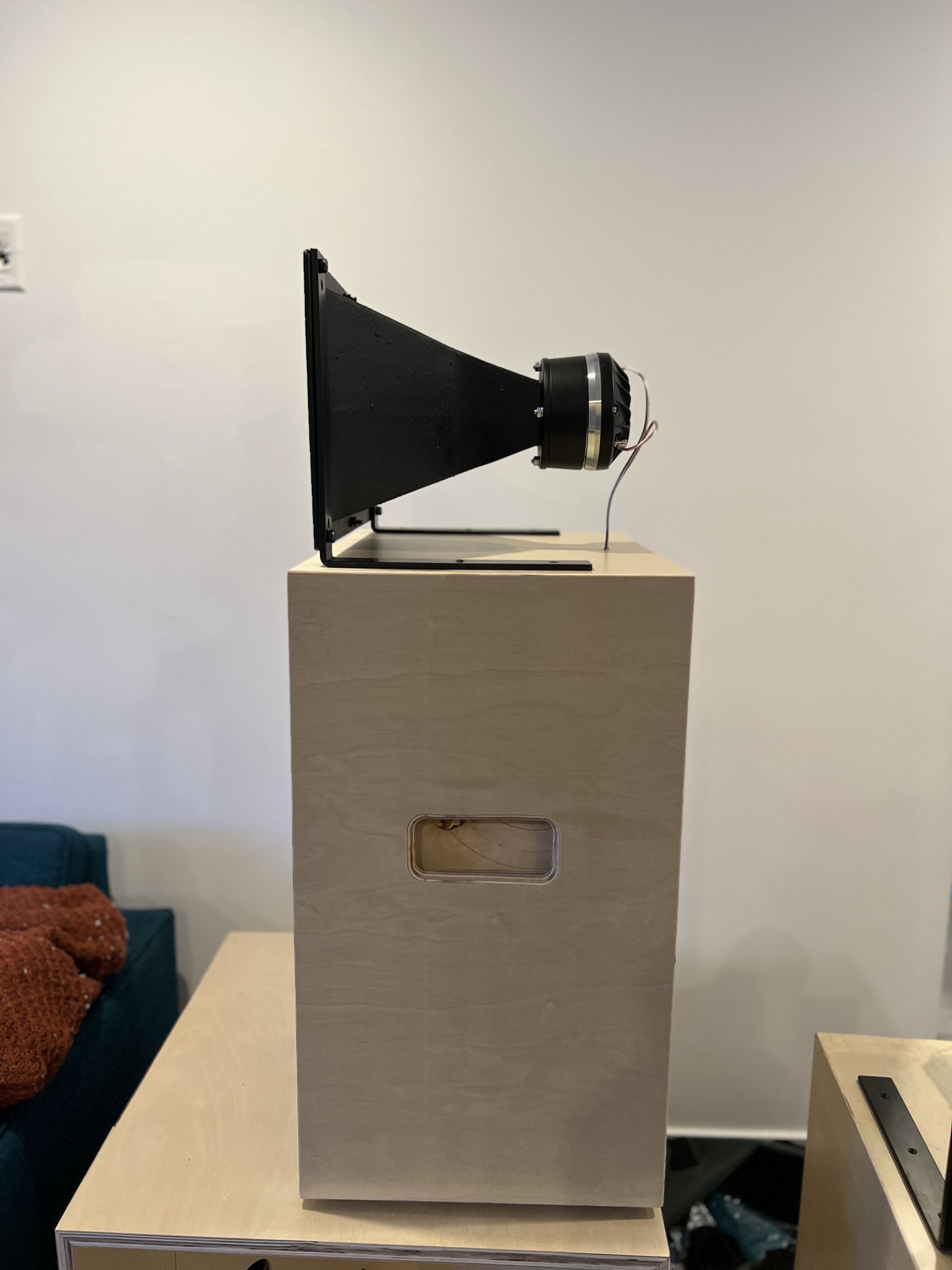

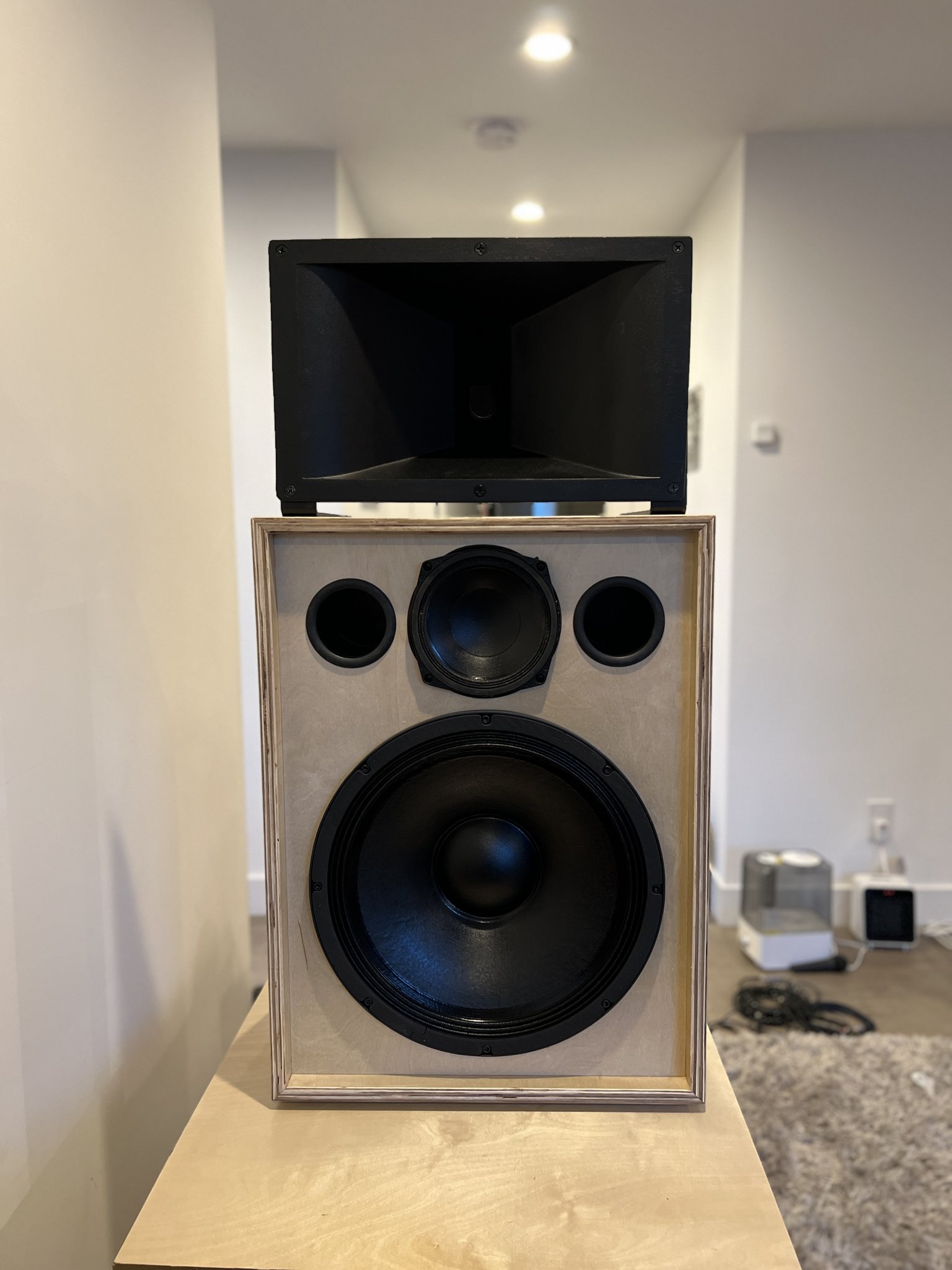

Hello Soundmind
you made some interesting choices regarding the drivers.
With a 6" mid driver I would prefer as HF an 1" driver, because it will easily handle a 4k crossover and behaves nicer above 10k than your 2" driver with the 4" diaphragm.
Your HF driver is optimized for below 1k crossovers.
But since you have this Mid-High driver already, at least find a different horn, because the ME75 design is very outdated.
It has this old school diffraction slot which causes a lot of problems in the vertical direction above 8k.
The ME75 also looses pattern control down low in the vertical axis like most rectangular horns, which causes problems when trying to cross over below 2k.
The problem with finding a better 2" horn: these have gone out of fashion, so I would try to remove the adapter ring on top of the driver ( there should be screws underneath the sealing foam ) and if you are lucky, the remaining exit is 1.4".
For this exit size there are way more horns on the market available.
A lot of people would recommend the RCF HF950, if you should want to go two-way thereby exploiting the capabilities of the 1095TN.

@URI55 Thank you for this comment this is exactly what I was looking for when I posted this on this forum. I have learned a lot about matching the power of drivers since making the post. That is why I went with Tri Amp so I did not have to get it right this time, I could just dial them back as needed. I have learned that the CD is overkill and the mid is underpowered.
I was not aware that 1" CD perform better over 10K than 2" drivers that is very good to know. As for swapping out the horn, this design allows for that fairly easily so I am definitely going to look into this and AB test with the ME75. Thanks again!
