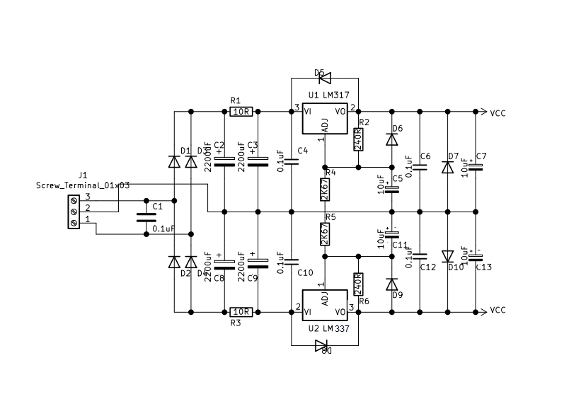

I want to learn more about electronics and the inner workings of audio equipment, so I've been modelling schematics I find online in KiCad.
I have need of a zero-gain buffer, so I've been reading up on preamps and buffer circuits, and have decided I want to build a opamp based buffer first. Something I can build on perfboard.
After that I'd like to move on to designing a PCB for a transistor based buffer like the Nelson Pass B1, but with regulated power supply and maybe some other features.
However I am an absolute noob when it comes to the theoretic side of electronics.
I was wondering if I could get some opinions on these schematics and if I'm heading in the right direction or not.
Is this power supply schematic somewhat overkill for a simple NE5532 buffer?
Any feedback would be greatly appreciated.

As for the power supply, in my experience there's no such thing as overkill 😉. A good power supply will bring out the best in any circuit. Plus if you build that PSU on a seperate perfboard you can use it for subsequent, more demanding projects.

Maybe a bit of overkill on the PSU considering a few milliamps current draw. You could go much simpler with a simple Zener shunt stabilised supply using just a Zener and resistor per rail and do away with the regs.

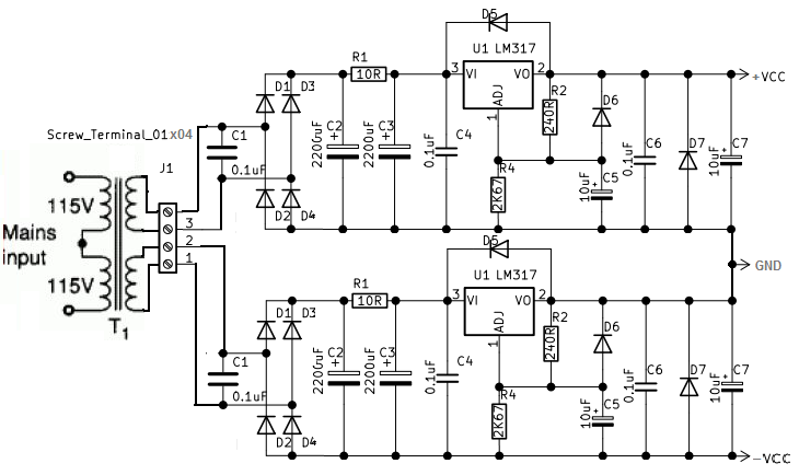

Is your power supply supposed to be a dual rail +- with virtual earth using two LM317's? If so then you cannot do it with a single bridge and center tapped transformer. For that you will need to use an LM317 and an LM337.
If you want to do dual rail with two LM317's you need to use a dual secondary transformer and a separate bridge for each leg.

Yes 337 in the negative side should fix things 😉 It is possible to use two 317's but as I said you have to use a dual secondary transformer and also dual bridges and quite a bit of modification to that circuit.

I guess I'll use a center tapped transformer, but I want to make this schematic as universal as possible.
So if I understand correctly when I use 2 of the same regulators with a shared ground not connected to a transformer, I'd just get 2 positive power outputs?
So the LM317 regulates positive DC where as LM337 regulates negative DC?

Thanks! My mistakes where obvious.
Unless you are using the premium LM 317/337 parts, R2/6 should ideally be 120R instead of 240R. It has to do with the minimum load current required to maintain regulation. In some instances, it won't matter if there is a minimum load >= 10 mA. It is a good practice to use 120 R with the standard spec parts as a rule.

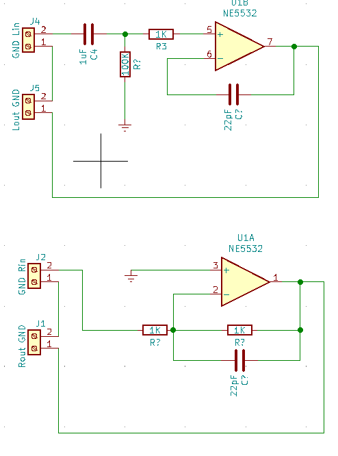

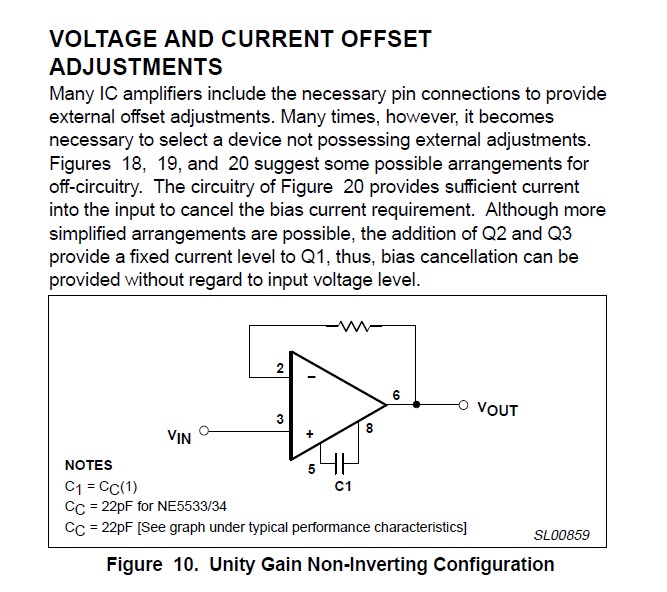

Another question I have is about frequency compensation. I know that the NE5532 has an internal capacitor to do this so it's not necessary. But if I were to use an opamp without internal compensation in unity gain, like the single channel NE5534, it is required to add a 22pF cap externally. I have digged through webpage after webpage, but have not found a definitive answer as to WHERE this compensation capacitor should be placed.
My best guess is this, could someone validate that for me?
Top diagram in non-inverting, and bottom in inverting configuration

The 5534 is a single opamp and brings into use two of the extra pins, pins 5 and 8.
For a unity gain buffer with the 5532 it is not needed and in fact can even be applied without altering the circuit somewhat. The standard buffer configuration requires the direct connection between inverting input and the output.
I wouldn't really advise the 5534 for a buffer, use the 5532 instead.
Your inverting configuration with the 1k's is OK but remember the 1k sets the input impedance. So it is very low.

Well... I would definitely urge you to try the TL071 and TL072 (dual opamp). These are FET input devices and suffer no DC offset like can occur with the 5532.
If you try an inverting stage then just keep in mind the input impedance is determined by that first 'input' resistor. 10k is a pretty good compromise and can be driven from any solid state gear.
