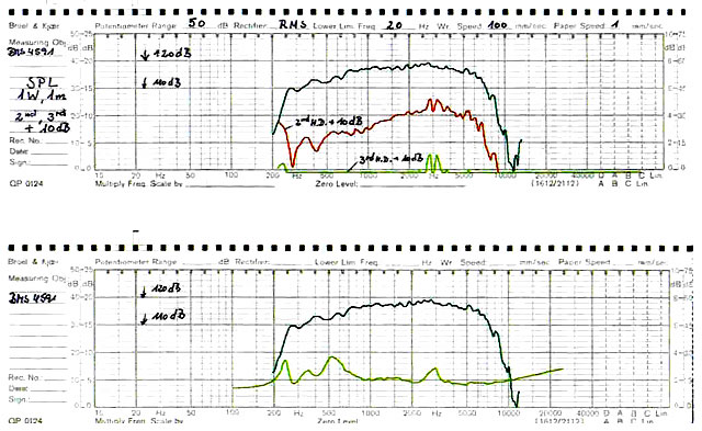

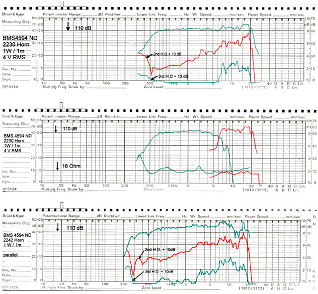

Brett seems to like the non-neo mid (4591) version. Note however that the operation of the driver is quite a bit different - it's basically a "ring radiator", and because of this it's quite a bit more damped than a standard compression driver. (..perhaps emphasizing the initial impulse over the decay.)
http://www.assistanceaudio.com/graphics/4594ND_freq.jpg
http://www.assistanceaudio.com/graphics/4591_freq.jpg
If this is to be beleved, I would be inclined to have a look at the 4591 then.
However, Assistance audio suggest the neo drivers are higher higher resolution?- Not sure how as nearly all the specs are identical between the 2 drivers.
Yes, neo motors tend to sound more detailed than ferrite ceramic. (..but no one seems to be able to discern precisely why.)
At the price point of the BMS neo mid though you have to start considering the Radian 950PB again.. 😱
You mean like the 4591 is a 2" driver and the 4594 is a 2" coaxial driver?Not sure how as nearly all the specs are identical between the 2 drivers.
