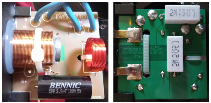

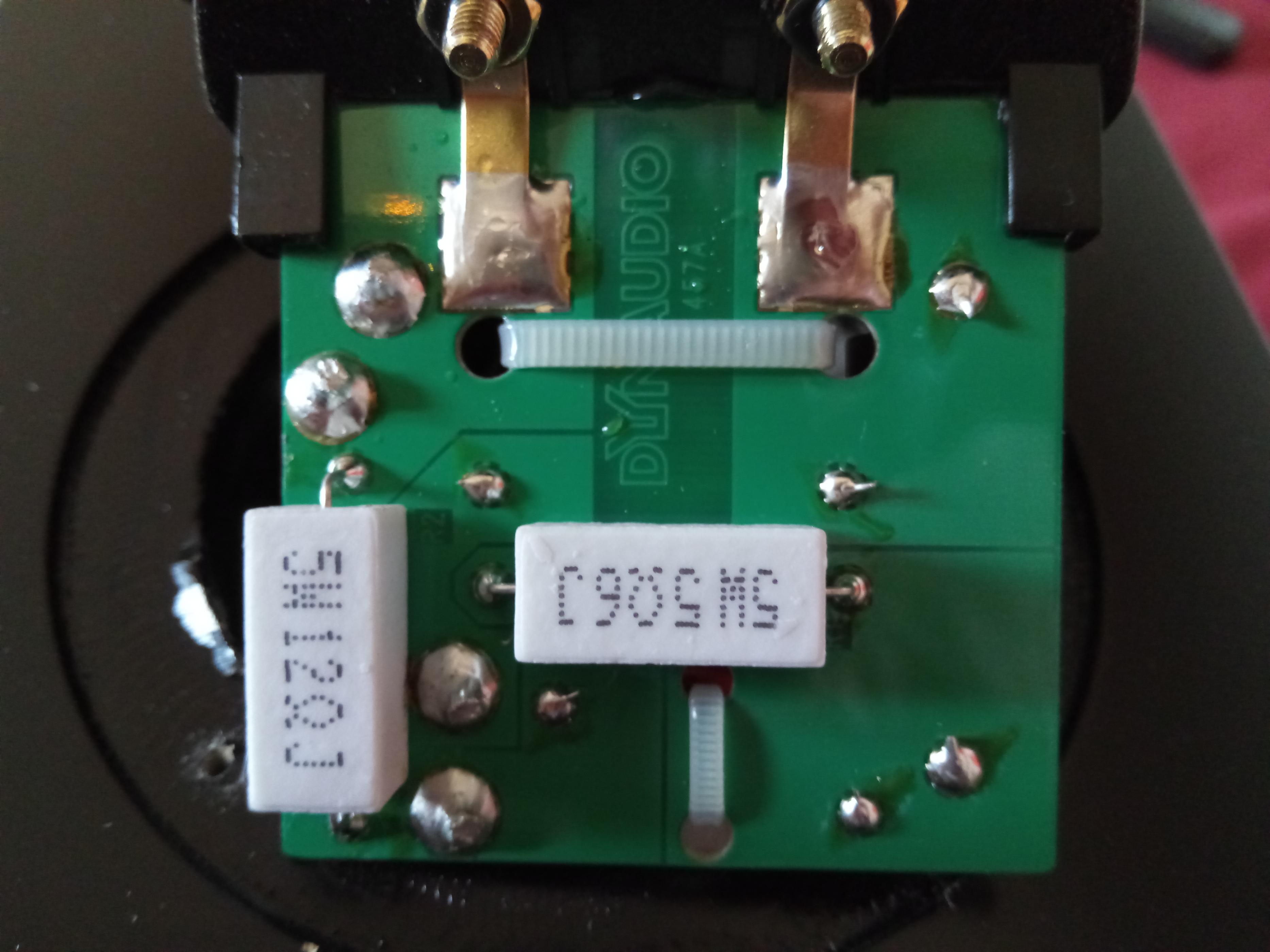

Thanks for the nice crossover board photo! Tweeter sounding crispy is more of a driver quality and less of a filter property. I don't see a padding resistor in the circuit, so either it's a specially designed driver unit that needs no sound padding, or it's voiced in a way that some might find it too bright. I do not have any measurement data on these, so I can't tell.

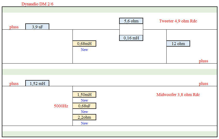

Lojzek, the tweeter is actually 1st order, as you can see from the pictures. The coil is in series with the tweeter, and I think the coil's job is to take down the rising FR of this newer, quicker and lighter type of Dynaudio tweeter.
I have the 1st version of the M10, the Dynaudio DM 2/6, with identical filter and drivers. And I was also bothered with this unnatural "crispy" sound coming from somewhere in the lower treble area.
First I damped the tweeter's flimsy plastic back chamber with 4mm bitumen on the outside, but the "crispy" sound was still present. Then I disconnected the tweeter, and guess what; the "crispy" sound still stood out, although a little weaker (difficult to "ear-measure" things like this when the tweeter is disconnected).
I then looked at FR-plots of other 5½" Dynaudio midwoofers, both Dynaudios own and Stereophile measurements of Totem speakers ++, and most of them had a 8-10dB peaky breakup-resonans around 5000Hz, with lots of stored energy on the waterfall plots. I 1st order filter is not enough. So, in went a deep and narrow 5kHz notch, and after some minor adjustmensts … problem solved.
But with the notch in place, the presence region was too recessed. So I increased the tweeter's filter from 1st to 2nd order. I estimated(!) that this change would increase the damping from around 15dB to 25dB at 1000Hz, reducing the IMD coming from the tweeter, and at the same time lift the tweeter's FR some 1-2dB in the 3000-6000Hz range. And with a 1st order on the midwoofer and 2nd on the tweeter, I also hoped that the phase tracking would improve as well, leading to more precise imaging.
And when I was on it, or in it, I damped the whole cabinet with 4-8mm bitumen pads, and had some nice looking, real cherry-veneer on the outside.
The DM 2/6 is is a great little speaker as is, with very good up-to-date drivers and a well built Made in Denmark ¾" MDF cabinet with a 1" baffle. With all the mods in place, I think it sounds even "better" than my old ProAc 1sc, and I wasn't expecting that. The DM 2/6 has more meat and colour in the bass and lower midrange, it sounds more real at lower volumes, and the treble is cleaner, it doesn't have the 1sc's "stressed" top end. But the 1sc's midrange is hard to beat.
