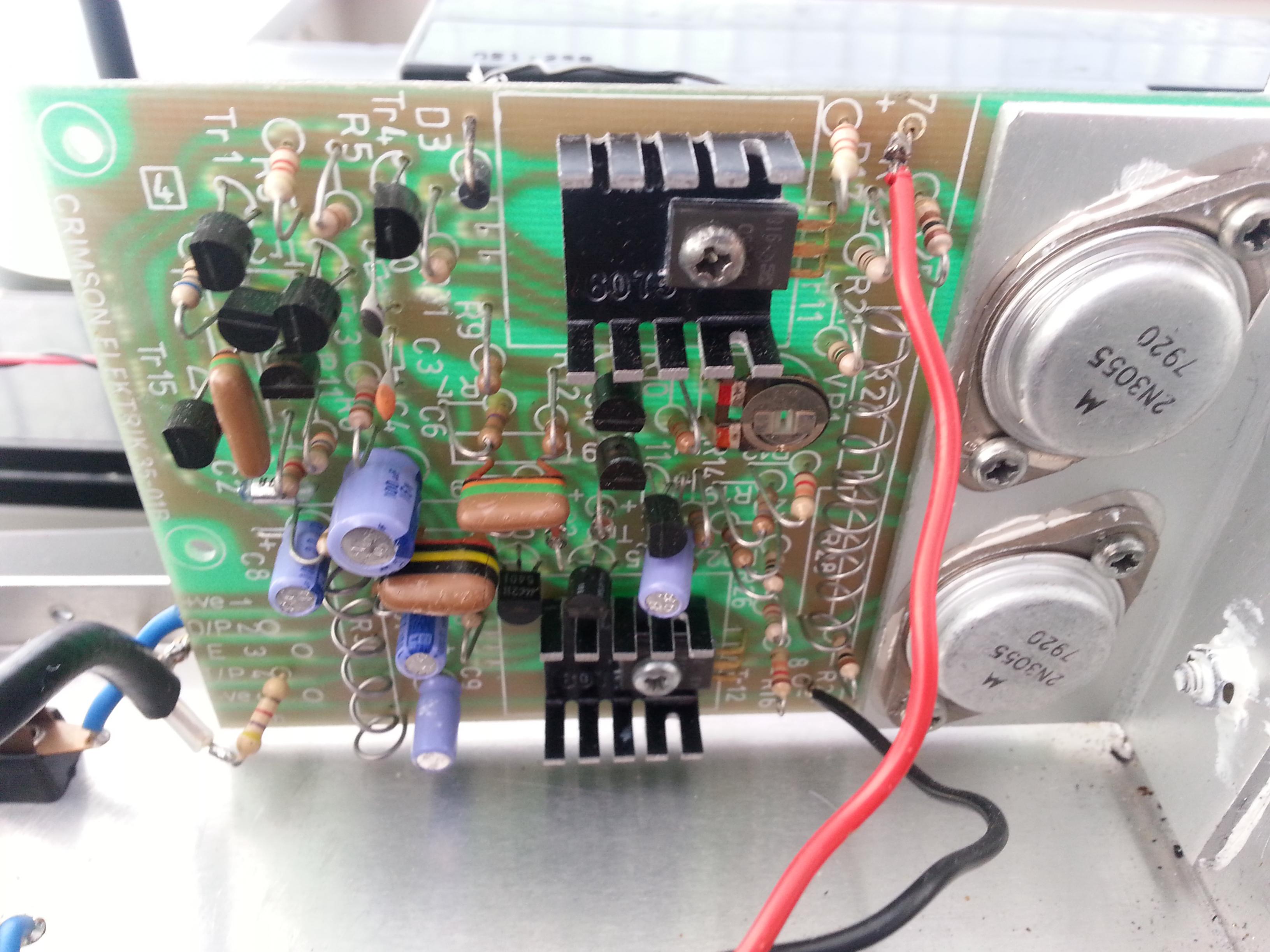

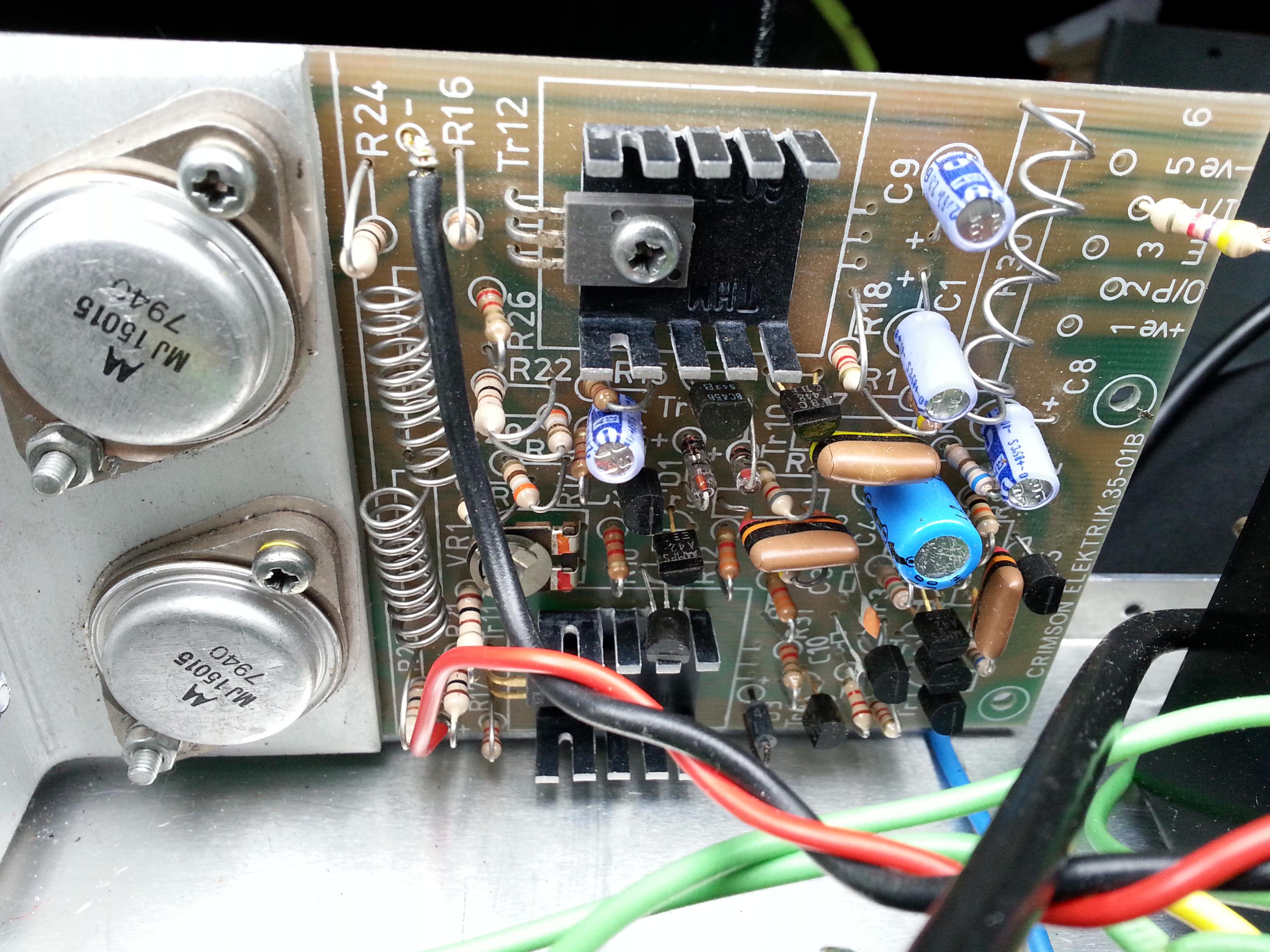

They have different output transistors see pics will this effect the very good sound I am getting all ready ?
the 3055 35 - 01b version must be one of the smaller ones, maybe the 608
version iv is very early.
Brian can probably tell you how old.
the 15015 may be replacement devices for damaged outputs.
What are the drivers?
The quasi needs very fast drivers and if they were damaged, slow ones may have been substituted.
The transformer looks very similar to standard Crimson style.

The issue 4 power amp PCBs date from about 1979 and were in five different versions. They gave from 40 to 100 Watts typically. If you post a pic I can tell you a bit more. We did make better sounding PCBs later. The best of the metal can type PCBs (TO3) was issue VII which was in production until superceded in 1999.
What shall take a.pic of? I have pics added further up what would be the best transistor.to.use fir this sm I really like it regards john

On one of your modules the bias transistor is not in contact with the driver heatsink. It looks like its been replaced with something with different pinout as it should have the flat side facing the heatsink and glued to it.
Your modules look like they are CE608 or CE1004 (nominally 60W into 8 Ohms or 100 into 4) as the amp has one of the smaller Crimson transformers and power is taken from the inner taps (26VAC). You should find the DC power to the amp modules is + and - 36V.
If you can read the values of R14,15,19 and 20 that should tell us whether you have CE608 or CE1004. Also confirm the DC supply voltage and the diameter of the transformer.
You won't get much bias current without mods anyway, a quick Spice sim showed about 0.5A - barely partial class A. Even at that level the heatsinksing looks inadequate.

If you do increase the bias then check that the output transitors don't get too hot. Note: don't touch them with power applied as they can be at full DC supply voltage. Probably better to check the heatsinks don't get anything more than hand hot. Crimson amps often had 70 degree C over temp cutouts fitted to the L bracket. You have heatsinks with a few short fins bolted to the amp modules with the chassis back panel sandwiched between them. This means the output transistors could get too hot before the heatsinks feel hot.
The CE amps have output triples...........On one of your modules the bias transistor is not in contact with the driver heatsink. It looks like its been replaced with something with different pinout as it should have the flat side facing the heatsink and glued to it............

On my PCBs the three To92 transistors are glued to a metal strip.
Edit.
No, that applies to the series viii pcbs, not the earlier series vii.
On the vii one driver sink has a to92 glued to the side.
The post22 pic of the 15015 shows this.
