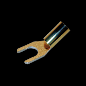

This is a crimping question relating to the Cardas Group buy - I bought the GRS-R9's and I am not sure what to do with them - crimp or solder.

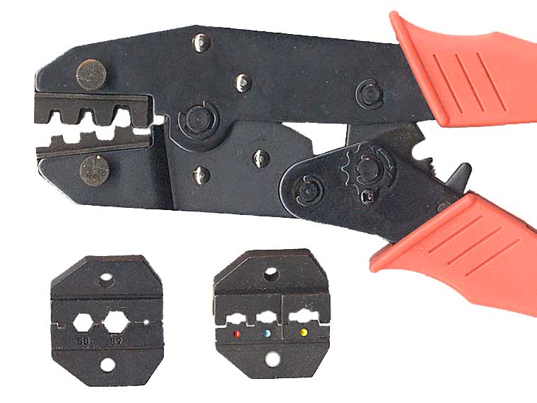

Would this "heavy duty ratchet crimp tool" from Maplin electronics be worth the £20 it costs? The cheap ones I have from crimp terminal assortment sets are useless.

The problem is that there far more connector types and sizes than you usually have a crimp tool for. It's best to have and assortment of crimp tools (if possible) and use the one that best fits the connector. My all time favorite crimp tool, andthe one I have used the most is the plain universal crimp tool.Matttcattt said:Would this "heavy duty ratchet crimp tool" from Maplin electronics be worth the £20 it costs? The cheap ones I have from crimp terminal assortment sets are useless.
http://www.maplin.co.uk/products/module.asp?CartID=040415104113489&moduleno=4231&Products=1
Do not use the above crimper! Only use a rachetting crimper made by Paladin, Canare, Greenlee, or one of similar style. Buy the 'dies' for the type of crimp you are making. Frames range from $40 to over $100 and dies are $30 or so. A good crimper will always make a crimp of proper tightness, not too tight or loose.
This is only true if the die is specifically made for the type and size connector you're using. The wrong die can actually give you a poorer crimp.markp said:A good crimper will always make a crimp of proper tightness, not too tight or loose.
What would be the recommended crimp tool for this spade connector?
Why not use the Paladin 8000 CrimpAll? It's so much better than the 1300 and other cheap-o tools, and you can get the 8000 crimp frame for cheap here. I bought my paladin 8000 frame and a few die sets from them, and couldn't be happier. The elliptical lever mechanism delivers a lot more force toward the end of the stroke than you can get with a regular crimper. In combination with the long handles, this really reduces the strain on your hands, even for the toughest crimps. The ratcheting action makes sure you use the right amount of force too, so you get consistent results each time. I'd hesitate to spend $50+ on similar industrial crimpers for personal use, but at $22 (the price of a die set) I think you'll agree, this kind of tool pays for itself pretty quickly.

hifiZen said:Why not use the Paladin 8000 CrimpAll? It's so much better than the 1300 and other cheap-o tools, and you can get the 8000 crimp frame for cheap here. I bought my paladin 8000 frame and a few die sets from them, and couldn't be happier. The elliptical lever mechanism delivers a lot more force toward the end of the stroke than you can get with a regular crimper. In combination with the long handles, this really reduces the strain on your hands, even for the toughest crimps. The ratcheting action makes sure you use the right amount of force too, so you get consistent results each time. I'd hesitate to spend $50+ on similar industrial crimpers for personal use, but at $22 (the price of a die set) I think you'll agree, this kind of tool pays for itself pretty quickly.

I suggested the PA-1360 because they were crying about price... There are better tools as you have pointed out.
Well, I guess that depends on what you're willing to pay for a good connection, and the bruises on the palm of your hands! 😉 Seriously though, I consider tools part of my project costs... the quality of tool used usually has a direct impact on the quality of the results. This is obvious, isn't it?. Now I'm as frugal as the next guy, but I see so many audio hobbyists who will spend silly sums of money on fancy capacitors, resistors, silver wire etc, but won't pony up for decent tools. This just doesn't make sense to me. 😕
