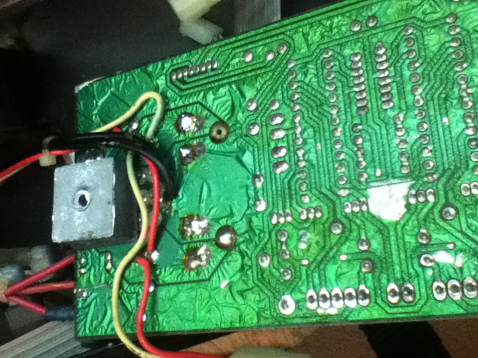

EDIT: Upon closer inspection of these pcb's I found something WEIRD. Rember I said the solder mask seems all "bubbled" up? Well I decided to scrape off a bit of some of the solder mask and it appears that under most of these bubbles is actually not air, but the traces themselves. Its as if when they made these pcb's they somehow messed them up real bad. Its the surface of the actual traces underneath the solder mask that is all bumpy and enlarged. Only a few of these solder mask bubbles are empty, and the traces flat.
Here's the pics.
First pic shows the underside of the power supply board. You can see all the bubbly solder mask, which actually is (like I said) not air under it as I previously thought, its actually just a deformation in the traces from its manufacture I suppose.

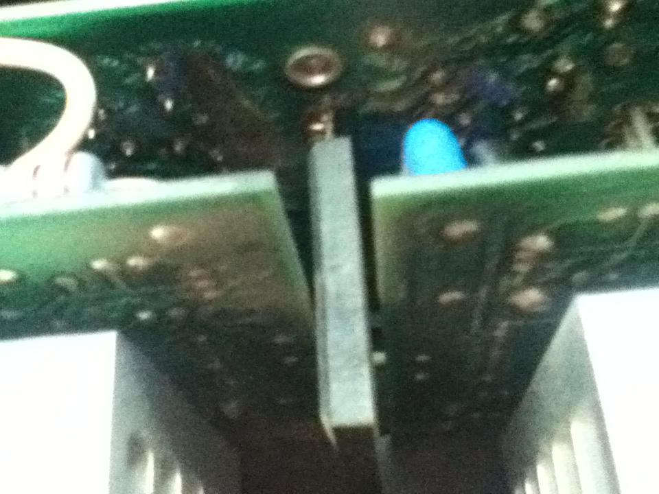

In the second picture you see the back of the output module, it has solder mask bubbles that are actually full of air, and will flake off if you touch them (you can see shiny spots where this has happened).
I guess the best way to describe it is that for most of the powersupply board's underside, the actual metal traces themselves are deformed, thus the solder mask on top of them, though still mostly adhered, is deformed.

so where's the electrolyte contamination i don't see it
That's just a clear liquid on the topside of the board. I didn't think I needed pics of it, do I?
Well I couldn't stand just standing here any longer. I took a bit of soap, some hot water, and a sponge and in about 5 minutes that power supply board looked cleaner than before the cap even blew up 😀

It's not deformed and is quite deliberate, this was a way of somewhat beefing up the conductor surface area to avoid the need for heavy copper traces. Not uncommon in higher powered amps. I worked for a large audio manufacturer that used this technique on its pcbs - much cheaper than the 2 - 4oz copper they should have been using. (If done correctly there should be a lot of solder on those traces, with age the solder mask sometimes starts to flake off, this should not be a problem if the trace was fully tinned.)
