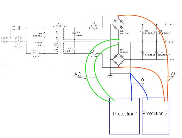

Is there any disadvantes if I connect both protection circuit to same bridge?
Is that then totally seperated mono amps any more? No I guess.
And other rail (other secondary winding) have more load than other? Any disadvantages or any hearable (sonic) difference?

I know that I can connect those protection circuit parraller but it will be easier to connect at the moment like in my picture (post #24). So, can I connect like that?
Bias is set maximum what Elektor advise. I do not have listen it yet, only mono testing done 🙂
Joensd
I thought you were using only one transformer.Is that then totally seperated mono amps any more? No I guess.
So how can you go "mono"?
And still: connecting the protection to only one bridge will not give you what you want: A check if both rails are "operating".

But can I connect those protection circuit like I descripted on post #24. Because it's so easy connect those like that at the moment

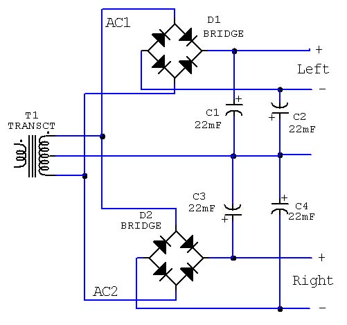

How double rectifier bridge can raise risk to oscillation? Earlier on this page, almost everybody advised me to use two rectifier bridge againts one?
-> soundwise 2 bridges is better
maybe first explain why the use of 2 bridges
* when using 1 bridge and using a not so good starpoint, when current begins to flow there wil be a pottential diffirence between the point where the 2 trafo windings come together and the point where your inputsignal and outputsignal is connected due the current in the groundplane ( from the outputsignal that is ).
This means that the signal/noise ratio will be bad.
* Also when using 1 bridge the wiring of the transformer wil be pikking up some signal, see it like an antenna, and the wiring off in the transformer could get pretty large ...
but ... ( always the but ... )
* using 2 bridges means u use 2 diodes in series with the voltage rails, now the problem with diodes is that they have a voltage drop off about 0.6V ( min ) and the higher the voltagedrop the higher the currentpulse ( witch is HF noise ) will be when going from non-conducting to conducting. Sow using 2 diodes in series means more then the double off the currentpulse an a lot more HF noise on the rails, with some nice CRC filtering a lot off this could be removed, and adding some low value high power resistor in series with the AC windings from the transformer alsow helps a LOT.
The thing is when this noise is above normal values the amp begins to oscilate, where the amp has a rather nice PSRR on the low region it has a very bad PSRR on the higher frequentie regions.
Maybe a suggestion to make the confusion completely, why not use 2 bridges, but 1 for every channel and use seperated buffer-caps, sow that left and right are totally seperated except for the transformer. You will have a pretty nice channelseperation this way.
Little suggestion on the amp hitself, place a 100nF and a 1nF cap over C6 and C7, this makes that the amp will have a better PSRR.
And try to leave the servo out of the circuit, put a trimpotmeter at the bias pin and connect both supply voltages at it ( use 100K or something as the pot ), this only when you actually can stabilize the DC voltage at the output, the amp doesnt always allows this. It does sound a lot more ... lets say musical / clear after this modification ('s).
Have fun listening / building your amp
Greetz Rudy

With the bridges i mean like in the picture below
The servo = R24,D5,D6,C6, IC1, R25
when leaving this components out of your PCB you have to add a potentiometer the adjust the DC output setting yourself, this circuit does this fully automaticly, but you can try this without removing to Servo circuit, just dont connect servo into the amplifier PCB but connect a potmeter to this pin. To try this, leave the amp on untill it reaches max temperature, set DC ouput to 0V ( so close possibel ) and then turn him off, wait untill the amp is cold ( about 2 hours ) and put him back on, if the DC voltage on the output is higher then 100mV the first minutes, then better use the servo system.

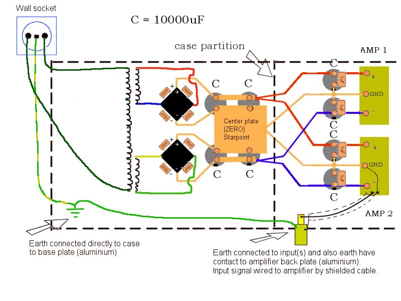

Five things:
1) Have you connected the transformer's secondary earth to the star point?
2) Have you connected the star to the chassis you are using?
3) The ideal star point is not between the capacitors, but a little bit away from that point. About 1" would be fine.
4) Disconnect the AC ground wire from the star or the chassis and see if the hum goes away.
5) The speaker (-) should always be connected to the star. The protection ground should go to the star too, except if you are using a bridge arrangement, where the speaker (-) should float from the ground.
You should also check where your input earth is conected to.
Carlos

Hello
I attach picture about my power supply schematic.
1) Sorry. I don't undestand what you mean 'transformer secondary earth'. I have been connect other rectifier bridge minus(-) and other bridge plus (+) to main capasitors center plate (ZERO).
2) Not directly, but it goes to chassis (case) through input cables shield (RCA). Look my attachment.
3) But where starpoint should be in my amplifier, because I have two big capasitors added close to both amplifier boards, separated from main capasitors.
4) I try that I disconnect AC ground (wall socket ground) but that hum is still hearable.
I noticed that if I disconnect CD-player wire from amplifier input (RCA), hum reduced but still hearable.
Then I tried connect short metal (small chisel) to input (RCA) then hum increases.
If I short circuit input (RCA) to input socket frame (chassis) then hum is like square wave modulated or so. Some high frequencies comes out from my speakers
