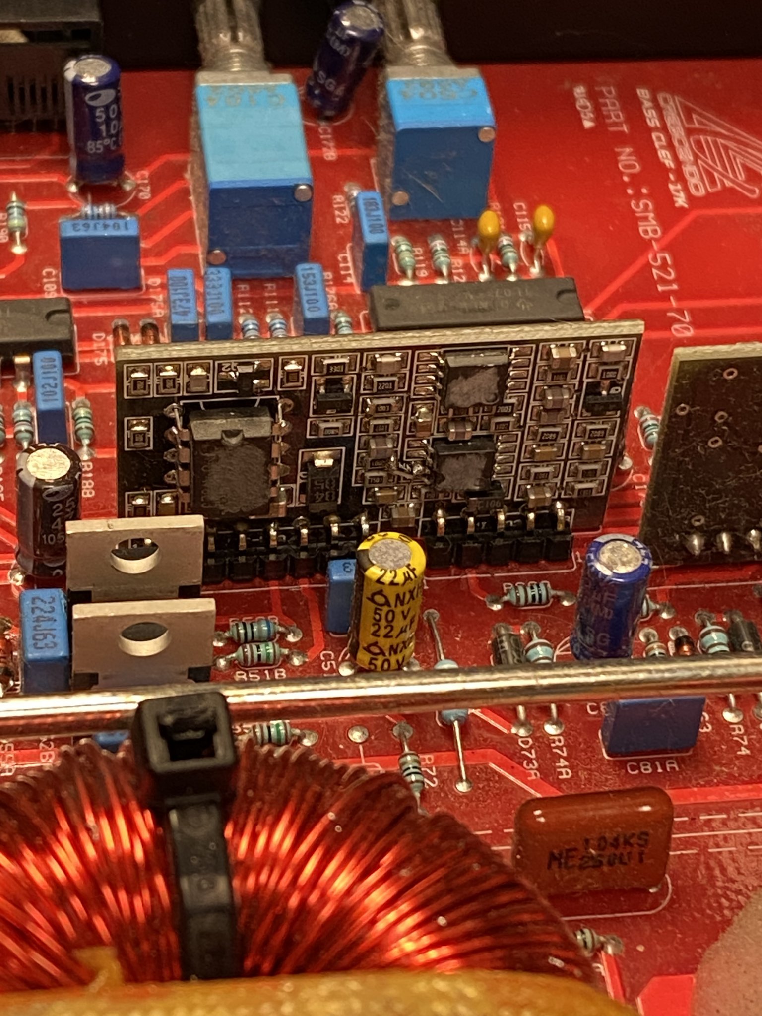

There are a total of 24 outputs in the amp .
Where the 3rd leg of the output connects to the output filter inductor I bet good drive signal .
On the other outputs where the middle leg connects to the output filter inductor I bet no drive signal on the the trace just goes to the bottom of the display
The 3rd leg of the outputs driving the inductor are the high-side FETs.
The middle leg of the low-side FETs connects directly to the inductor. Even if there was no low-side drive, you would have a signal on the middle leg of the low-side FETs.
Also, you can' have r-r drive without the low-side FETs being driven.

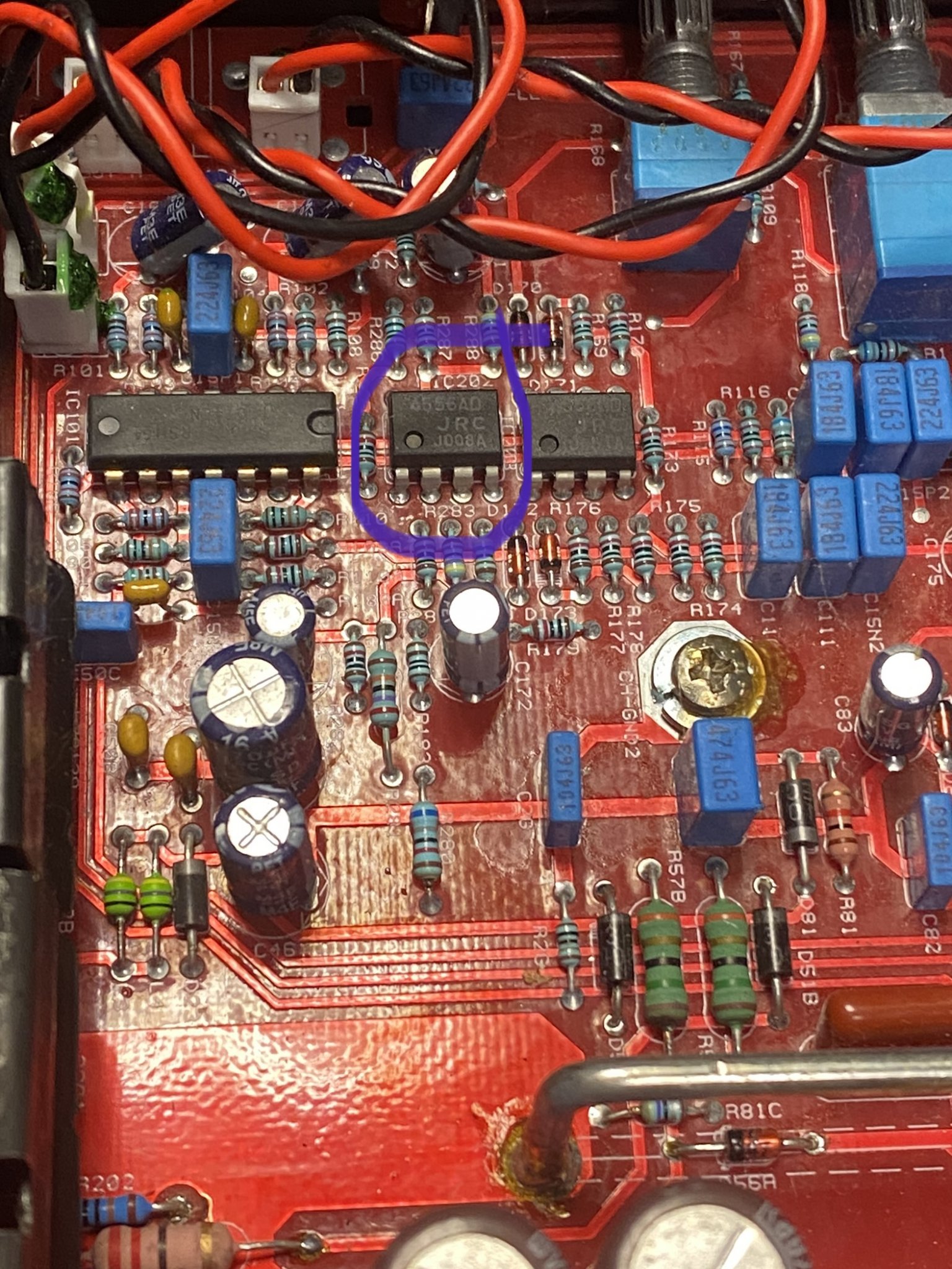

Also with only one rca ground shield open as seen in post 25 and the other one intact could that cause the noise issue the amp was having ?
I don't think the bad ground could have caused the problem if the noise was present without RCAs plugged in. It would be the same as having no RCAs connected.
