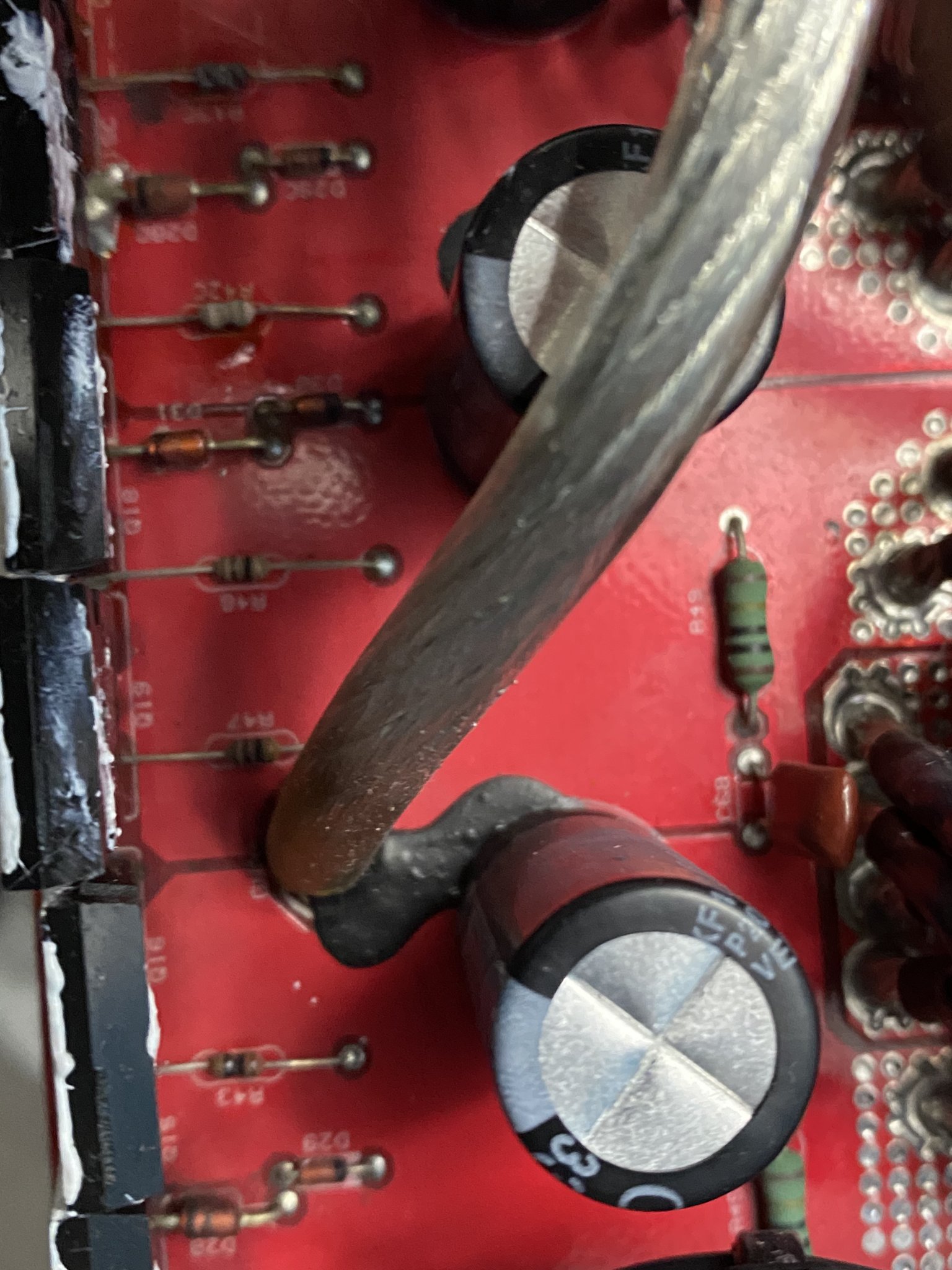

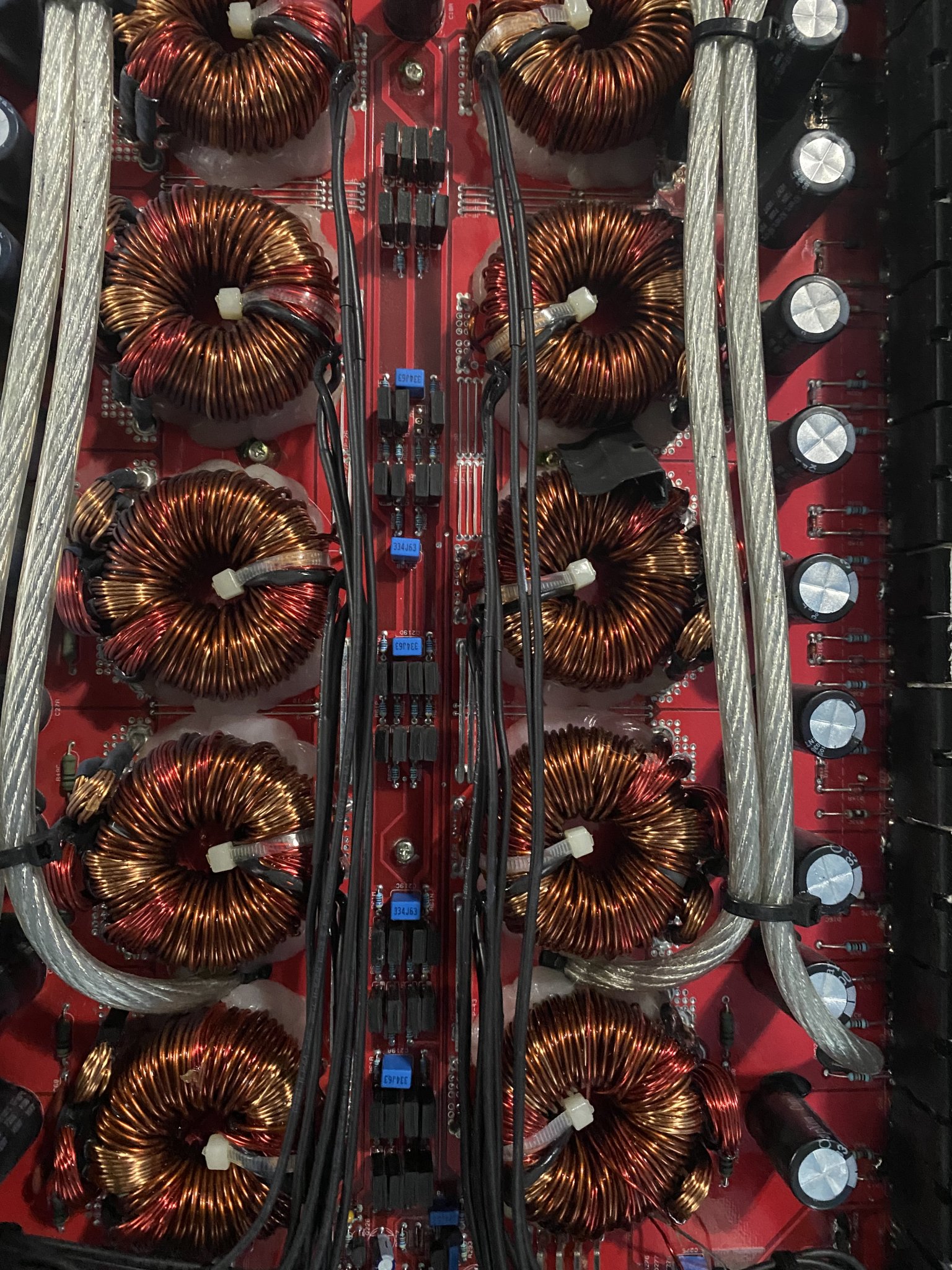

Original power supply fets are IRFP7530
Does anyone know of a good replacement for them ?
I can find some stock of the original part number but either they don’t have enough in stock or I have to buy a large quantity.

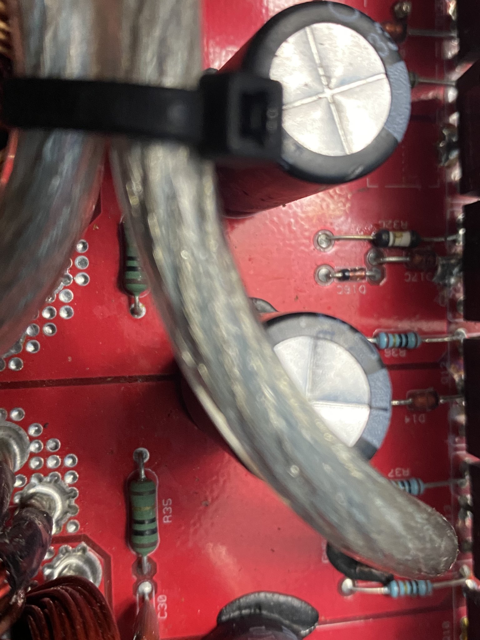

For the gate resistors does it matter if I use 1% or 5% tolorance ?
I do not know the original tolerance of the resistors since this amp has been repaired before by someone else and there are 1% and 5% and both 1/8 and 1/4 watt resistors .
Appears someone used what they had on hand when repairing it the first time

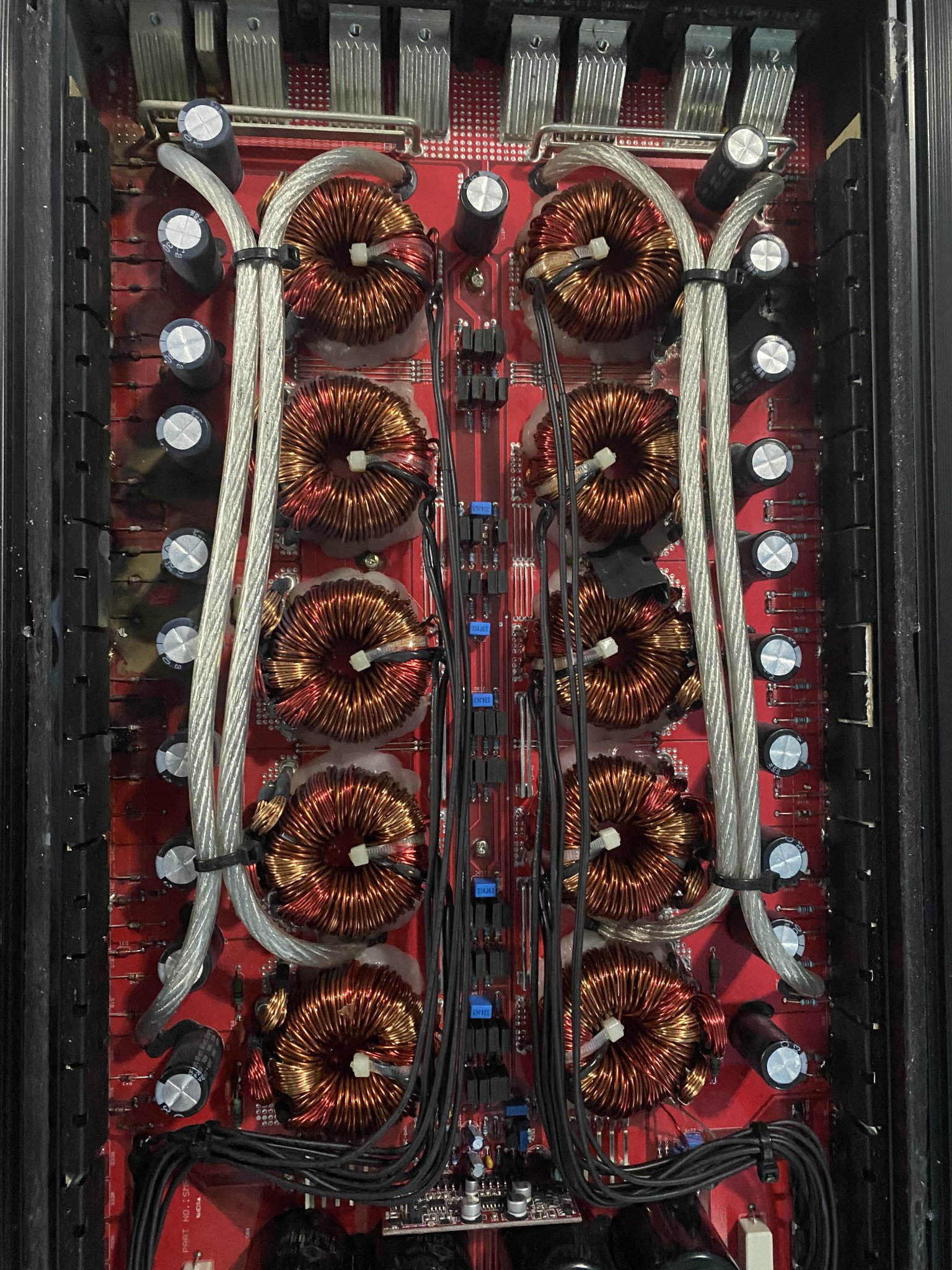

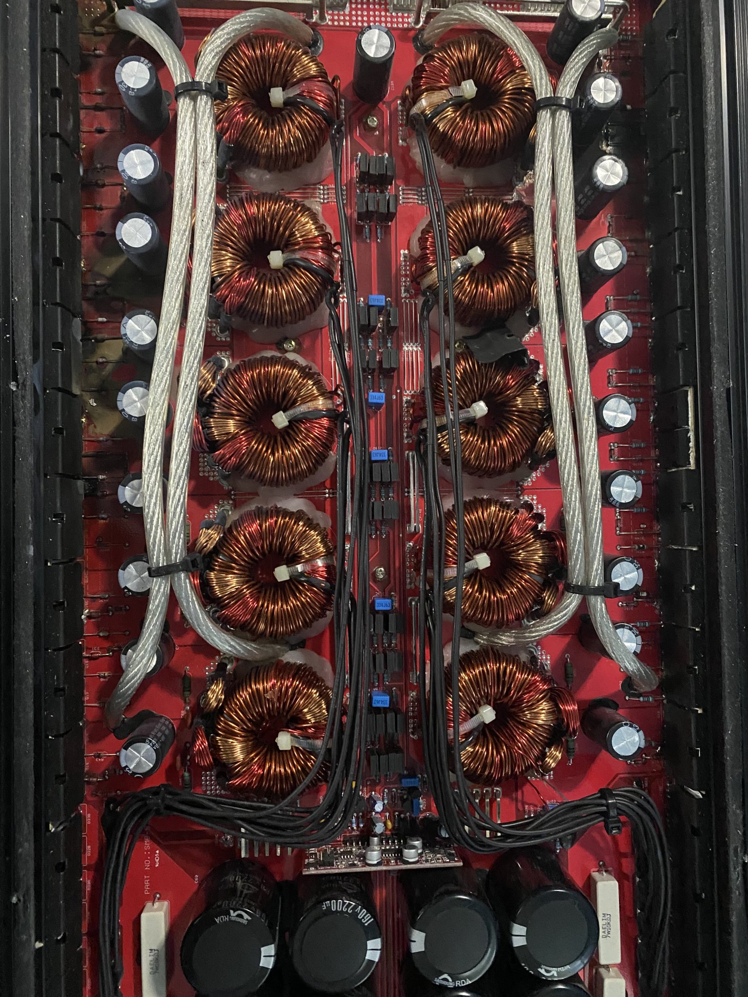

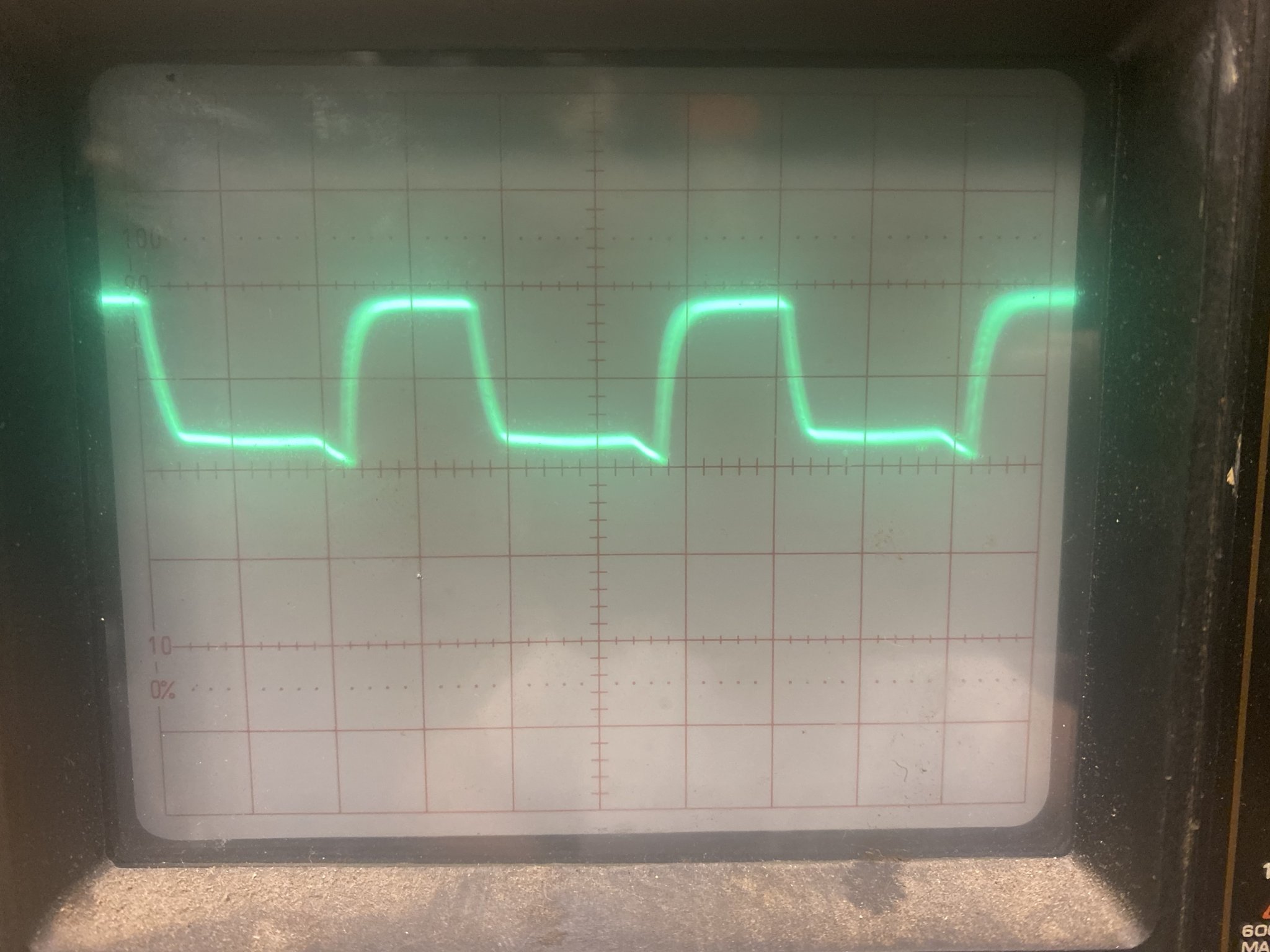

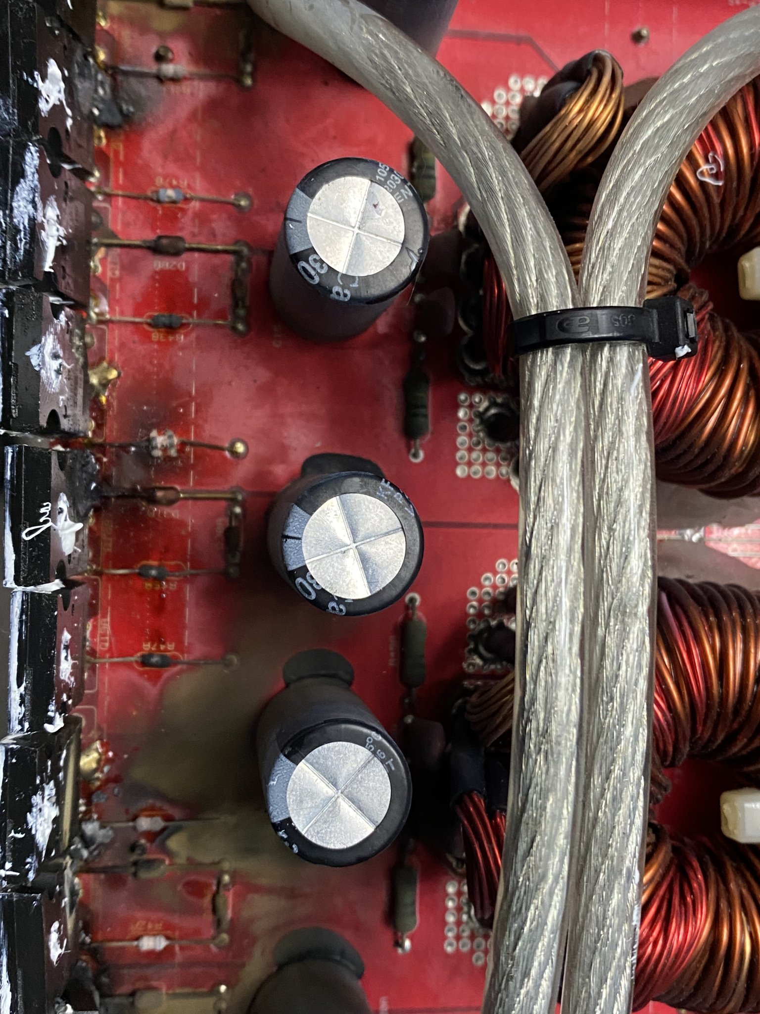

That seems like a lot of work. Does it get better with the rectifiers out of the amp?
The drive was a bit off of what I'd expect but unless the FETs have a VERY low threshold, I don't think the drive is the problem.
What's the frequency on pin 9 or 10 (measured with a multimeter)?
I don't understand. The emitters of the 140s are directly connected to the emitters of the 139s. Why can't you read the 139s?
10 ohms would appear that the pulldown resistors are 10 ohms.
What's the resistance across the gate and source of the FETs?
What's the value of the gate resistors?
