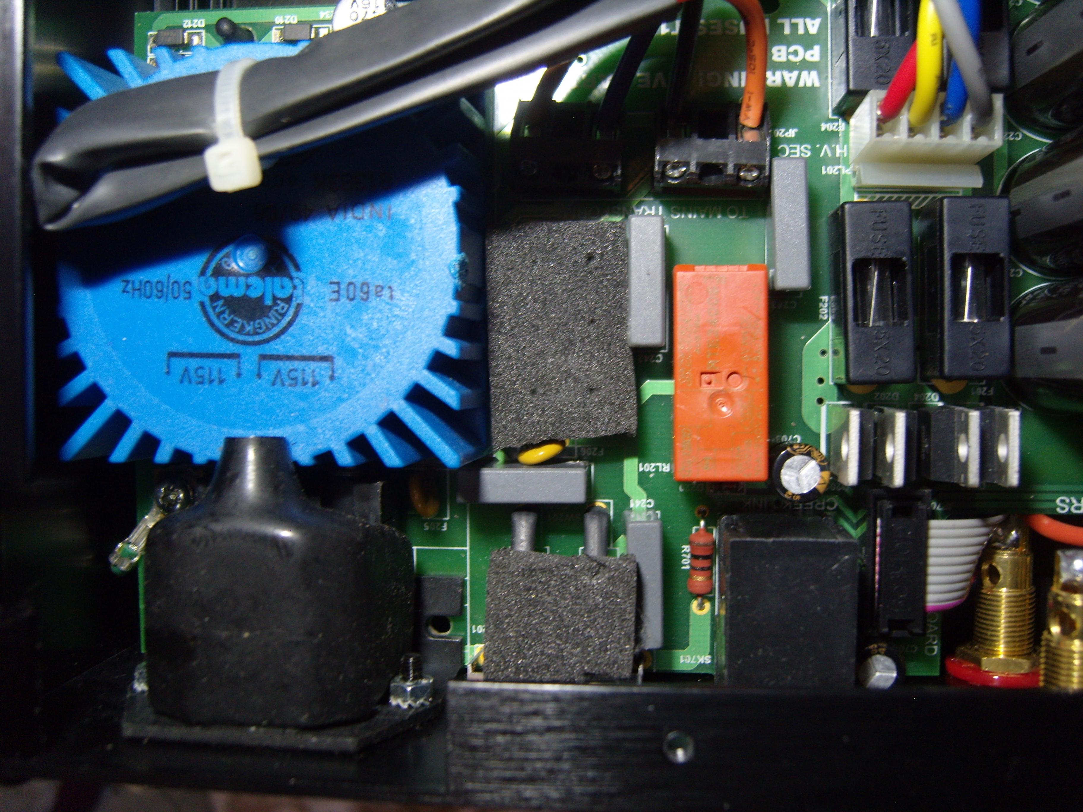

Hi all,
I have a Creek Destiny amplifier that has a problem powering up from standby when it is first switched on. When I switch the power on at the switch at the back of the amp, the orange standby light comes on as it is supposed to, but when I try to power up, the light blinks once then goes back to standby. If I leave the amp for about five minutes in standby mode, it will power up OK. I think I have pinpointed the problem to a voltage regulator (1084 adj with heatsink). If the voltage regulator and heatsink are warmed up before it is switched on it will power up first time with no problem. Just wondering if anybody knows if warming up the voltage regulator can alter its output voltage or if there is something else going on that can be causing the problem. Also if anyone has a schematic for the Creek Destiny amplifier, it would be greatly appreciated as the protection circuit makes it difficult to work on.
Many Thanks - Nick

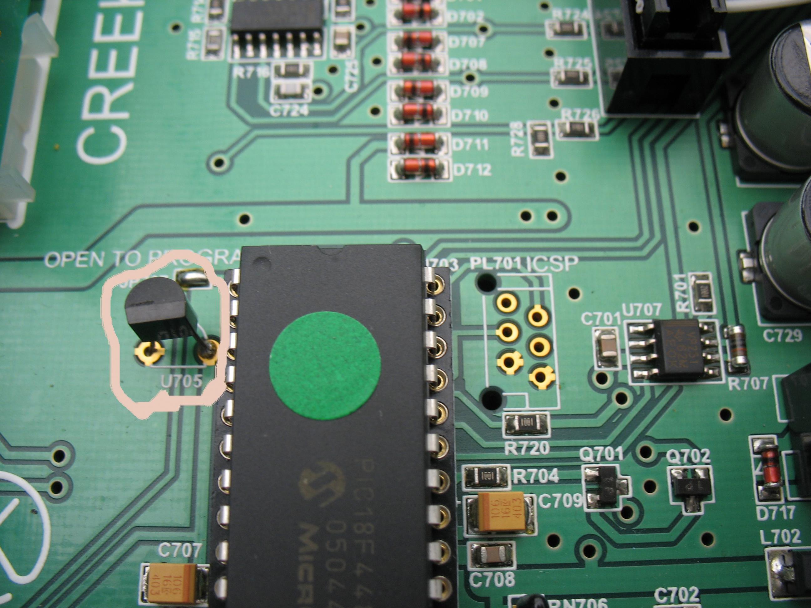

Hi Vinh, my issue was caused by a component called a DS1233 processor supervisor which resets the chip. The original one that was fitted was a 5% rating (DS1233-5). This needs to be replaced with one with a 10% rating (DS1233-10) which solved the problem. I think this is the component I bought - DS1233-10+ | Maxim Integrated Voltage Supervisor 3-Pin TO-92, DS1233-10+ | RS Components
I have attached a photo of the DS1233 on the amp circuit board to help you identify it.
Hope this helps
Best Regards - Nick

Sure thing and welcome. I should add, I just checked and my working Destiny has the original DS1233-5 IC Supervisor.
The first thing I would check if you can is your Left and Right channel dc offset values- they should be ideally below 10mV. Then check if (C237,C238, and C523, C524 are bulging or leaking. The Destiny was built with caps from the Capacitor Plague . I’ve seen a handful of Destiny’s with some or all of those 4 caps bulging. In my research and experience those bulging capacitors have been the most common cause of issues.
Also, if your amp has a phono stage installed it will not work (will go into fault mode on increasing volume) unless a load (turntable - cartridge) is connected to the phono input. This is by design.
Recently serviced a Creek Destiny with a similar issue where pressing the standby button had inconsistent results. Replaced all above capacitors to no avail. It turns out another culprit is this tactile switch (SW701).
TS04-66-43-BK-100-SMT​
One method to verify is A/B testing the remote vs. front panel button. If I’m not mistaken, perhaps using the higher tolerance Voltage Supervisors compensates for wider range of ON values introduced by the less than ideal running tactile switch. I measured a wide range of resistance values across pins 1 and 2 (0.5. To several Ohms) when pressed ON. Replacing the tactile switch fixed the issue.
