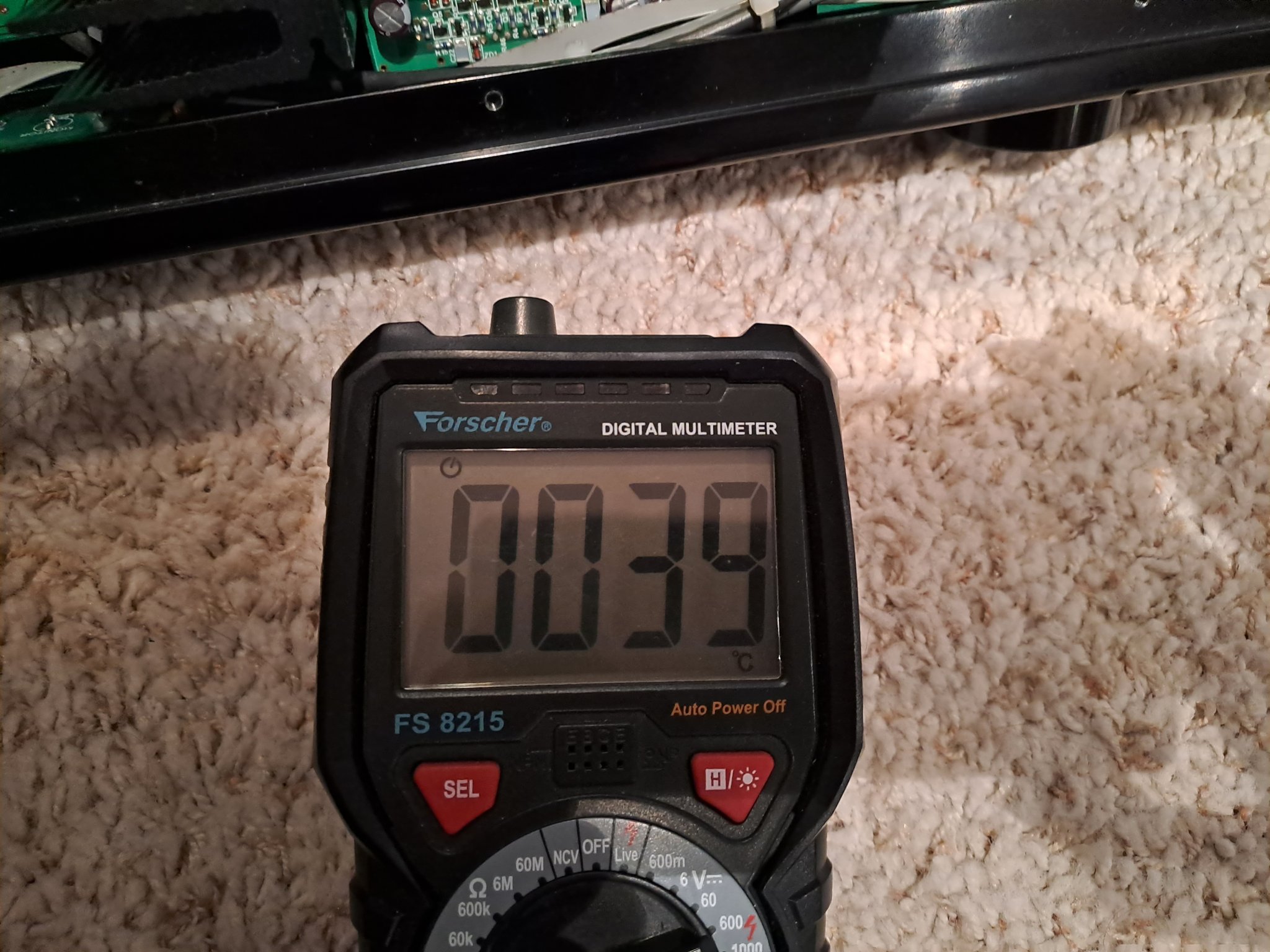

Hi Gregory again,
I checked the voltage and temp on R38 (138) i R39 (139). In my amp voltage drops on both channel is about 32V. After a few minutes of starting the temperature is approx 50C. VPWRL/VPWRR is +/-95V so the current is 14,5 mA. Theoretically, the power of the resistor should be enough 0,5W. 1W should be ok. Check voltages on the resistors and supply voltage.

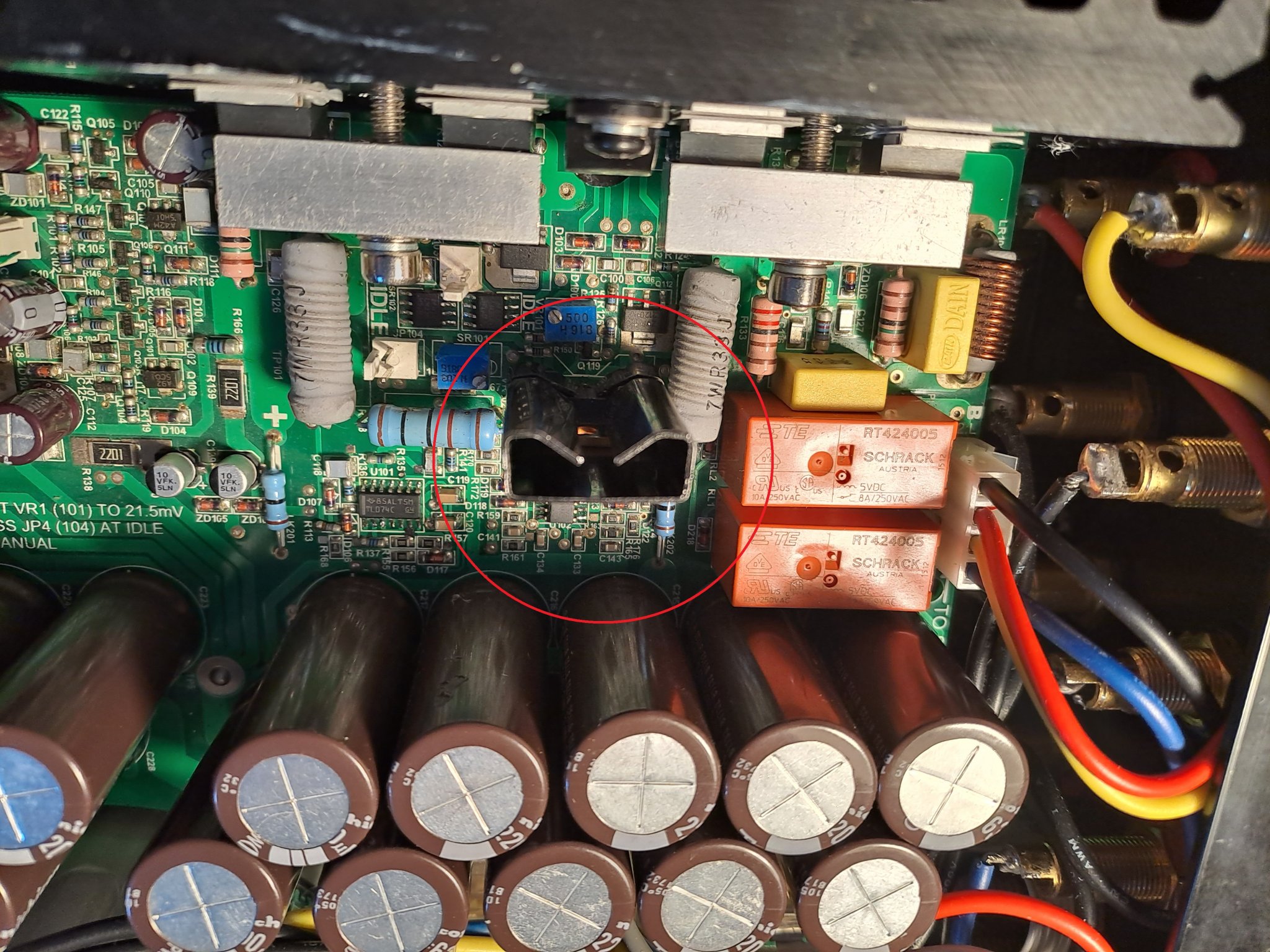

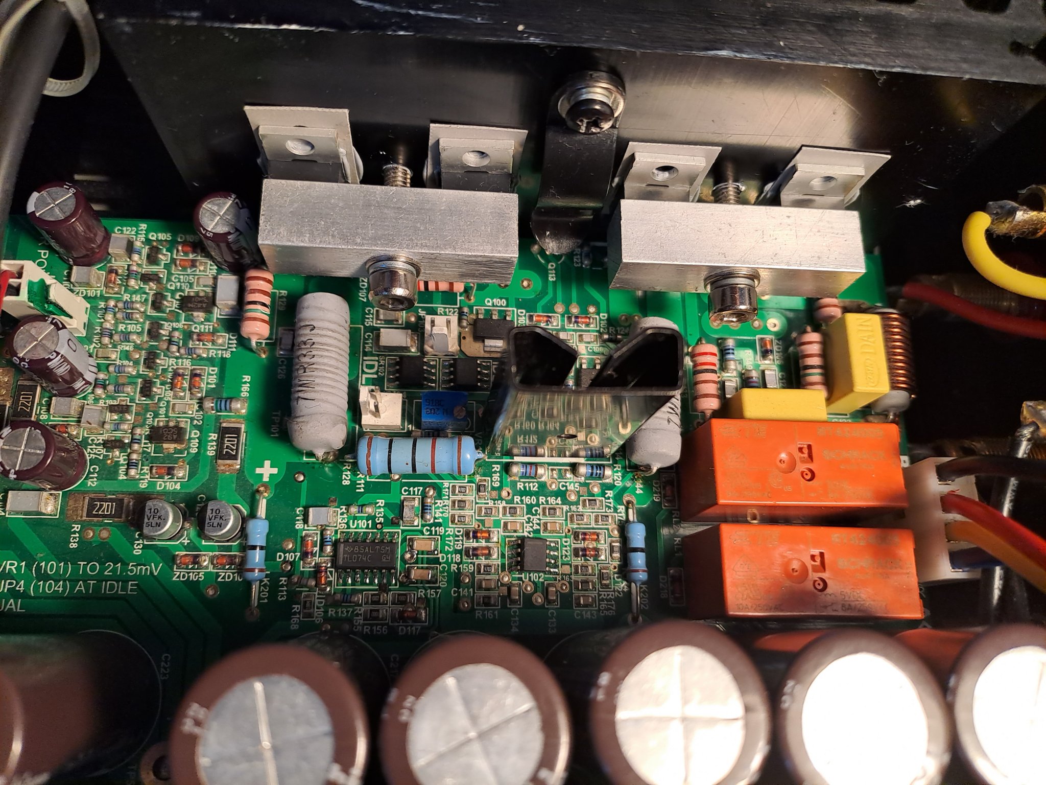

Hi Peter,

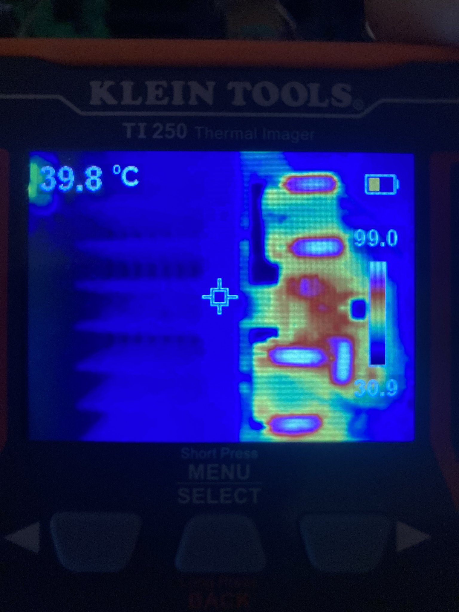

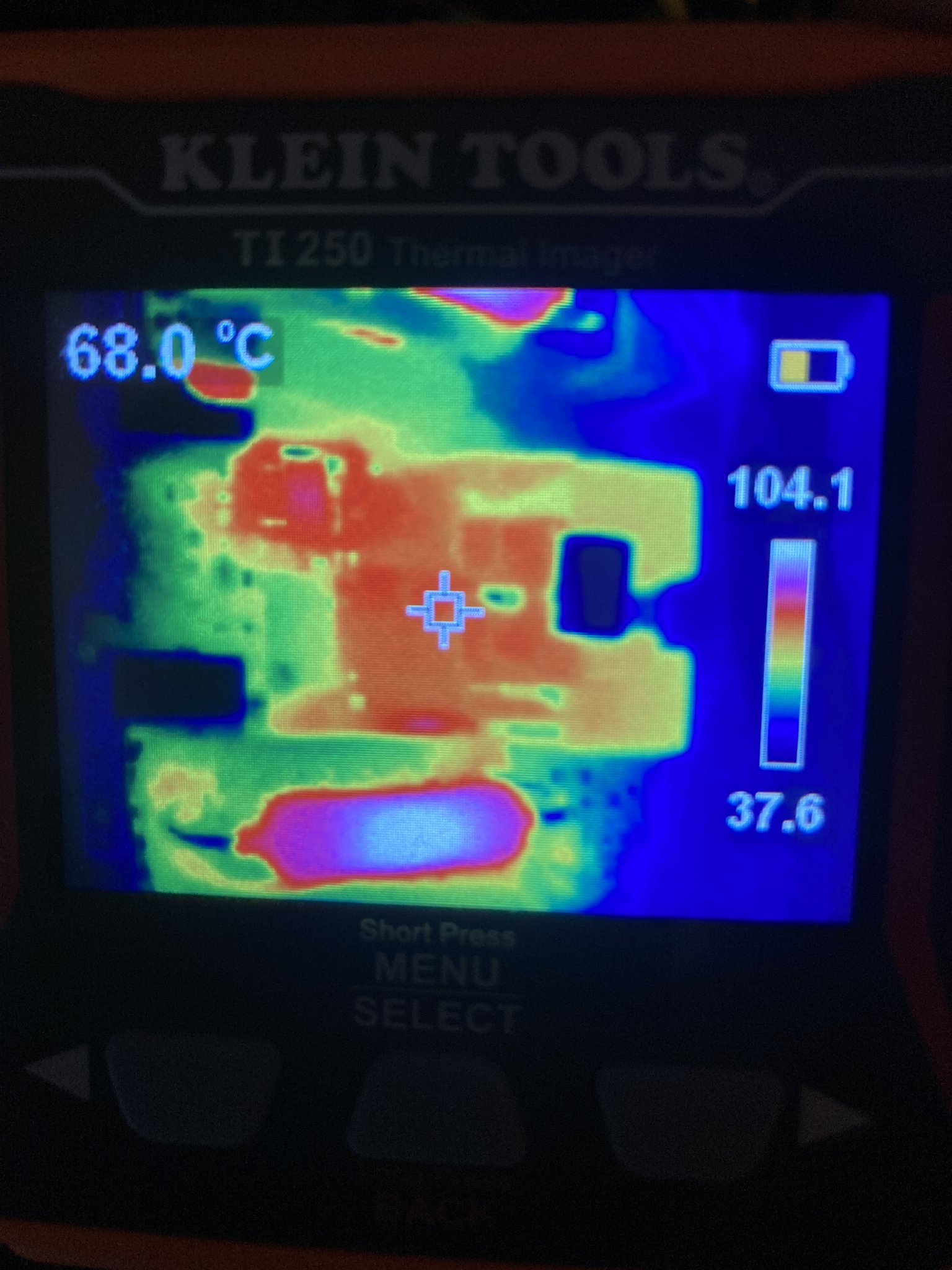

Sorry, I meant the total wattage for those 4 2k2 resistors is around 3 Watts in a small area. On my PCB, After 20 minutes those surface mount resistors got very hot, 80C+, and the heat spread to nearby components. For example, C30 reached 80C. At the time I thought something was wrong with the circuit and/or components. I checked and rechecked all the values, and replaced C30 and C29 to no avail. It turns out, the culprit was the inadequate heat management for those 4 2k2 surface mount resistors. I used an Infrared camera to measure temperatures. After moving the 2k2 resistors, C30 and other nearby component temperatures are 50-60C after warming up.
Regarding Q14, I added a second heatsink which reduced the temperature by 5-10C.

With the low RDS On values I'm thinking there is less heat dissipating from the IRLB4030PBF MOSFETs. Is your lid warm after an hour or so on idle? My heatsinks never get above 45C, except on days when the ambient temperature is above 25C.
I wonder if thermal paste matters here. I use Arctic MX-4 made in Germany (www. arctic.ac). Maybe this will lower the temperature on the power transistors
I used a generic silicone based brand I found at my electronics shop. The thermal camera was borrowed from a tool library. I’m wondering if the lower Rds (On) value for your MOSFETs means less heat. However, It’s only a 1-2C difference for the heatsinks which can be accounted for by error and reading location.
You have a much higher temperature on the power transistors. This may be due to poor heat dissipation from the transistors to the heat sink or a higher value of the Rds(on) resistance. The way is to test the replacement of transistors. 🙁
Is your conclusion based on the photo from the thermal camera? I think you might be mistaking the 2k2 resistors I mounted next to the heatsinks as the power transistors.🙂

Did you manage to measure the mounting torque of the power transistors against the heatsink? The IRL2910 specs are <1 Nm, I imagine your power transistors are similar. I ended up just adding a small amount of pressure past snug.
