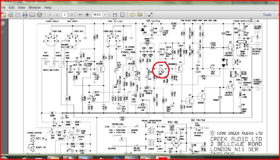

Here is theschematics of the amp, hope Creek don`t mind that I post it here:

Still a bit small to work with. If it's a pdf then you can put it in a zipped folder to post it.
Removing this cap will isolate the preamp from the power amp. I think the amp should be stable doing this from what I can see.
Or, you could short the left side of that cap to ground to remove all signal to see if hum disappears.
Didn`t know this, thanks for the input. Schematics is attached. Is the 4.7uF coupling cap the one that differentiates the pre-amp from the power amp section?
PS: Just saw you have highlighted it 🙂 It is an orange Rybucon electrolytic cap, I might replace them with Polypropylene caps instead, there`s plenty of space for that.

No oscilloscope, but have a multimeter and RLC meter...Butstarting point is good, I`ll isolate the preamp and power amp sections tonight and will post some results.

Some basic tests then to try and get a grip on what's going on.
Measure the DC voltage at the junction of the two 0.22 ohm resistors on the output transistors (can only make out R43 ??? as ref). It should be approximately half the voltage of the main supply rail.
Carefully measure the voltage across either of the 0.22 ohm resistors. It should be around 6 millivolts DC at a guess. Compare with the other channel.
Is C21A ???? (the 470uF above Q3) OK. Prove by substitution.

So what happened, I measured the voltage and the drop - all as suggested by you. Then I exchanged the two 470uF caps and buzz went to the other channel which makes it clear to me 🙂 I have ordered a whole bunch of Panasonic caps, including the 470uF ones, so once they arrive, I`ll have this fixed and the amp will be up and running, restored to its original toroidal transformer ( a bit bigger indeed ) and with some higher quality caps. I also added an RCA connection to it. Nice piece of British engineering, now back in service, thanks to you 🙂
