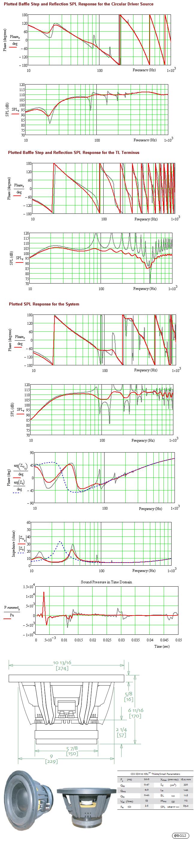

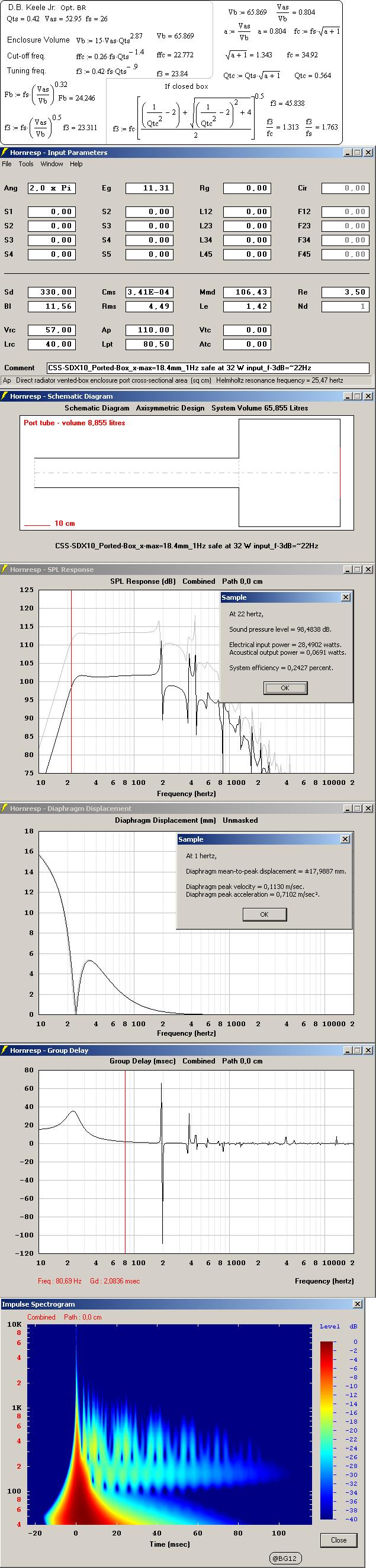

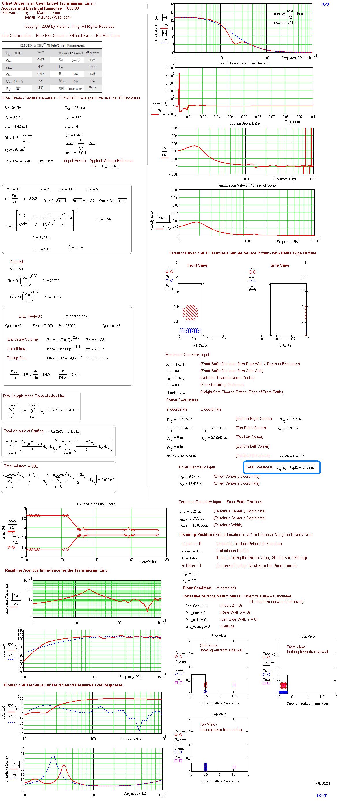

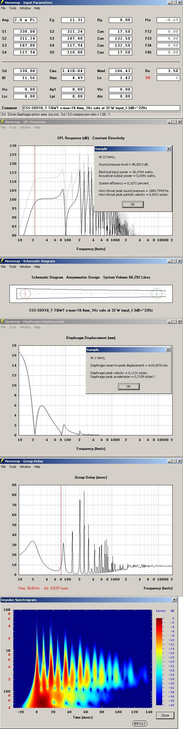

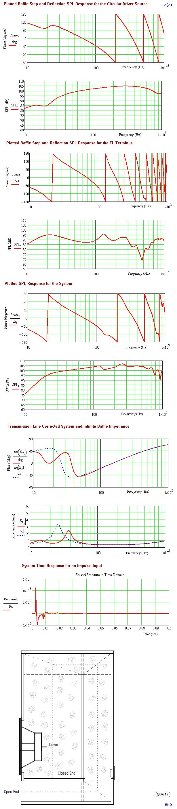

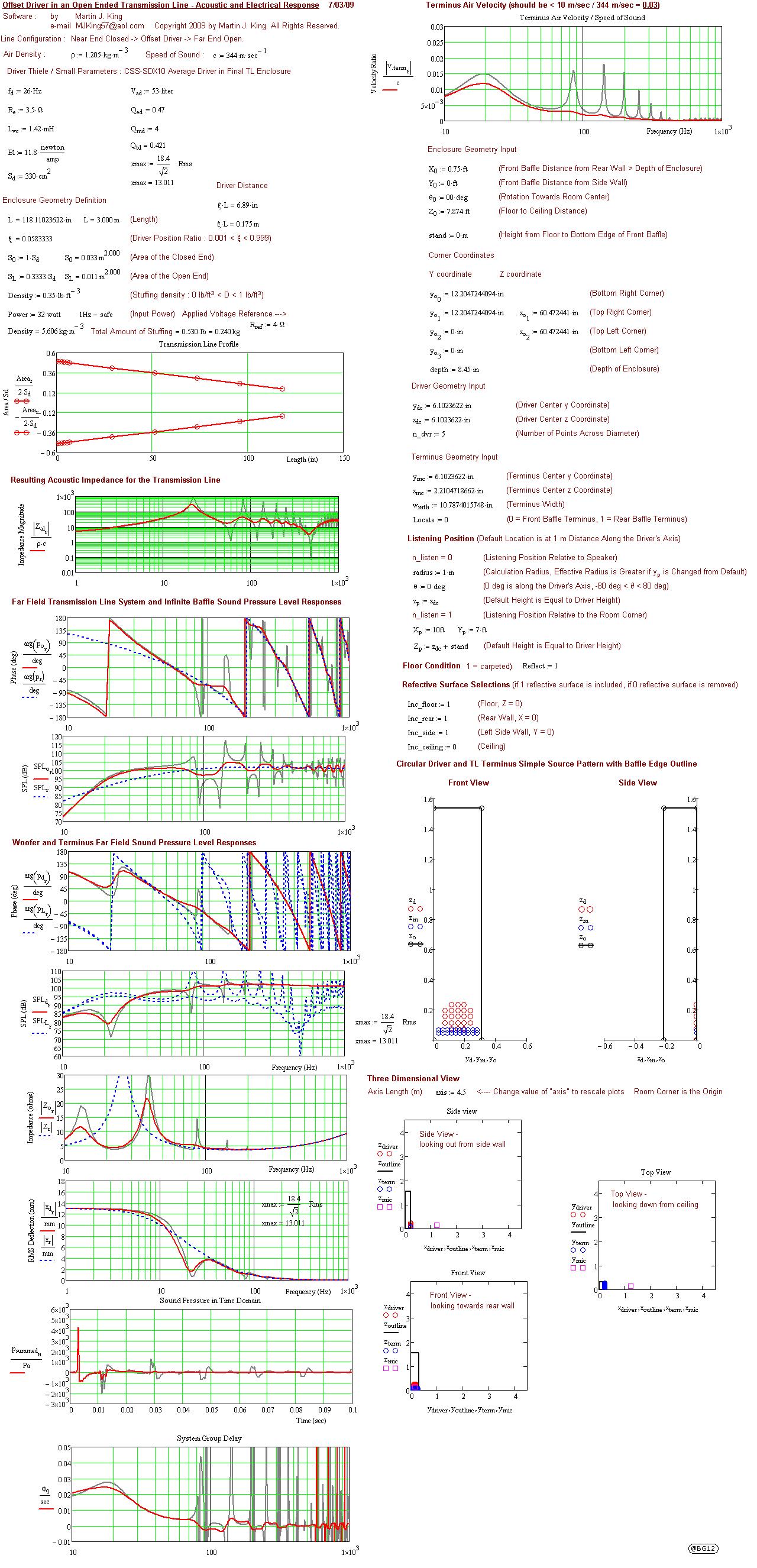

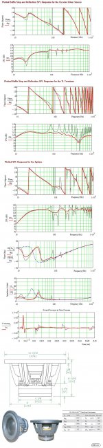

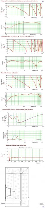

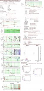

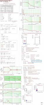

FYI ,A while ago I've made a couple of simulations using the CSS-SDX10 driver in similar size of boxes.. but have no target thread , : joker: I decided post to this one:
b 🙂
Cokewithlime- funny you mention that. I plugged the dayton 10" titanic driver in and it seemed to be a drop in as well. Any experience with these?
Mikey P- yeah I saw that design. it is possible. I just think this driver might look better on paper though.
Bjorno- thanks for posting those. without looking through everything, what were your findings on the design?

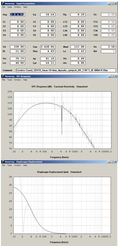

When comparing your subwoofer's excursion ported v. sealed in Hornresp (for sealed just set Ap to zero), you can actually see where the trouble area might be, and why sealing the enclosure made things worse, as the excursion increases substantially in the 20-30Hz region (This is assuming, that we are not dealing with a defective driver.). This would suggest a higher low-cut filter frequency (or high-pass if you like). You might try something like 30-35Hz.
Post #18: "...tried plugging the port and it seemed to make things worse."

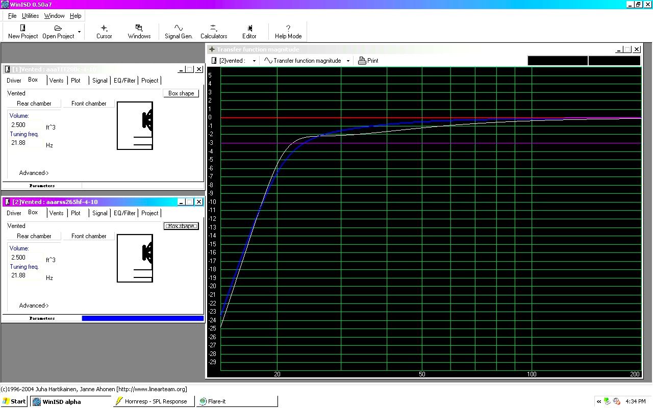

I just modeled the Dayton Titanic and RSS265HF-4 10" and the HF will sound better for more things than the titanic. In 2.5ft^3 the air-spring is too weak between 60-100Hz for subtle sounds using the Titanic, it's just right for the HF.
I should note, if you are using this for just movies and you have a low XO (~60Hz) the titanic will do effects very well. If you also listen to music with this system the HF is better. At F3 both drivers are primarily controlled by the port so Xmax at 25Hz isn't a problem with either driver unless you boost the signal in that range or have the sub set to go above reference (105db/25Hz).

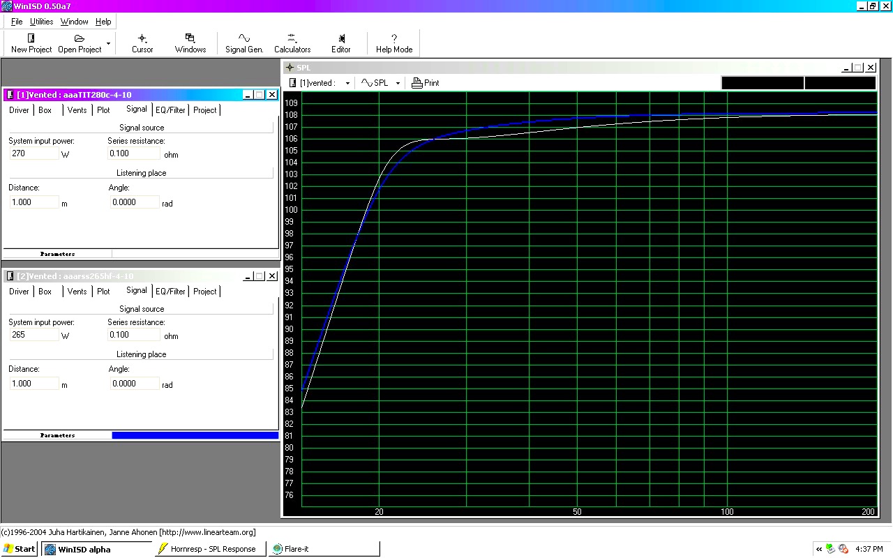

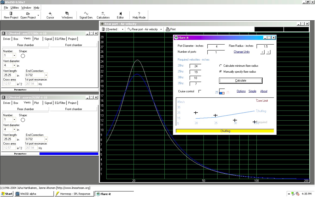

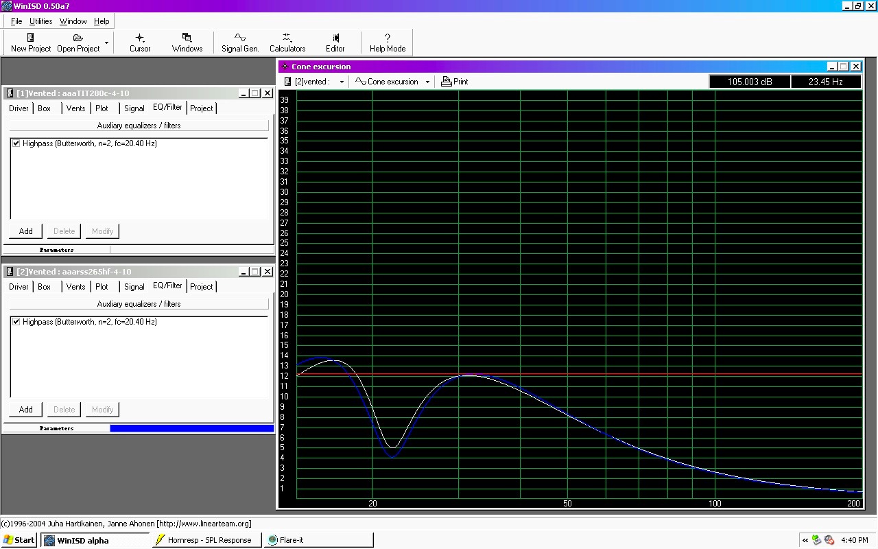

Here's the pics. Notice the little dip in the titanic's transfer function chart, that means the box is too large for HF use, although fine for effects.
The roll off of the HF is basically perfect for a subwoofer.

Nice. The HF does look better according to the sims.
One question though- In the cone excursion graph, should I be concerned that they are both exceeding xmax below 20hz, or am I missing something?
No, not really, the amount that the HF exceeds xmax is very minimal - remember that the xlim of that driver is about 15to20% more that the linear xmax limit.Nice. The HF does look better according to the sims.
For the Titanic it's xmax is around 18mm(one way) but that limit is not represented on the graph that revboden posted
