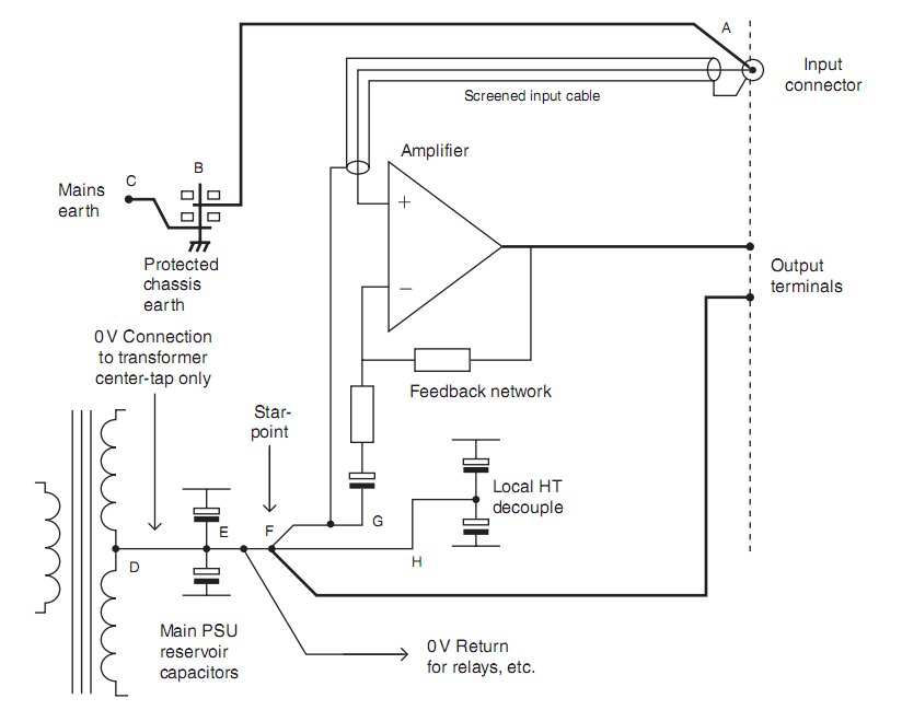

Im talking about safety ground.First of all where does this term come from because ground has nothing to do with your signal reference and all I can think of is that some noise and unwanted signal is introduced into your reference. It has to be alternating else it will not be noise like.
If you are referring to "ground" as in earth or safety ground then yes there is a lot of rubbish conducted in the ground and if your system relies on this ground as its reference it is most likely that there will be a lot of noise.
If you might have seen the Douglas self 6e there is one topic regarding the wiring diagram for the proper grounding there you can see the safety earth is connected to the signal ground. Now dont you think that the noise is induced into the signal ground?
There is no rule to tie your reference point of your amplifier to the safety ground. The safety ground is to protect you, not your signal. Ground noise exists, there are signals running around ground that you cannot imagine ranging from low frequency into RF. Think what a lighting strikes does, there is a potential difference between the strike point and any other areas.

what self speaks is that to connect both safety earth and the reference ground. I have read that using that will reduce the ground loops. I was actually surprised by that in the beginning that how come safety ground is connected to the signal ground but if you see his drawings you will end up in the same doubt..

as per the Douglas self mentioned in his book to attach the safety earth to signal ground so then you will endup having noise in it. So in that case you need a correction or what Douglas self speaks is wrong?
Why?So in that case you need a correction or what Douglas self speaks is wrong
The amp/receiver measures the voltage difference across the input socket terminals.
Attaching a third wire from the isolated chassis to the return of the signal does not change that voltage difference.
BUT !!!!!
there is a Safety concern with the D.Self connection.
The Safety connection from Chassis to the amplifier may in the event of a serious and catastrophic mains circuit failure have to PASS Fault Current from the amplifier to the Protective Earth.
The connection MUST be capable of passing Fault Current approaching and even exceeding a kA and MUST survive long enough for the Mains fuse to rupture and the arc to extinguish.
Can the signal connection to the amplifier and the solder pads on the PCB pass that survivability requirement?
What is the "it" which has noise in?rhythmsandy said:as per the Douglas self mentioned in his book to attach the safety earth to signal ground so then you will endup having noise in it.
OK. Let's use a metaphor.
When you are in a moving elevator, or a moving car, your "ground reference" is moving, but you don't notice, because both your feet, or both sides of your bum sit on the same "ground reference".
The exact same thing happens for, say one printed circuit board with one ground plane which has no (or very little) current flowing through it. All its "GND" nodes are at the same potential. Therefore using it as a reference is OK.
If you look at a copper plane, the only way to have different potentials along its surface is to have currents going through it.
If you connect it to something at one point (like safety earth) then its potential will be that of safety earth, but all the electronics on it will feel just like you feel inside an elevator moving at constant acceleration. As long as everyone uses the same reference, there is no problem.
However, if you connect this "GND" to other bits of gear at TWO points, then a current will flow. Same if you shower it with electromagnetic waves. Then, the potential in your GND will no longer be equal everywhere. Two circuits using GND as reference, but taking it at two different points, will see different references. And you have ground noise.
