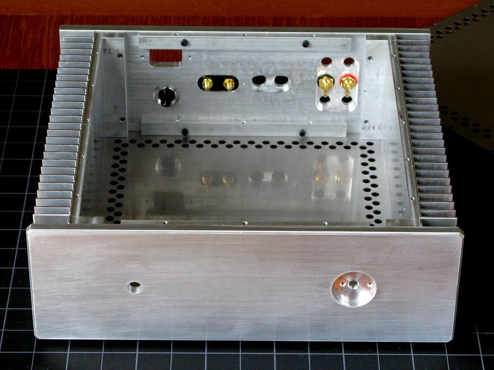

I modify old salvage chassis. Sometime I chop up a few and then reassemble one custom chassis. I typically use brushed aluminum (yes I buy it new) for the front. I can make a chassis for less than $20 like this.
but a front panel is harder to adapt.
You have to make one.

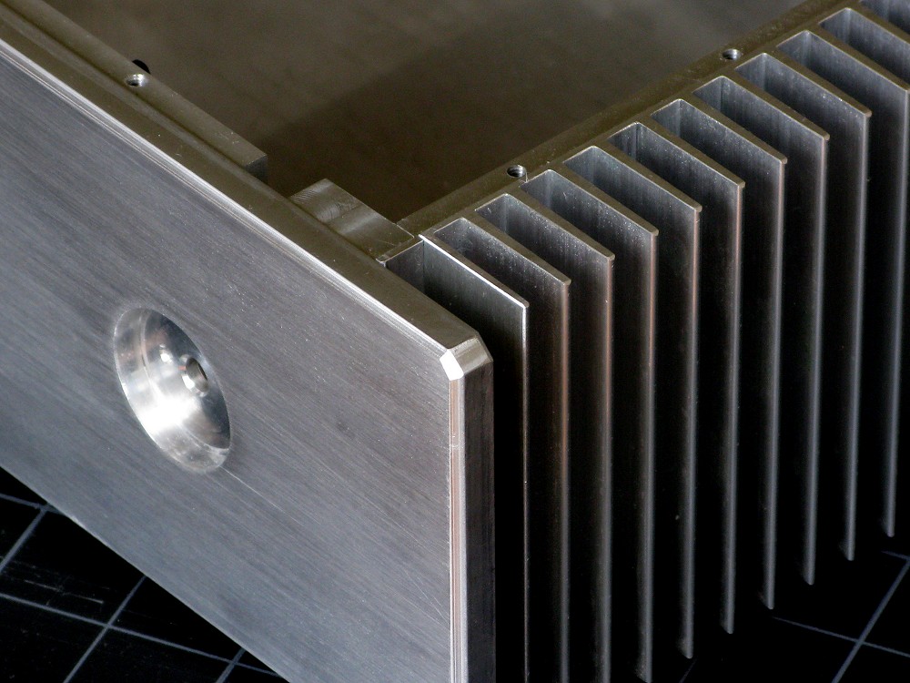

You can use nice stainless steel allen head bolts to attach it, or a two part adhesive like autobody patch panel adhesive. You could probably find a suitable adhesive at a hardware store too. I have seen two part adhesives made to bond metal at my local Do It Best store. I used one a long time ago for an application I don't remember; but I do remember that it worked.
You could also bend the edges and screw it on. But I think that a flat front panel looks best. A brushed piece of aluminum glued to a cheap plastic front panel looks real nice. And if you use an old component chassis (like from a CD player) you can put it in a stack of consumer equipment and it blends right in, but stands out too if you use a brushed aluminum front panel. Satin black ( the usual consumer equipment look) complements brushed aluminum really well.
You can spray paint it too. And don't forget that you can get batches of parts anodized for pretty cheap if you live in an area that has an anodizing service. I have several within a 12 mile radius of my house.
