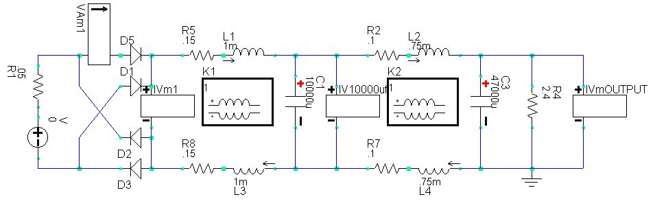

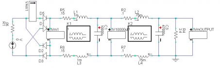

Clarkcr said:Secondly, Due to the unpredicability of the inductor in the power supply, (that is the problem with the LC correct?) would it be reasonable to have an LCRC, where the inductor handles 80% of the voltage drop for the rails and the last 20% can be fine tuned my the resistor? Right now I have a PSU that's running 68.45 volts to the rails with a 500 watt halogen shop light providing the load.
How much current is each of these PSU's going to supply ?
If it is high, you will need only small values of R to drop a few volts to do your fine tuning of V. So why not use a longish length of copper wire to give this resistance and wind it into a coil...🙂
This way you will get an even quieter supply
mike
I would not say that for a given circuit that LC was unpredictable. It's just hard to predict it's predictable behaviour. spice is nice !
If the amp dissipates 500 watts at idle, and the rail is 60+ and 60-, and if the formula for wattage is E X I then, solving for "I" gives me a current of 8.333333 right?
I have SPICE installed but have not been able to run thus far. It won't run because I haven't been able to figure out how to change the polatity of the rail output or change any of the values. I must be retarded.

This seems to be turning into rocket science.....no need for that.
I have made unregulated PSU's with 2mH air core inductors with pretty much anything from average to extreme capacities. CLC with 22,000uF - 2mH - 22,000uF to 100,000uF - 2mH - 100,000uF works well with no bad tendencies.
2mH have been chosen in order to keep the DCR and size down to a reasonable level, actually I have only made one psu with bigger inductors (4mH), which was no improvement. The 2mH figure seems to be what Nelson Pass have ended up using as standard for the Zen projects as well.
I guess that if you use iron core inductors you could get the resistance of the inductor low enough to get in trouble, but surely not with air core. I use 1.9mm wire for my inductors, which leaves you with something like 0.25-0.30 ohm.

Magura said:This seems to be turning into rocket science.....no need for that.
Well, LC... is a bit more involved than CLC. The 1st inductor has to be big enough - for a given current to be drawn - to make sure that the current flowing in the transformer is always on.
This has the advantage the switching transients and FR ringing is not reflected back into the mains supply ( which can mess up the sound of all of your other audio equipment )
Chris - I sympathise on the spice front when I first ran my b2 spice I was totally baffled for a few days. After that things began to fall into place. It was well worth the effort, even though it can't tell you how the amp will sound, it's a great tool for learning what's going on and what changes have what effect etc
good luck
mike
mike
I am aware of the issues regarding LC filters, but so far I have seen little evidence that a LC is better than a CLC, it's just more trouble. Have anybody actually made a test of a LC VS. a CLC?
I made a LC filter some time ago, but could not hear any difference (this was before I got a scope, so it may be measurable, that I can't tell anything about), and decided against LC filters, simply to avoid the trouble.
I agree the theory is correct, but I am still to see one of my PSU's pollute the mains to a degree where the regular mains pollution would not set the "pollution floor".
Besides that a LC filter would require a substantially bigger inductor, which would mean that it would be either very expensive or very high DCR.
Is there something I have gotten basicly wrong here??
