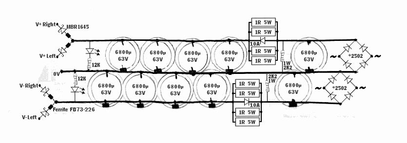

Here's the largest scale example of my chip amplifier power supplies.
It will need transformer secondaries RC snubbers added before it can achieve expected performance.
Of particular relevance are the bypass diodes that almost turn off the CRC filter to provide a bass beat with greater slam.
The "output schottky" and their fb73 bracelets at the left side of the board, are non-vital accessories that actually belong on the edge of the amplifier board (not the power board), they can be omitted if one does well enough with the cabling and they can be omitted for amplifiers that have a regulated front end.
This power supply is an economy/compact build. I think that the performance is quite good despite the low cost.

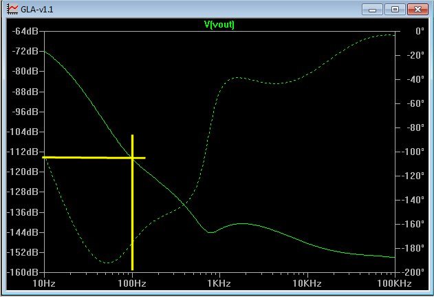

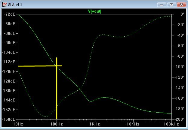

(Attachment 1) is the native PSRR of my GLA amp (Sansui Z3900). Not too bad..
(Attachment 2) is the simulated PSRR at a low power level where no current is being passed through D105-D108

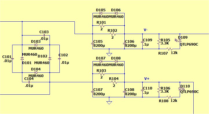

(CRC with diodes schematic - Attachment 3)

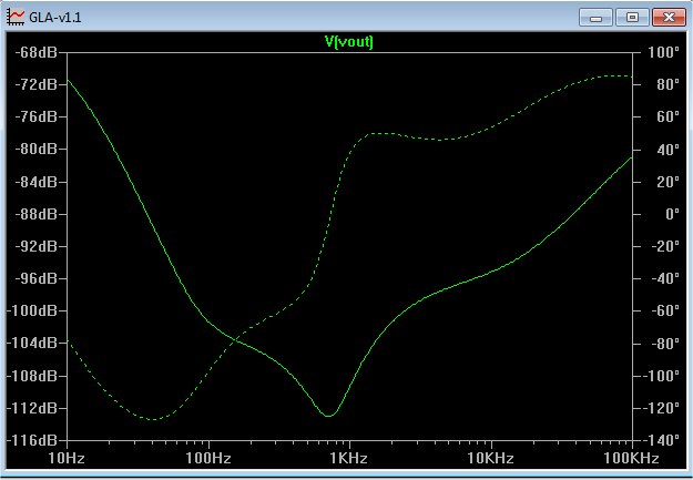

Either at higher power levels or with the resistors removed (attachment 4),
the improvement in PSRR remains almost the same . 😕
At low power levels , the power supply has more voltage and just a few
more DB's of ripple rejection at lower frequencies.

MUR820, Fast silicon, about 0.5v
10A1, Standard silicon, about 0.7v
P.S.
Fascinatingly, with any of those diodes, the CRC filter still works. So for my own use, I've changed my "CRC Bypass Diodes" (shown in post#37) to MBR rectifier schottky, 0.3v. This smaller voltage also decreased the price and size of the resistors.
