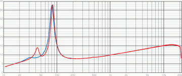

I have 2 methods of designing an aperiodic box....
1/ for a high Q driver (that would probably prefer to be on an OB -- build a box as big as you can live with and then add some holes as far away from the driver as you can. Then damp the holes (i have done this by ear in the past, but the last one i did was pre impedance measuring kit)
2/ for a lower Q driver, i model a BR box with a specific shape curve (ie by feel), then make the ports with a high aspect ratio to push the box towards aperiodic. If that isn't enuff then i use fairly stiff packing foam to block the port (i end up with lots of it lying around (a specific foam from Apple Service parts boxes works well))).
Attached is the measured imp with & without the port damping... you can see the bottom hump disappearing (and is already pretty small -- indicating some aperiodicity without).
This technique worked really well for the FE127 (the Fonken) and we have an untried design for an FE167 (the Mama Fonken) and will also try the 207 (Papa Fonken) & Neophone (NeoFon-ken)

According to my experience, the Z-plot you've attached is not exactly an aperiodic alignment. I've built several speakers with both Variovent (Scan-speak) and my own aperiodic damping. All of them had a single impedance peak at almost the same F as a closed box, but with lower Q. Your plot looks more like heawily damped TL or BLH. I'm not saying it can not be done this way - just that it's not the same as you'll get with Variovent. Also, in my experience, the closer to the driver you put the damping device - the more efficiently it works.
I use WinISD (Pro Alpha) to simulate aperiodic box. You should model a closed box, then click on "advanced" button in "Box" tab. It'll show the Qb (Q of the box). Default value is 10. For a well-made box of 30-40 liters that's about right. Smaller boxes will have higher Qb in real life. Then, I change Qb to about 3. Resulting plots will give you a good estimate of an aperiodic box. However, this approximation is not as close to the real thing as other "standard" models in WinISD.

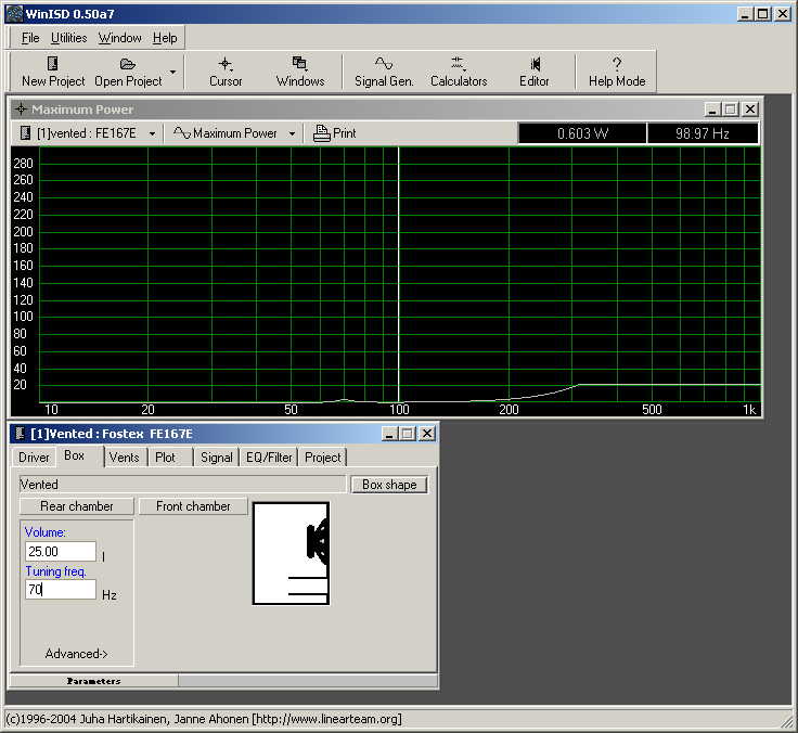

I'd like to thank all, who replied. But, my concern is actually a different question.
New version of WinISD (Pro Alpha) has this very useful plot, called "Max Power". It shows "Power, required to reach Xmax vs. Frequency". I've tried the BR boxes suggested by Fostex and by Zilla. Basically, the results are the same - all these should bottom out the suspension at something like 0.5W at 100 Hz and below.
My question is - have any of you, who have FE167 (or any of the FE series for this matter) in BR or closed boxes, experienced this bottoming of the cone? How do you get around this problem? Do you limit your power to 1/2 W, do you carefully choose what kind of music to play over these speakers, or is WinISD wrong by a big margin? So far I have quite a bit of respect for this program. I've got very good match between it's models and actually built speakers.

Keep in mind that the WinISD sim represents continuous power at a fixed (low) frequency. Music typically does not do this.
Mine seem to take about 4W of soft rock before they start to color the sound. However, some bass intensive music can sound ugly with as little as 1W. So it is music dependent.
If you limit the bass to these drivers, you can get some serious SPL.
