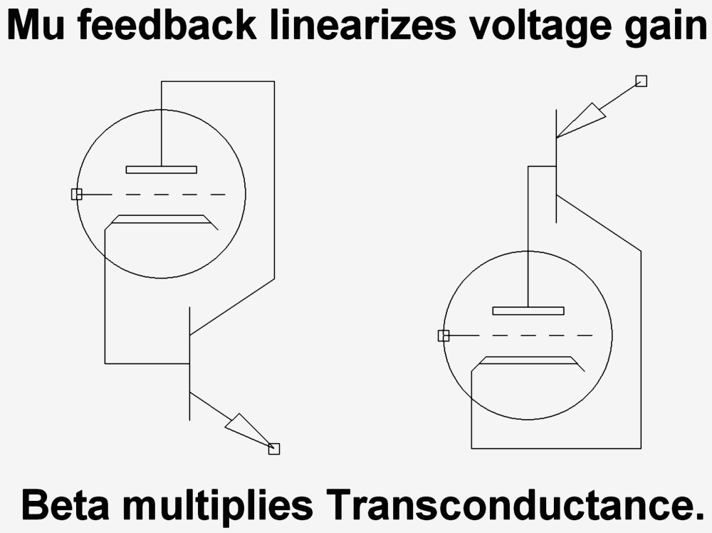

150mA is more than plenty. Especially when in Darlington...
Only the SIT/V-FET/Triode need have a real Mu. Ordinary
BJT inherits this property when so controlled.
The anode of the Triode or V-FET device has a low impedance.
This node acts as INPUT for voltage feedback as well as output.
Can be abused to moderate VCE of a bipolar that passes much
larger currents.

Gordy said:No feedback
If that were a triode I would use it open loop
No feedback is an absurdity. Mu is essentially a local feedback.
So too are all unity gain followers, the greatest feedback of all...
What really makes Mu and unity followers special, lack of delay
feedback shifted by external time constants...
The feedback happens right there in the channel in real time.

Gordy, review the papers of O.H.Schade again if you have not done
so recently. To realize WHY a triode behaves linearly as it does.
Yes, his most famous paper is not about triodes, but about the 6L6
Beam Power Tube. But actual behaviors of the space charge within
the envelope of every tube are greatly clarified, and these physics
directly relevant to Triodes.
There is a feedback. The gradient of electron density in the space
charge is an unseen extra screen where distributed local feedback
naturally occurs within a Triode. (Gradient of carriers in the channel
of a V-FET or SIT, same same....)
I'm not sure if we are in any actual disagreement regarding these
facts? Or merely choosing incompatible words to describe similar
ideas???
