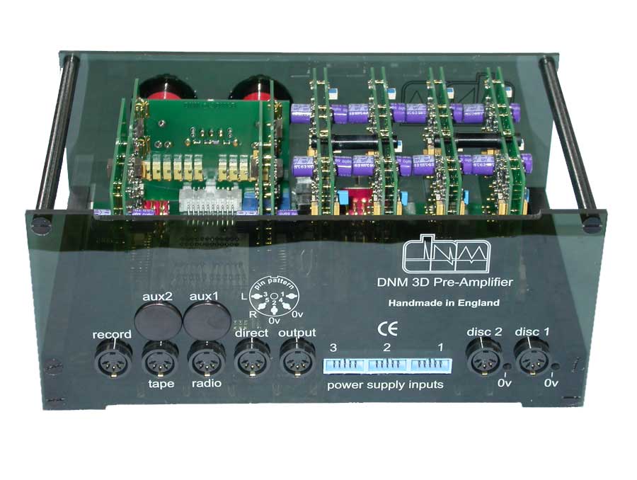

Like DMN?
Yeah, again, there's nothing wrong with plastic, it just has to be the RIGHT plastic. "Plastic" encompasses materials spanning an enormous range of melting points, stiffness, flammability, conductivity... The proposed source (cutting boards) is just a lousy choice for any device that will have significant heat.

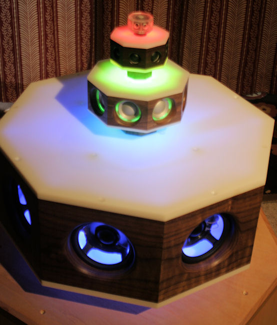

I like the "saw dust" that it creates--it is so fluffy you could almost make a pillow from it. The second picture shows a speaker using quite a bit of HDPE. These speakers were called the "Marthas" because the first round of HDPE used Martha Stewart cutting boards. The packaging at Kmart even had www.bluelight.com on it, so the illumination concept kinda grew from that...
