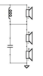

If ONE 8 ohm woofer is used with ONE 8 ohm fullrange with only an inductor as low pass on woofer, will that not present an 8 ohm load to the amplifier and be considered a first order 2 way system? I simply want to add a 2nd 8 ohm woofer as a helper woofer with another inductor at a lower frequency (100hz) to create a 3 way first order system with an 8 ohm load to amplifier? I don't think it is about wiring in series or parallel but dividing the signal from the amplifier 3 ways like a branch of a tree: lst branch is through inductor 1 to woofer 1; 2nd branch goes through inductor 2 to woofer 2 and 3rd branch goes directly to fullrange driver. Why will this not work?

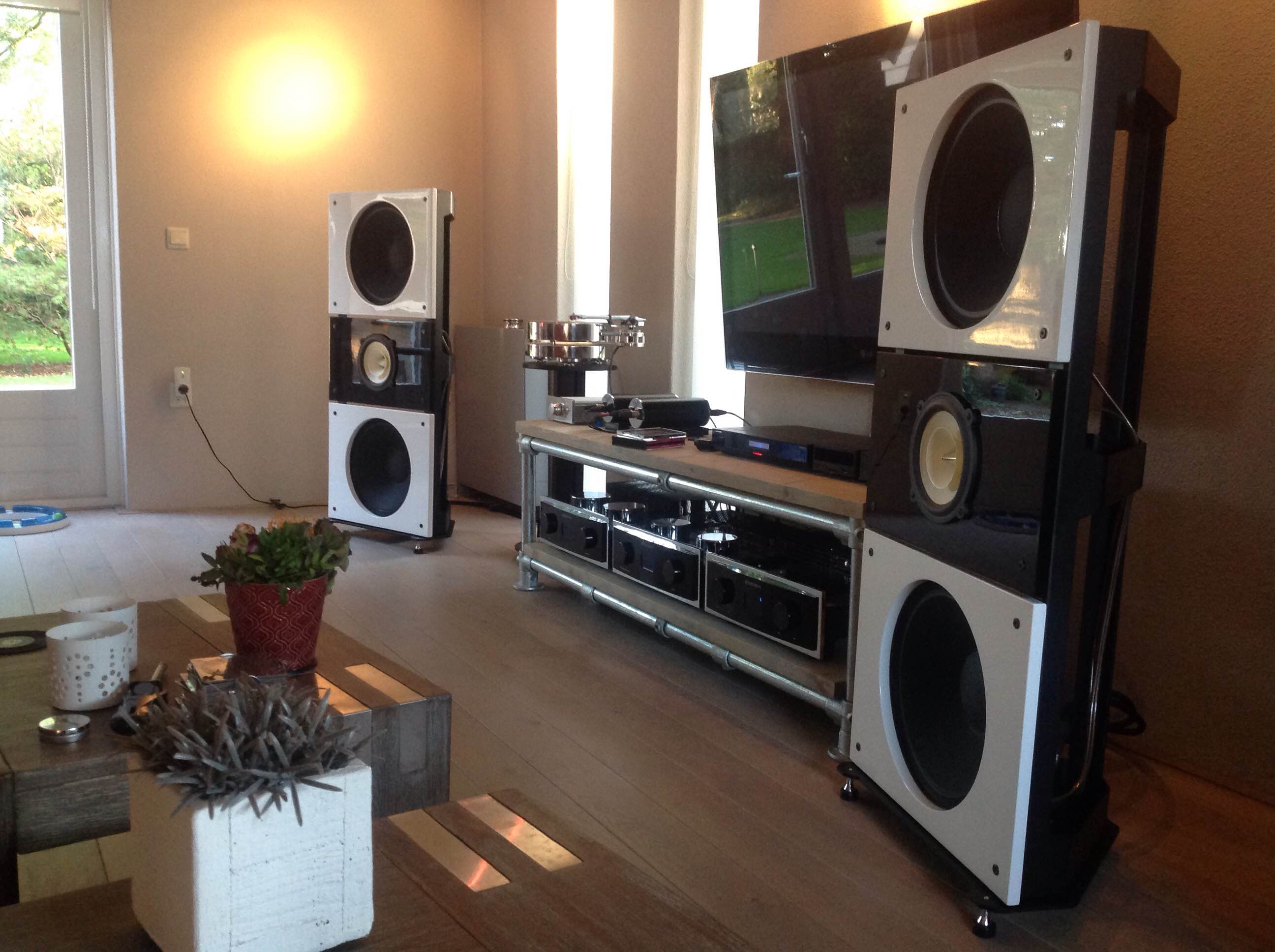

Ok guys. I will look elsewhere as Pure Audio Project Trio series seems to have done what I am trying to do with 2 large woofers, 1 full range driver and a 2 way first order crossover yielding exceptional results! I will give up on the 3 way and focus on the 2 way design that they use. Thanks for everyone's input.
Can you post a link to the one you're thinking of?Pure Audio Project Trio
models are supplied with our unique Leonidas Crossover. The Leonidas Crossover is a series topology two way first order crossover
Q: How does Leonidas Crossover work ?
A: Differently from typical two way crossover topology, Leonidas Crossover connects the drivers in serial, allowing them to perform independently in their main frequency range (woofers at the lows and FR at the mid and highs), while playing together and in a perfect phase in the so-called ‘cross range’. That range and the SPL balancing between the drivers are defined by the values of the components. The coil dominants mainly the woofers, the capacitor dominants mainly the FR (or tweeter) and the resistors are responsible mainly on the SPL balance between the two…

I would call that a 'quarter section, series' circuit.
Component values for 12 ohm (the average of your 8 ohm full range and 16 ohm series woofers) would be around 6mH and 28uF at a crossover frequency of 400Hz.

Impedance seen by amp would be no less than 8 ohm in your case.

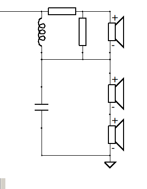

If you were to use two 4 ohm woofers in series then we would be designing for an overall 8 ohm system.
In that case, for 400Hz, C = 56uF and L = 3mH approximately.
The values of the resistors could be used to manipulate the full-range into looking higher than 8 ohms.
The woofers should be chosen with thought to their sensitivity.
