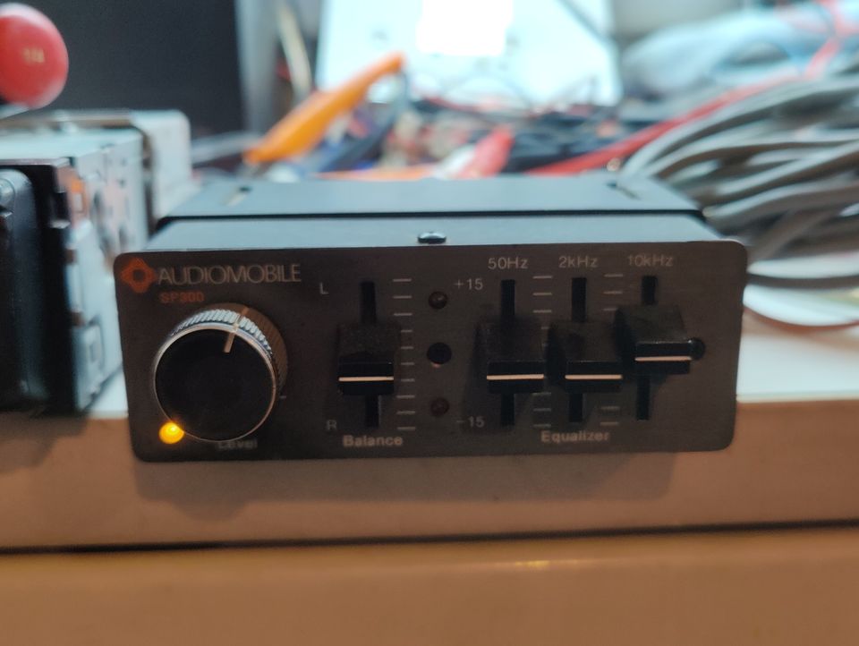

I been really sick/sore and have been in the bed. I managed to come around a week ago so here I am again. I repaired to FULLY OPERATING (2) SP-300 AUDIOMOBILE EQ systems. I own three. The THIRD one needs a EQ section go over. I need to either FIND another EQ for parts OR rip the EQ slider section apart and inspect them sliders. I have found the metal connectors can become loose from plastic degradation. I reinstalled one slider repaierd with SUPER GLUE and thus far the balance control is back to WORKING. I wont mess with it.... Balance control in the days of ONE MONO CHANNEL radios in peoples dashboards..... The SP-300 is a 1975 construct. 30 volt operation with true 5 volt PREAMP OUTPUT.... Only thing that was better was the Venerable Zapco EQ slab that was so huge and such that mounting it in the cabin areas proved somewhat prohibitive. WELL...... I will be ripping apart them SLIDERS... see what I can see and fix and HOPE it too comes back to life. At this point the BASS slider seems to operate, ONE of the MID sliders channels worked and NO HIGHS slider signal at all so.... Looking like them two sliders will be seeing the light of day soon. Still messing around with wayyyyyyyy old gear.... because I CAN. Aloha! BDBD/2023

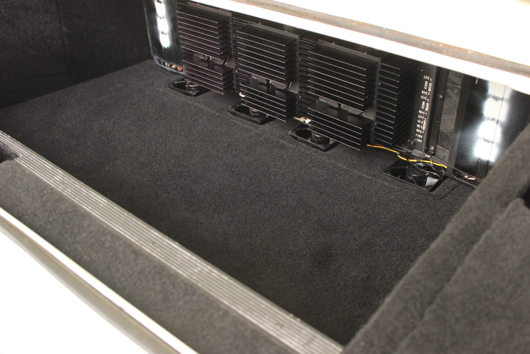

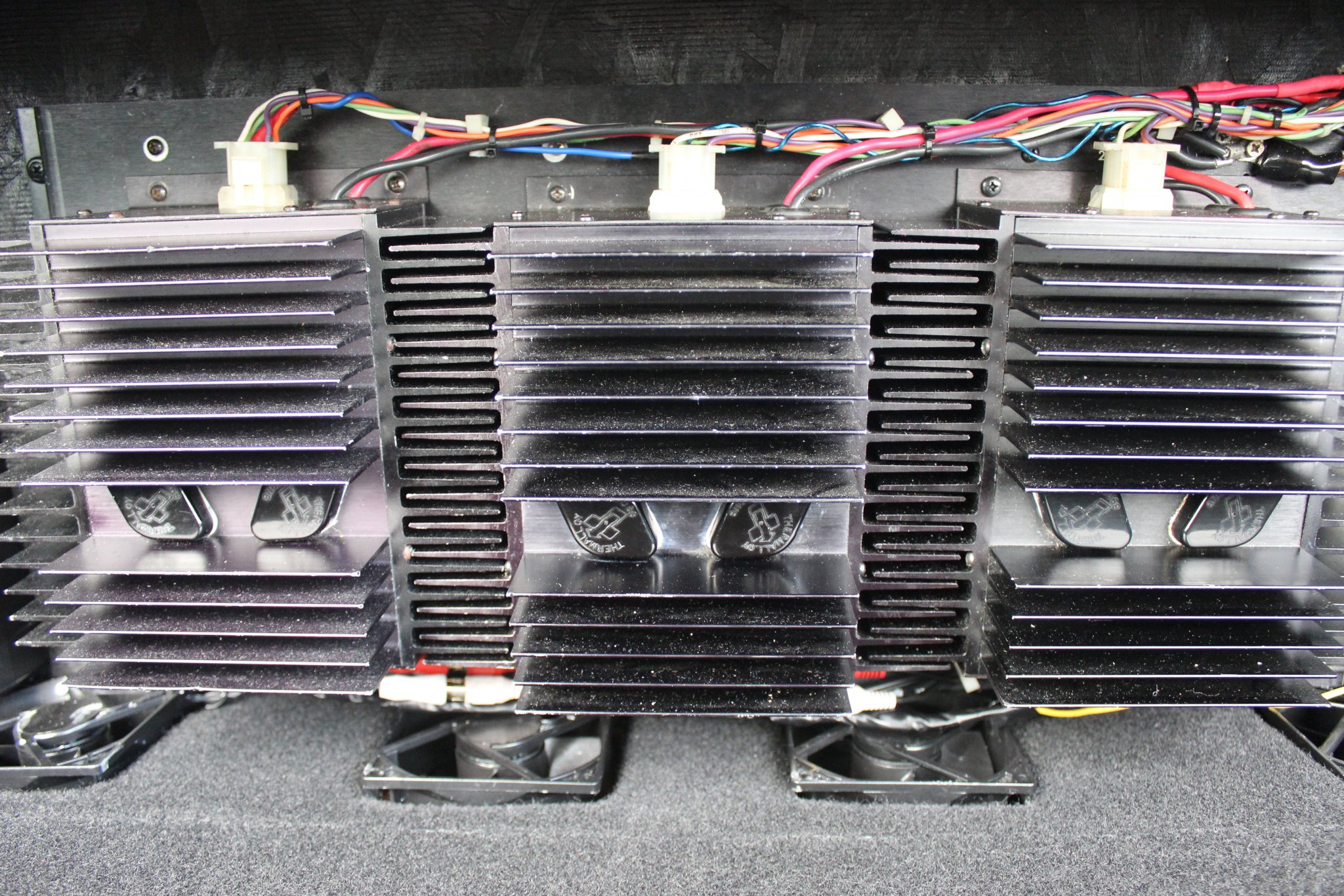

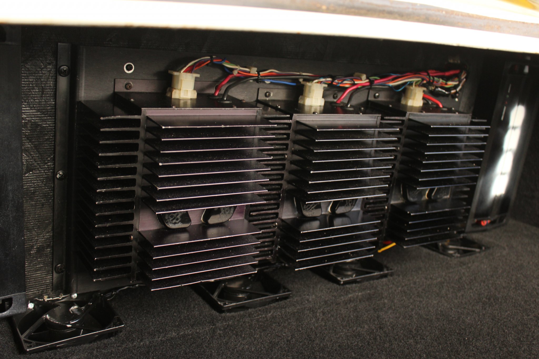

in the trunk of my 67 Firebird... The SP-300 fits perfectly into the ashtray area of any GM car of them times and THATS why the AM SP-300 was so popular.... ya could HIDE it. BEST 3 band EQ ever constructed for an automobile environment?... the SP-300 by AUDIOMOBILE. 3 SA-1000's power my HIGHS/MIDS and I have 2 700 watt Class D amps of modern origin to power the 2 10 inch bass speakers in the cabinet all built in by yours truly. My Firebird has been the recipiant of MANY soundsystems starting in 1981. STILL messing with it in 2023 and no end in sight. I intend to install 3 ADS 2001 160 watt amplifiers into my Firebird eventually. I actually got them all to WORK so.... SOON, OUT with these AUDIOMOBILE AMPS.... and in with them ADS creations... OLDEST SCHOOL kiddies.... Hoo Hah! BDBD/2023
