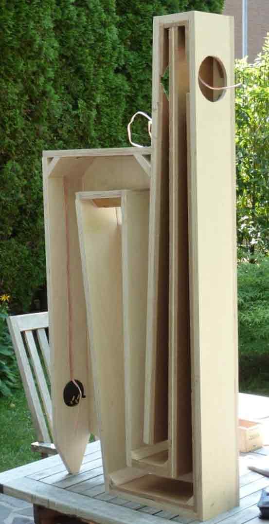

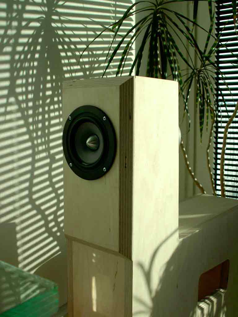

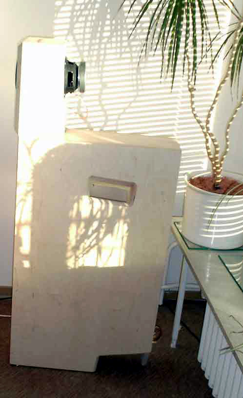

Hello,
take a look on my double horns,
the Kornett would be one of my bipolar
solutions.
The TB 4" 1320 is one of the best 4"
with phase plug and much more stroke
as any Fostex.

That Kornet is interesting, HM. Only BLH bipole I've seen but I'm sure there are others. About how far from the back wall is the front of the speaker?
